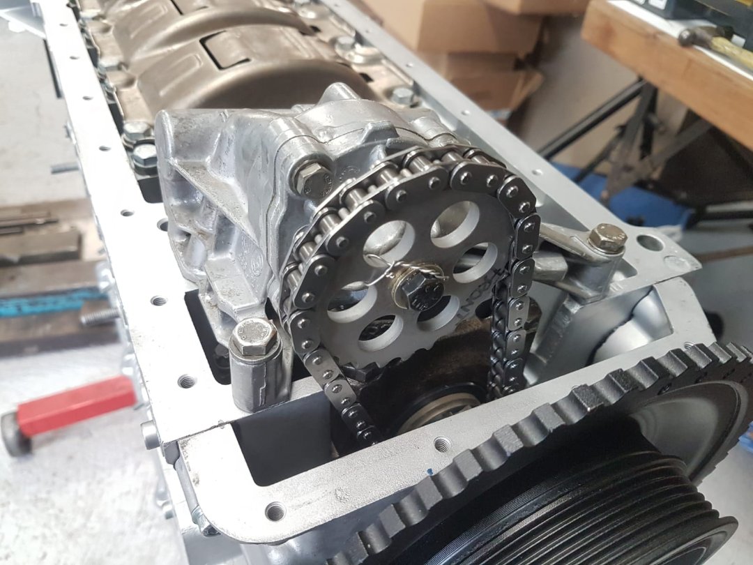

well it's been two full car seasons and i'm nearly into car season number 3 since my oil pump harmonic balancing failure ....... time to stop the rot and push things on .

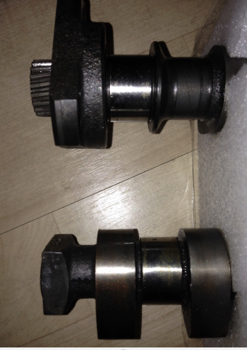

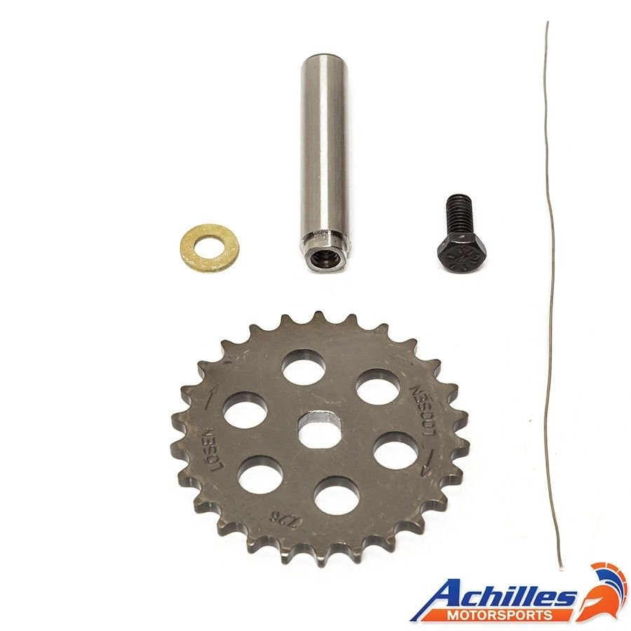

as previously posted i've bought a a bionic drift spec oil pump shaft kit , hardened shaft and left hand thread , also sent a used set of injectors of to injectortune and had them all cleaned up ready to go in .

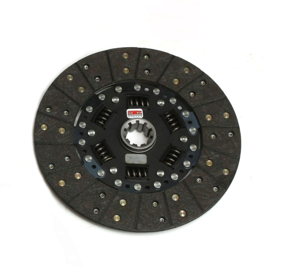

well to add to that i've decided to use the e36 m3 solid lightened flywheel weighing in at 5.4kgs and a sprung stage 1 e36 m3 clutch disc along with s50 clutch cover , the e30 m20 set up has been hit and miss and with the helix cover it's like a fookin stage 10 rally car spec so i'm going for sumit a bit smooother 8) .

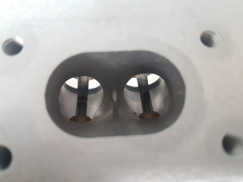

the stroker donk was sent off down to Danthe's yesterday 15/2/2019 for him to do the fettling i;e pull apart and check everything, have the head fully overhauled , acid dipped block etc and fit the dbilas cams i bought ages ago .
i really want this engine to run like a swiss watch and Dan is the man for the job , looking forward to this year already :D

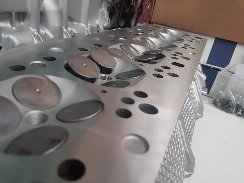

some sexy pics arrived on my phone today :D

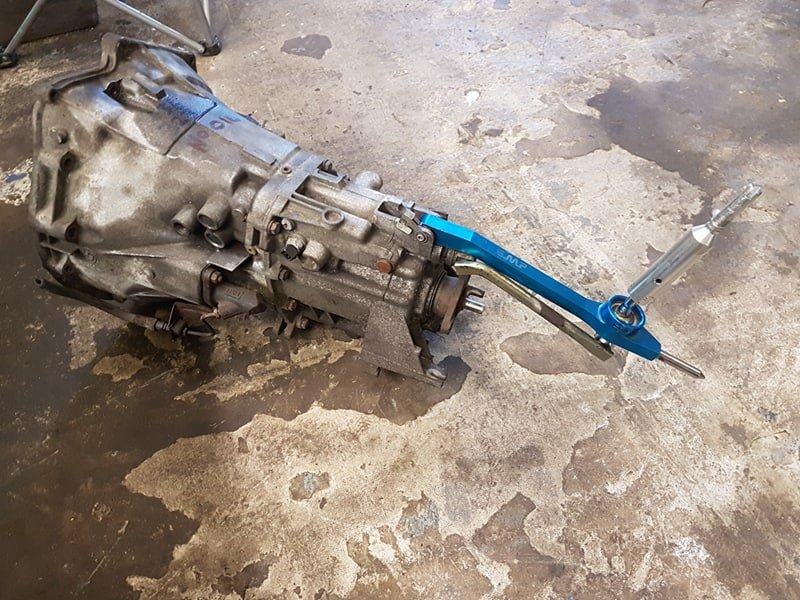

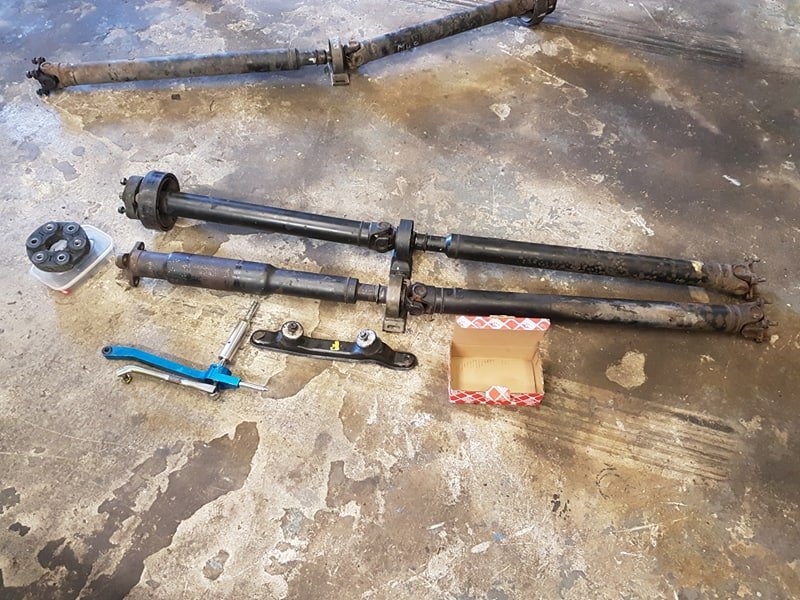

fitted a new centre bearing to the e36 328i prop i need to run a zf 5 speed [ had enough of the rattles from the 6 speed box on tick over ] , along with the prop i had to get new gear selectors so i was lucky to get both items from the same seller both parts just removed from 328i with the zf box .
test fitted the selectors on an e36 323i getrag box just see how short or notchy it is .
next is to liberate a good zf box from an e39 528i i have up the boneyard that seems nice and quiet .

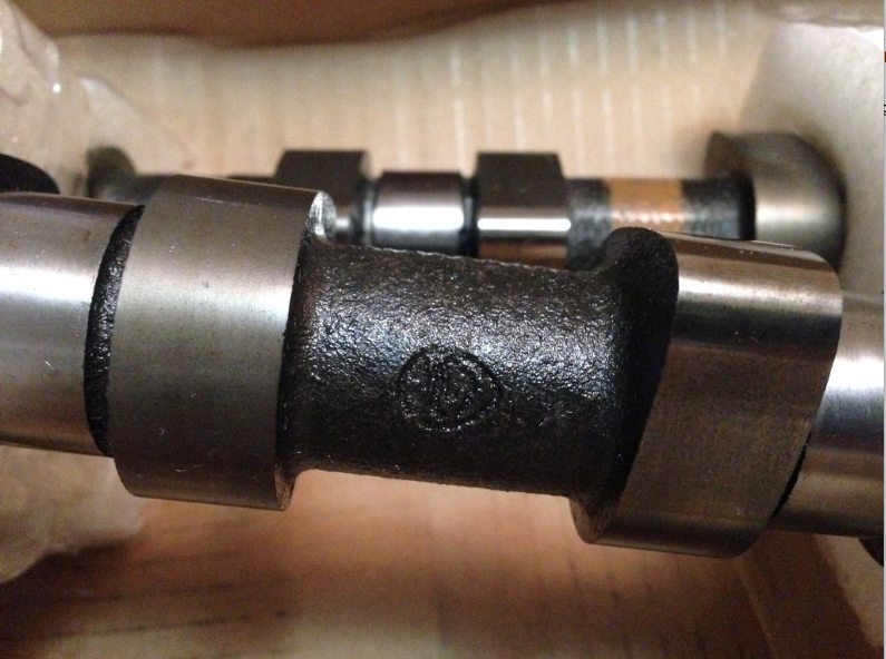

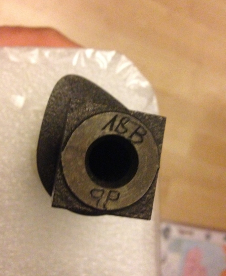

i bought these dbilas cams a long time ago just after the oil pump failure ,
really good to see them finally fitted

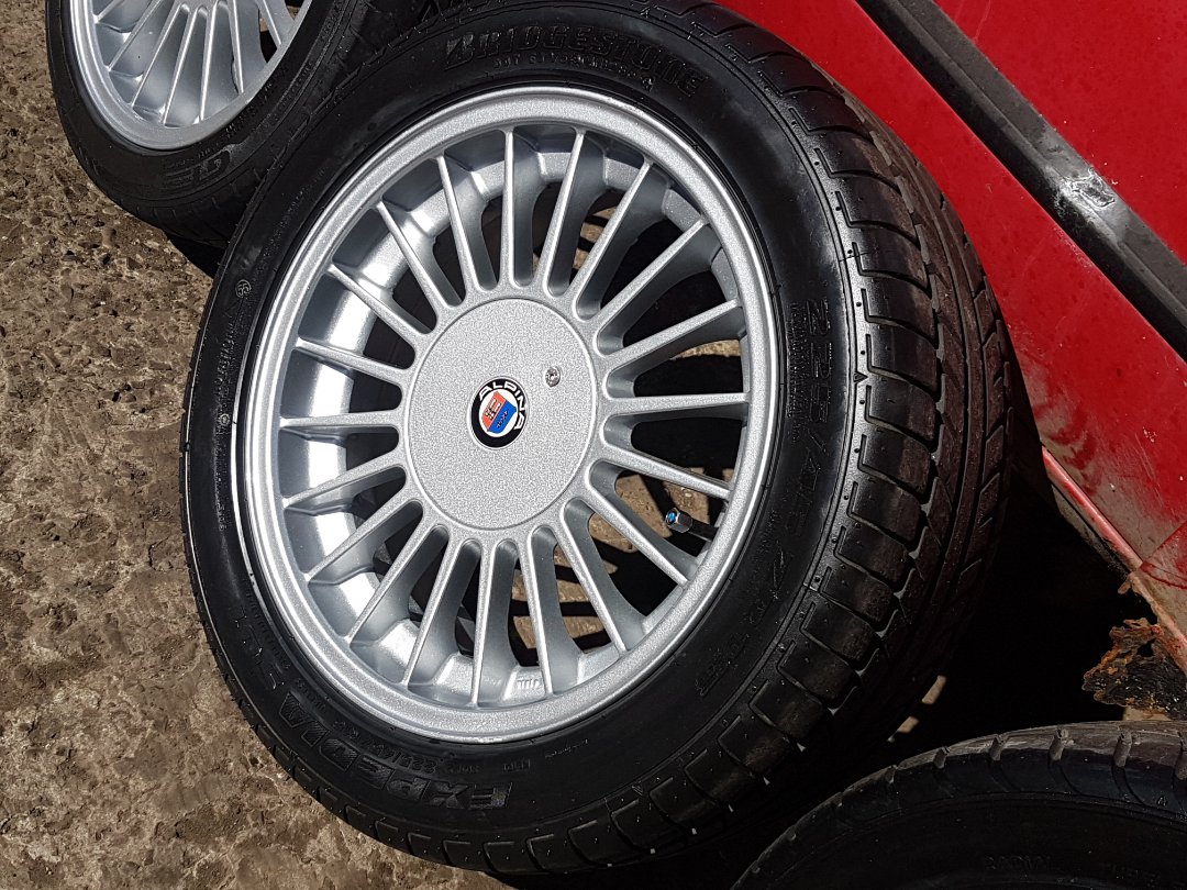

Picked up my RG Alpenis reps today after having a double coat of ceramic coating . The brake dust should just fall off now with soapy water. Keeping them clean was a royal pita so I hope this stuff works or i just spunked £100 on promises and lies 🙈
Also dropped the prop off to be balanced up as it from two different cars £62 inc vat .

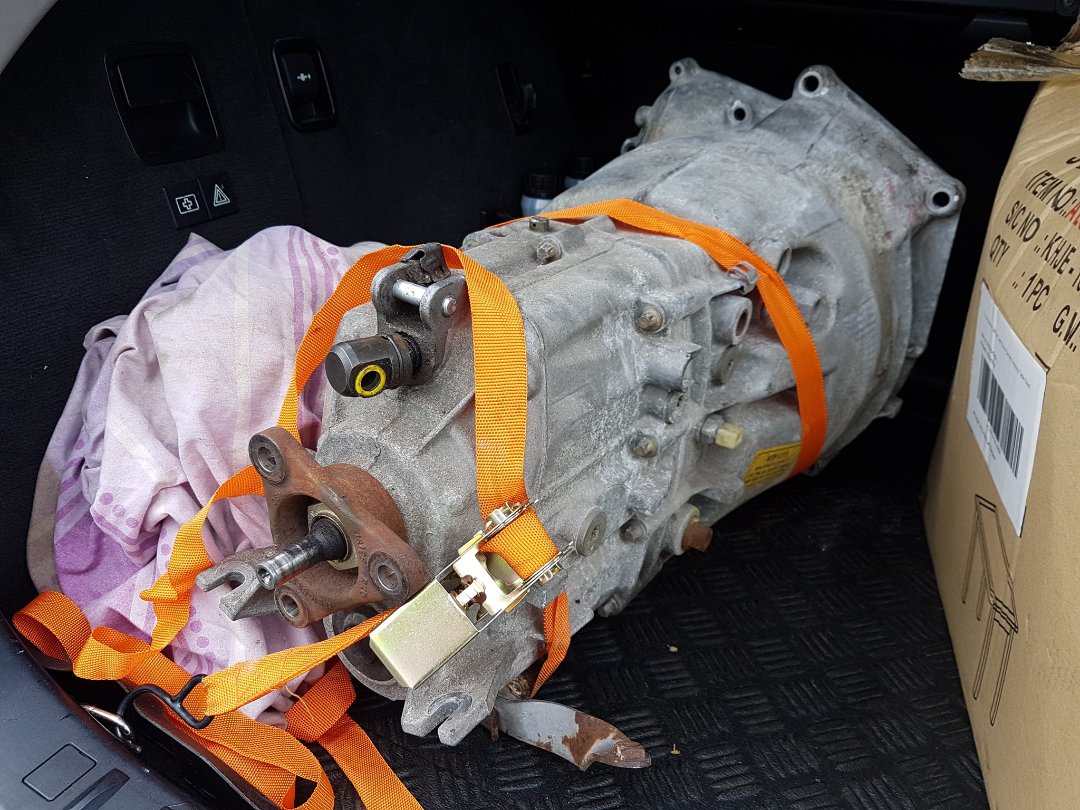

had 6 hr rd trip down to Andyboy's workshop to collect a genuine 37k zf box from a 1999 z3 2.8 .
very happy with that purchase .

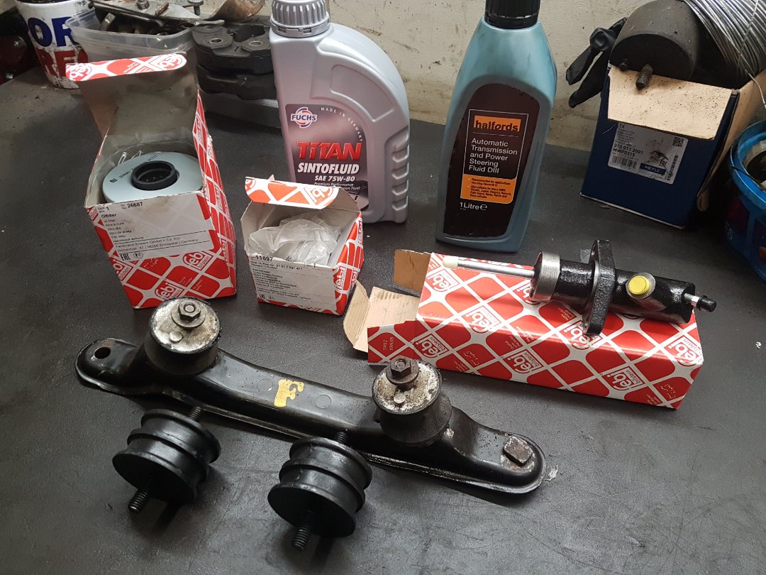

all the small things i'm having to buy changing to 5 speed are adding up . new slave cylinder,clutch release bearing,oil filter, fluids and some landrover defender gearbox mounts that i thought i'd try . these are solid rubber so should be ok with the oem engine mounts . If not i'll swap them out for e36 oem ones .

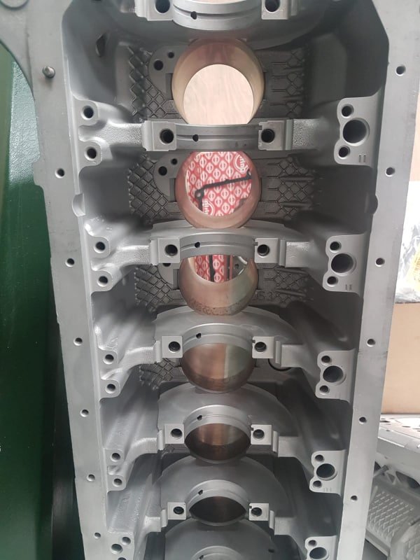

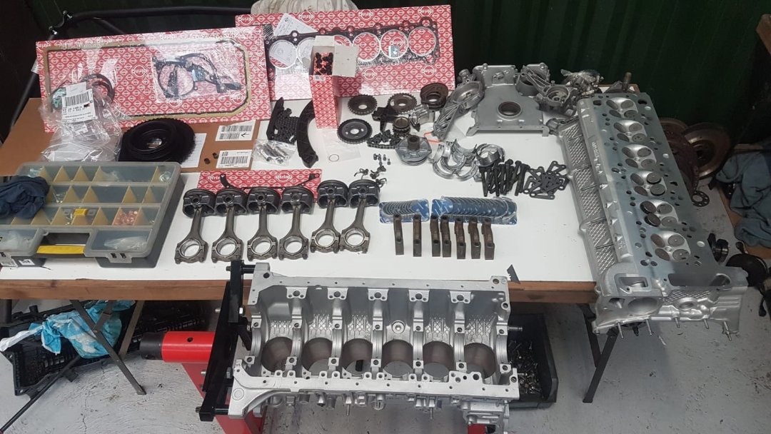

But on a positive note some more pics from Dan and my block is on the engine stand . 😁

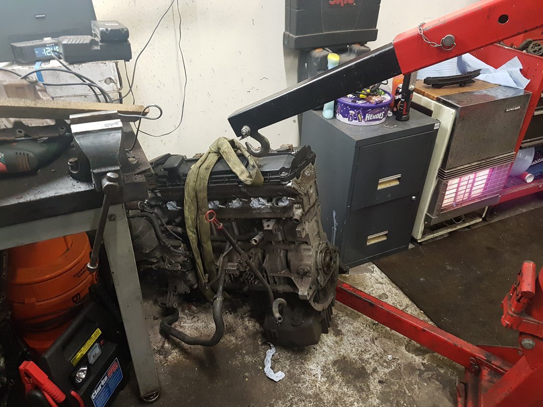

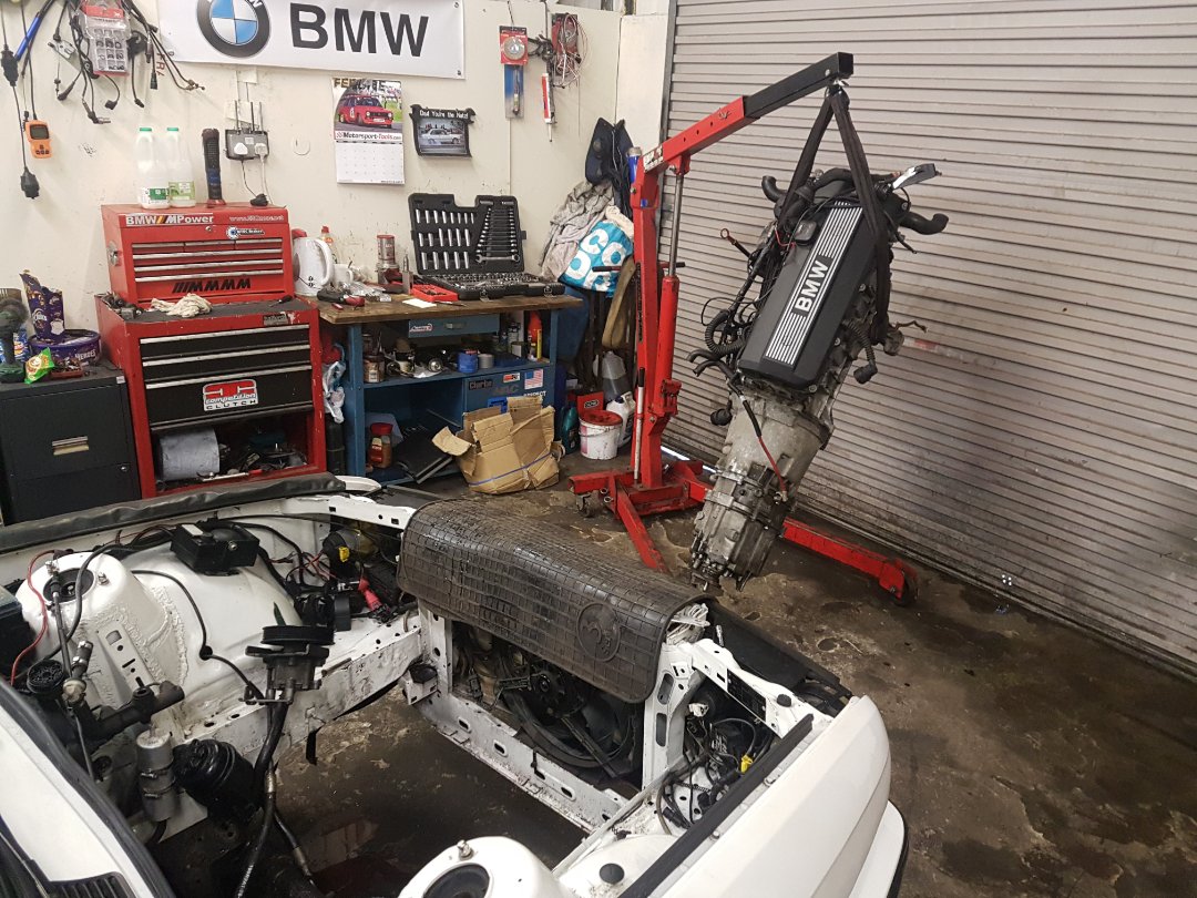

Got the m52 b28 stop gap removed along with the 6 speed box , just need to strip the b28 for its conversion parts read to refit on the b30 when it arrives

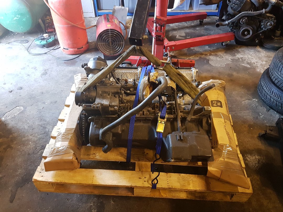

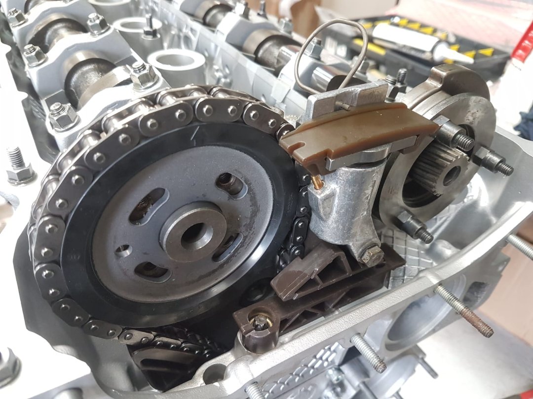

i'll have have the engine back next week, it's being collected on Monday .
these are the last pics Dan sent :D
i think i have everything ready to go apart from new exhaust studs that will be ordered on Monday as Cotswolds payment system was down today .

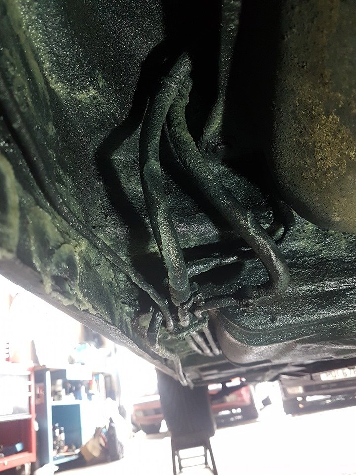

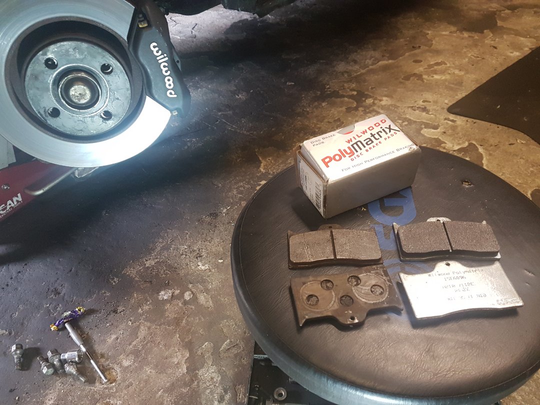

the engine arrived on weds morning so while i was waiting for a few days i had a good check round the car and found the rear pads badly worn so ordered new ones and got some for the front brakes as they were looking low . apart from that i decided to re underseal and waxoil the undercarriage while the engine was out .... so with no further ado i set about it late last week washing the muck/dry dust off ready for underseal .
Fri Jun 28, 2019 9:15 pm
right with the undersides out of the way the rear brake pads arrived today so i fitted them ,

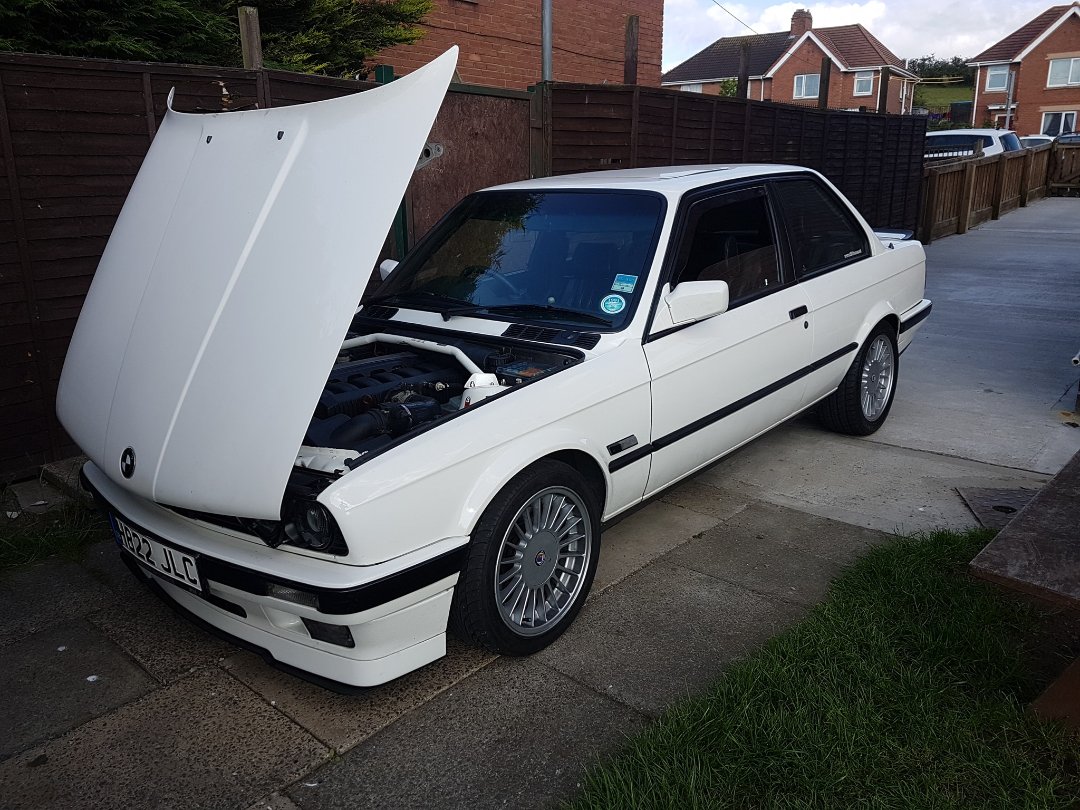

Tue Jul 02, 2019 6:27 pm

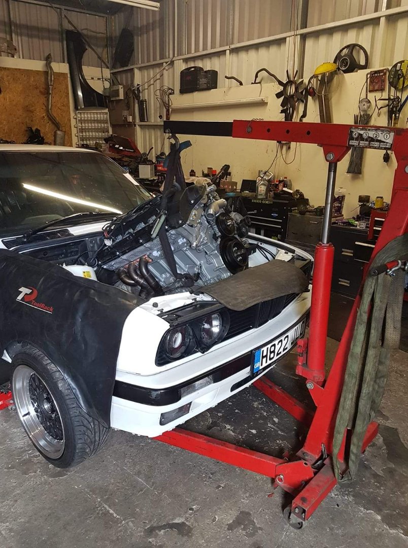

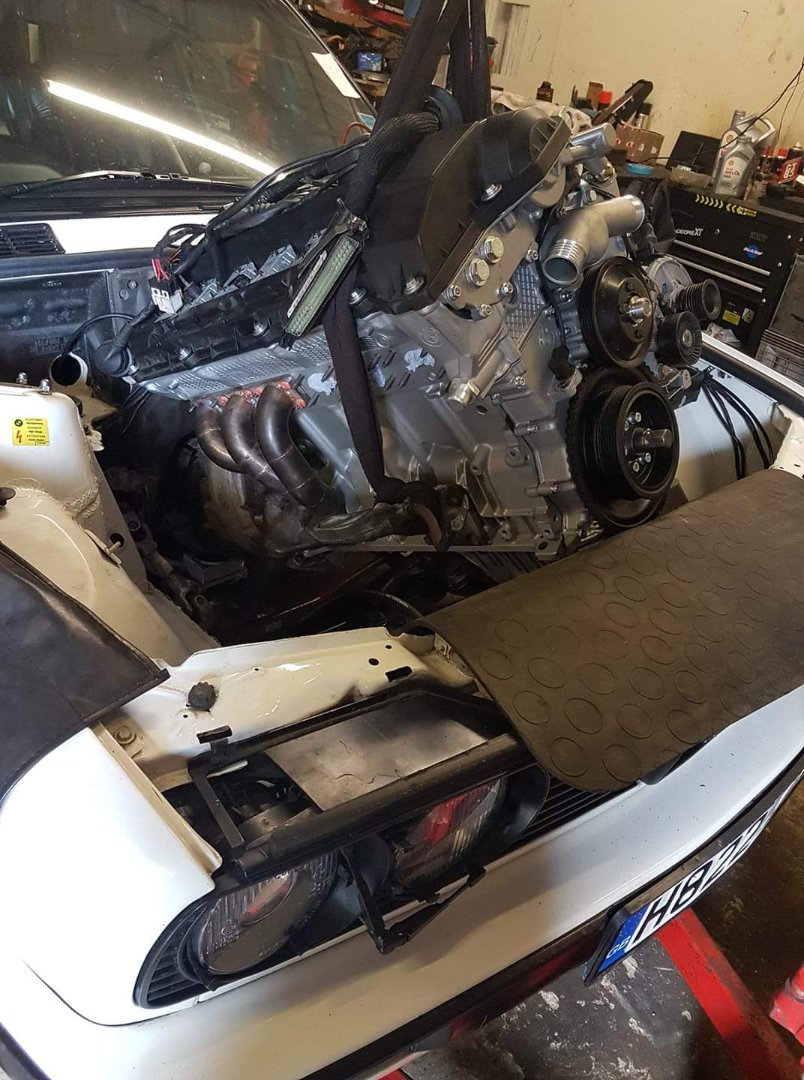

wey it's now in the bay and on it's mounts with the zaust manifolds on and fitted the front brake pads, i hope to have it all back together tomorrow . got an email yesterday saying my mot's ran out ffs lol :roll:

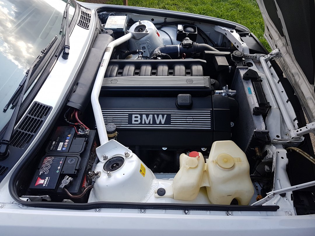

Thu Jul 11, 2019 7:12 pm
it's Mot'd now and i've put 60 trouble free miles on , so far so good 😁
