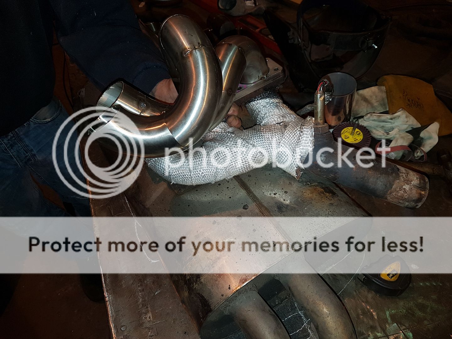

been a few hold ups but work has started :D
missing the turd a bit now like :sleep: > :snigger:

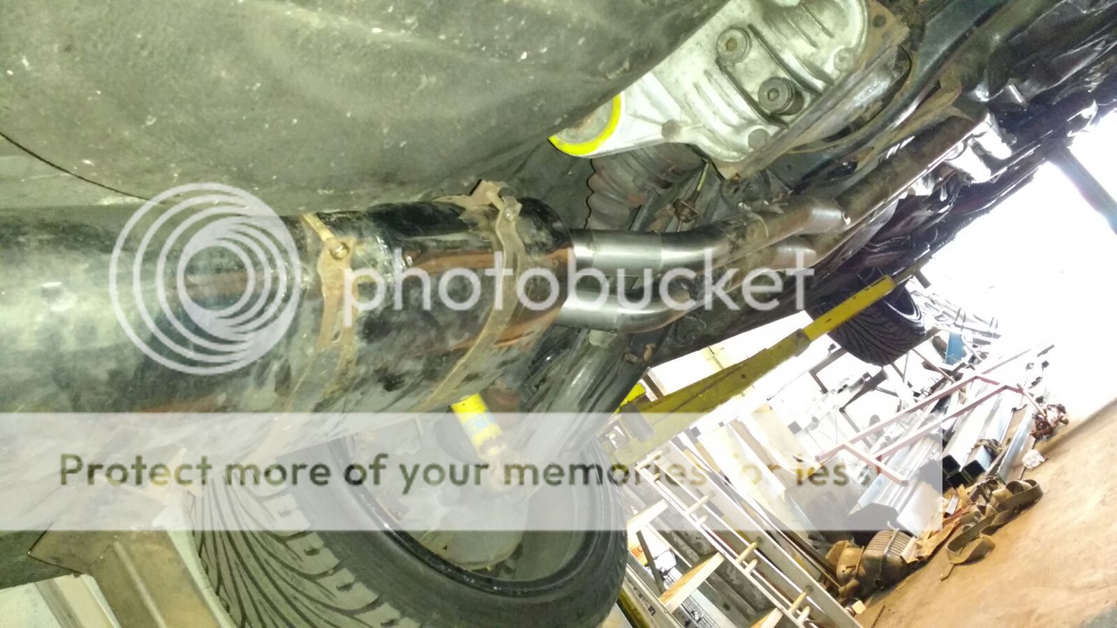

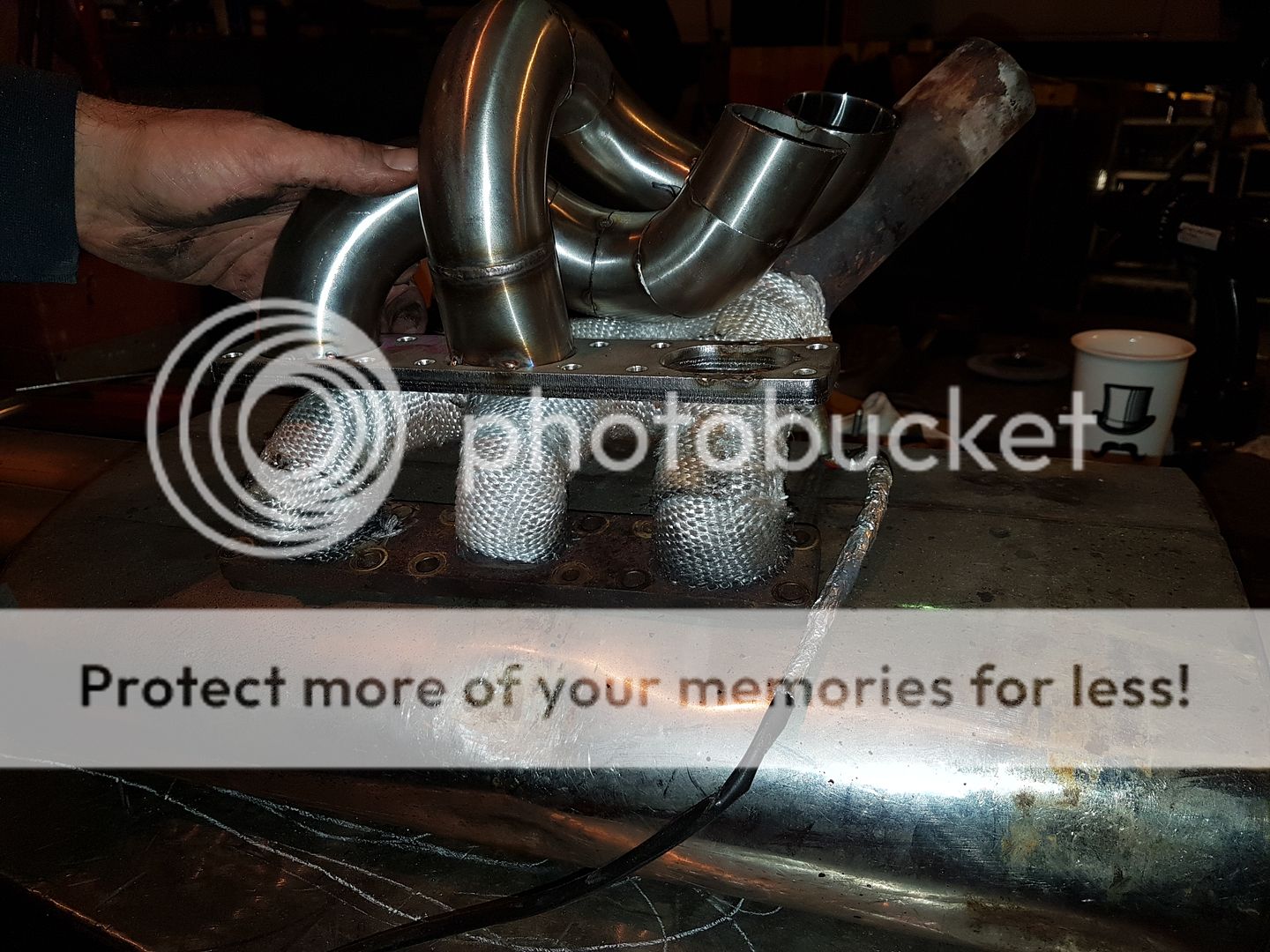

Post Sat Sep 03, 2016 6:34 pm
visiting hours today :D
new bigger flange pictured on top of the m52 one to show the difference 8O
should be ready monday :D

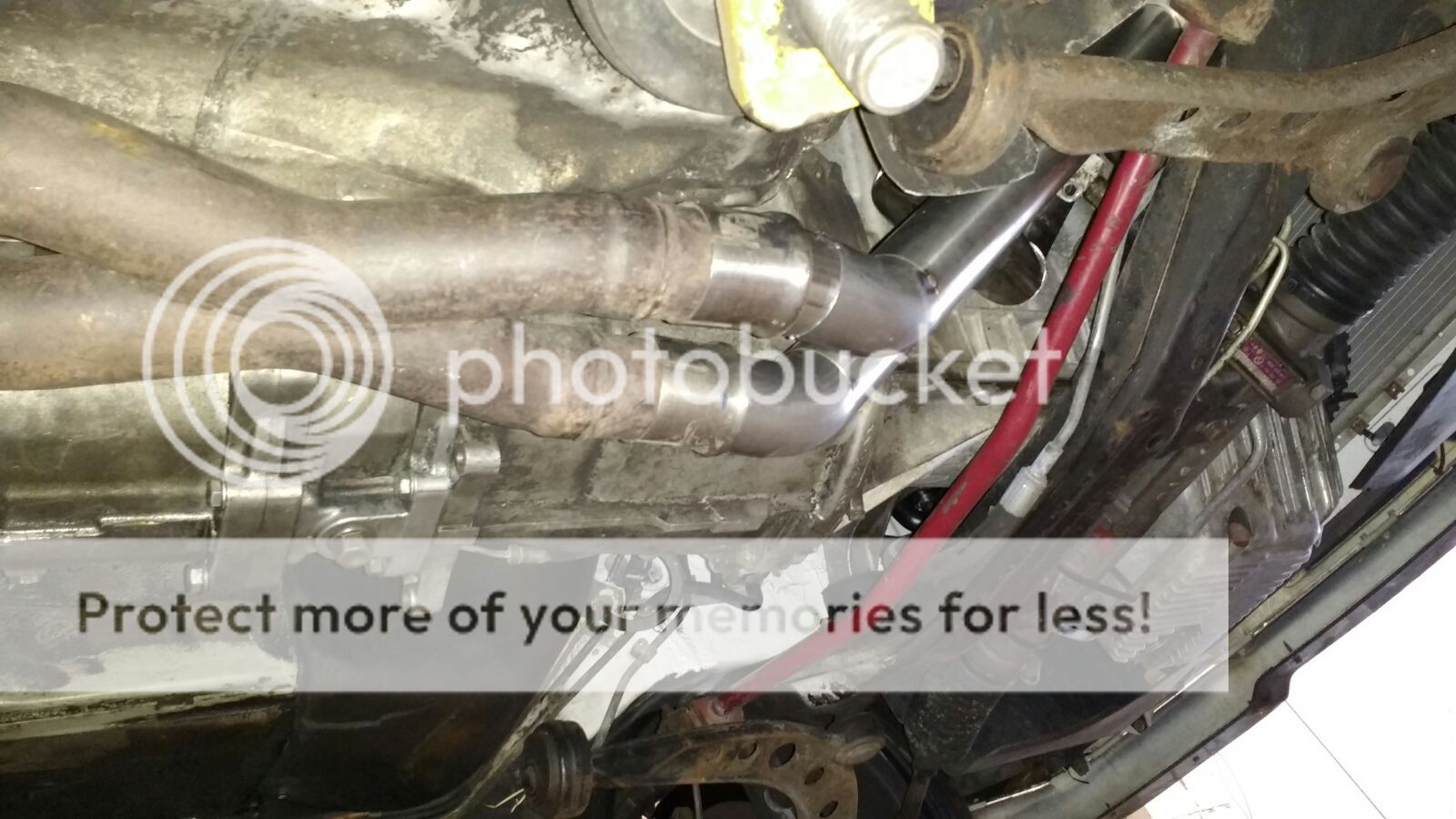

Is that now 50mm all the way through?
Check my M30 build threads:
New Daily : viewtopic.php?f=34&t=285452
Post Sun Sep 04, 2016 12:16 pm
Cypriotgeeza wrote::drool:
yes two 50mm pipes from start to finish :twisted:
Cypriotgeeza
Posts: 3055
Post Sun Sep 04, 2016 12:17 pm
I need to do this to mine!
I'm positive it's losing a few horses from the 50 - 46mm drop!
Post Sun Sep 04, 2016 12:21 pm
think mine was restricted at the manifold flange looking at the soot on it , he's also changing the inlet pipes on the scorpion back box to 50mm so it's all free flowing , no restrictions :D

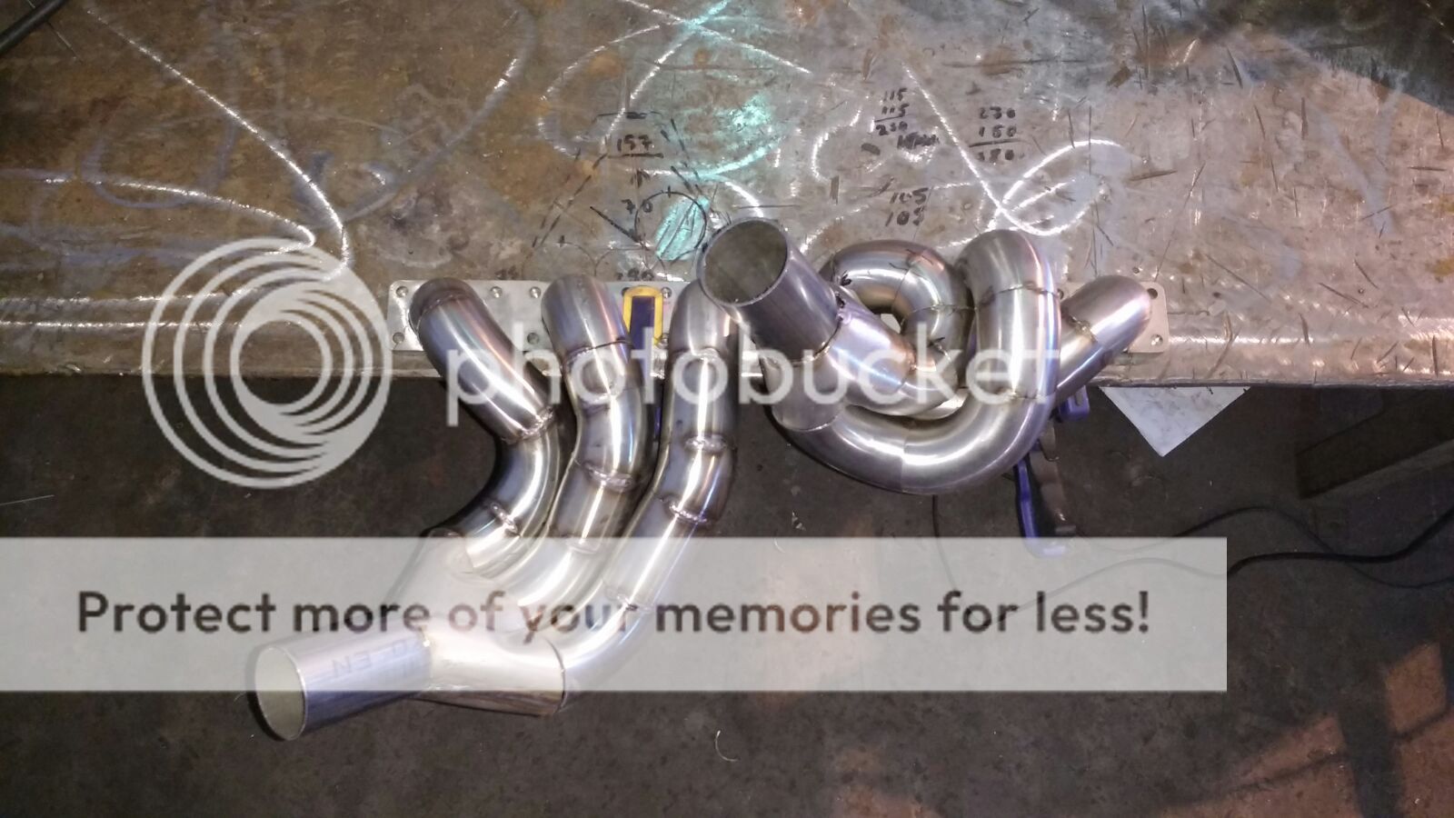

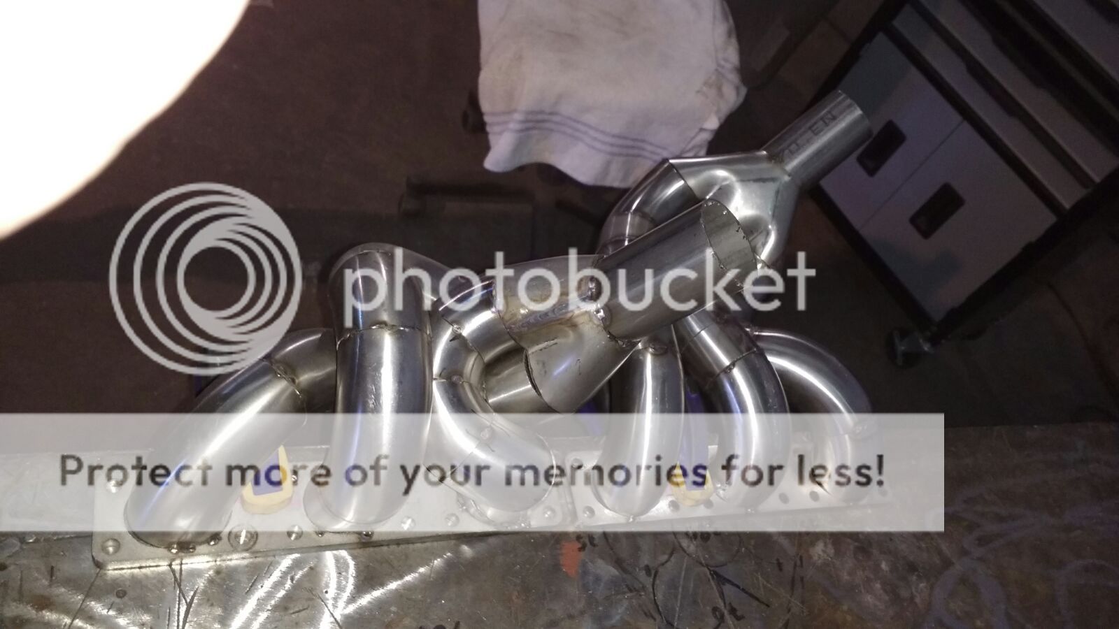

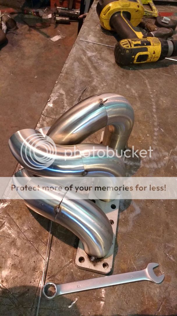

Post Sat Sep 10, 2016 12:10 pm
pass the tissues :D

Post Sat Sep 10, 2016 4:23 pm

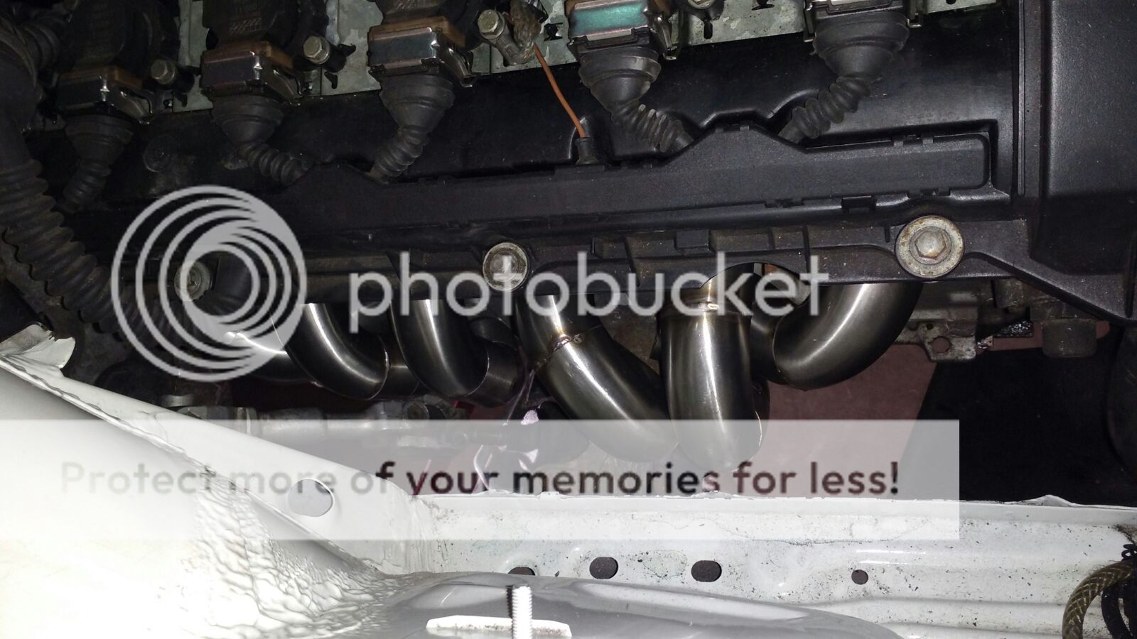

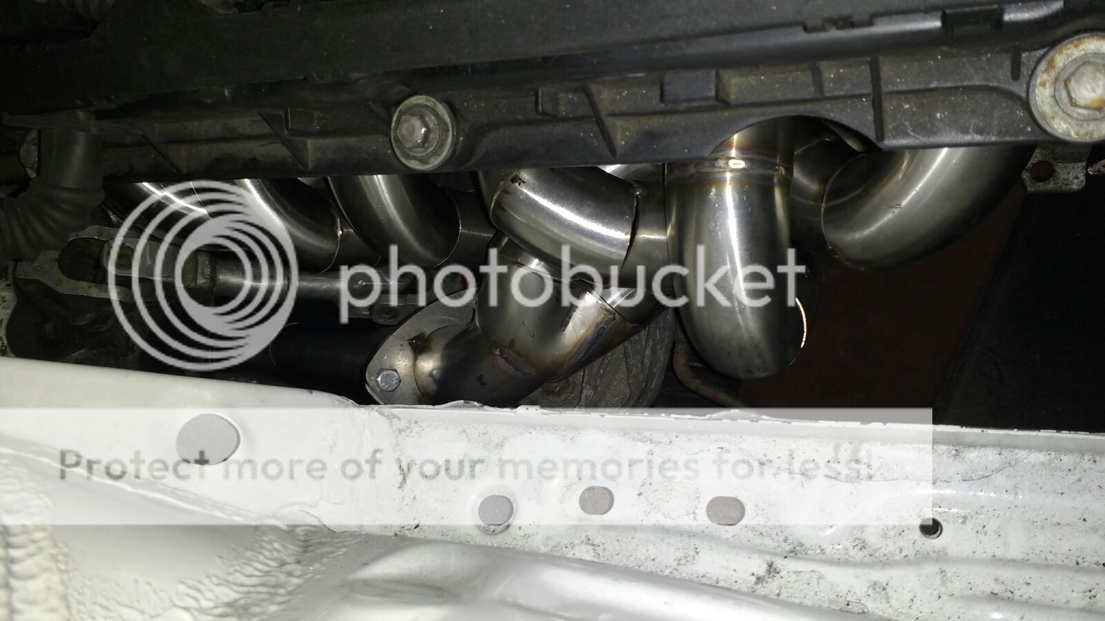

a couple more of the finished article , just needs fully welded up .
Post Mon Sep 12, 2016 1:27 am
f00k me this car is canny quick like :D seems to be up in the 6.5k rev mark instantly now .
been at the unit from about 1pm till bloody midnight though just so i can have it back, think i might of woke the street up like, because race car innit haha . :twisted:
tha881
Posts: 780
Post Mon Sep 12, 2016 8:47 am
Looks great Mick. The headers are a work of art. What diff bush are you using?

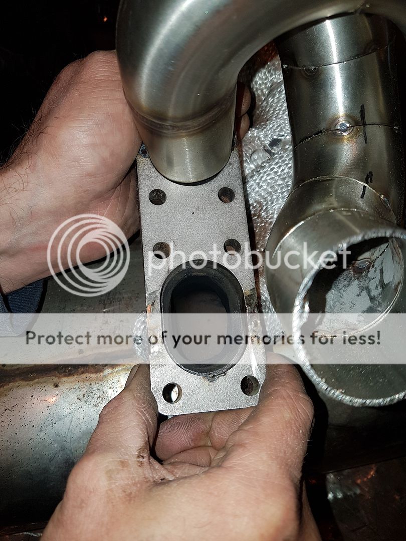

had the car back for an exhaust tweak which took 5 hours of fettling [ overwatched ] , the guy is a surgeon@ Artic Welding . I had blowing from the sleeve slots and the steering linkage was catching a bit when shown a roundabout driven properly :D , this made things a bit touchy cloth i shit you not .

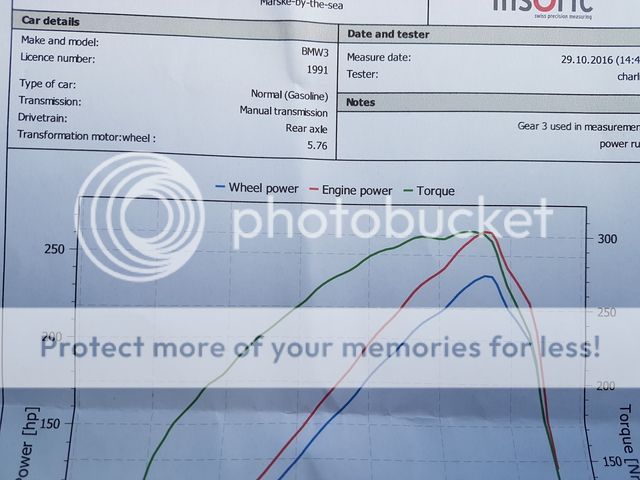

Post Sat Oct 29, 2016 5:57 pm
well here's the long awaited results >>>>>>>>>>>>>>
that'll do me nicely thanks :D :D
Posts: 28649
Post Sun Oct 30, 2016 9:20 am
Nice torque curve Mick 8)
Wonder why its in 3rd gear?

Post Wed Nov 02, 2016 7:32 am
i dont believe that torque curve, looks like 200Nm at about what would be 3000-ish rpm. i bet it has way more than that in reality it should be 200 lb-ft. Should be a torquey beast that looks far too peaky
E30 325is with M20B31
Post Wed Nov 02, 2016 9:25 am
reggid wrote:i dont believe that torque curve, looks like 200Nm at about what would be 3000-ish rpm. i bet it has way more than that in reality it should be 200 lb-ft. Should be a torquey beast that looks far too peaky
it'll be getting done again next year at a different place and compare the two results innit :wink:

sounds like a plan, the number of dodgey looking printouts you see is ridiculous, some operators must either be hopeless or their equipment is and they still expect you to pay them. i avoid no name dynos these days, its hard enough to get relaible and consistent data from the bigger name ones. look for a Maha if you can they seem to have their act together

Post Mon Nov 07, 2016 11:50 pm
magpie wrote:well here's the long awaited results >>>>>>>>>>>>>>
Hey
Is that with your ECU Remapped?
Post Tue Nov 08, 2016 12:32 am
Hey
go away rich318i your boring

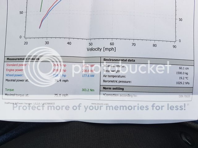

Post Sat Jan 07, 2017 11:10 pm
without , this is still running on Dan's ecu map :D
Post Sat Apr 01, 2017 11:07 pm
i think my oil pump failed today .... something expensive certainly did :cry:
Post Sat Apr 01, 2017 11:15 pm
it made 225 lb-ft today and 242 bhp ... earlier on in the day that is .
