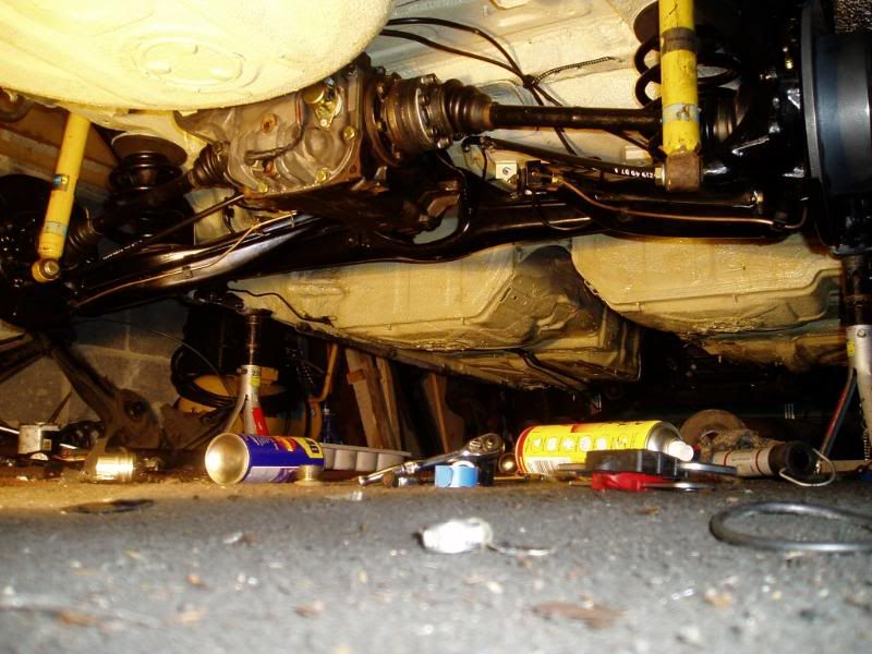

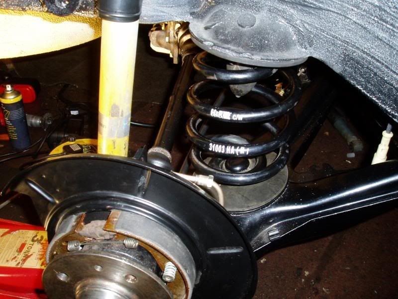

Otherside getting there, halfshaft back in
Nice and clean ABS sensor, i cleaned the life out of the trigger rings on the halfshaft

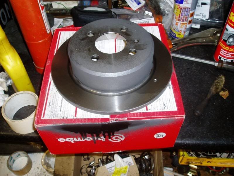

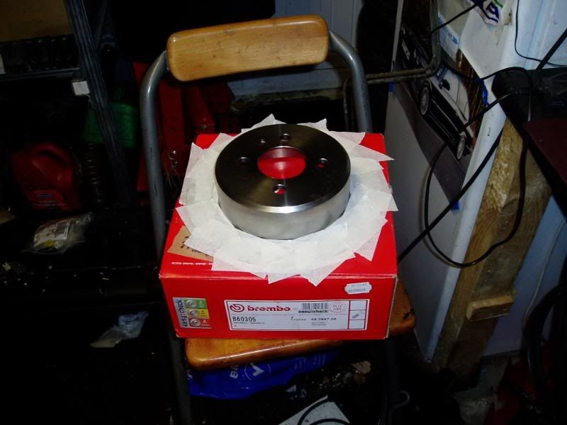

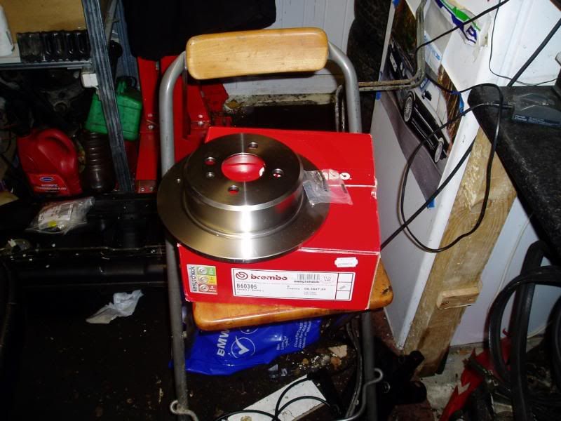

Some nice Brembo standard rear discs, £40 odd the pair from GSF. BMW wanted £45 PER disc, jog on i said because they won't last twice aslong as these brembos.

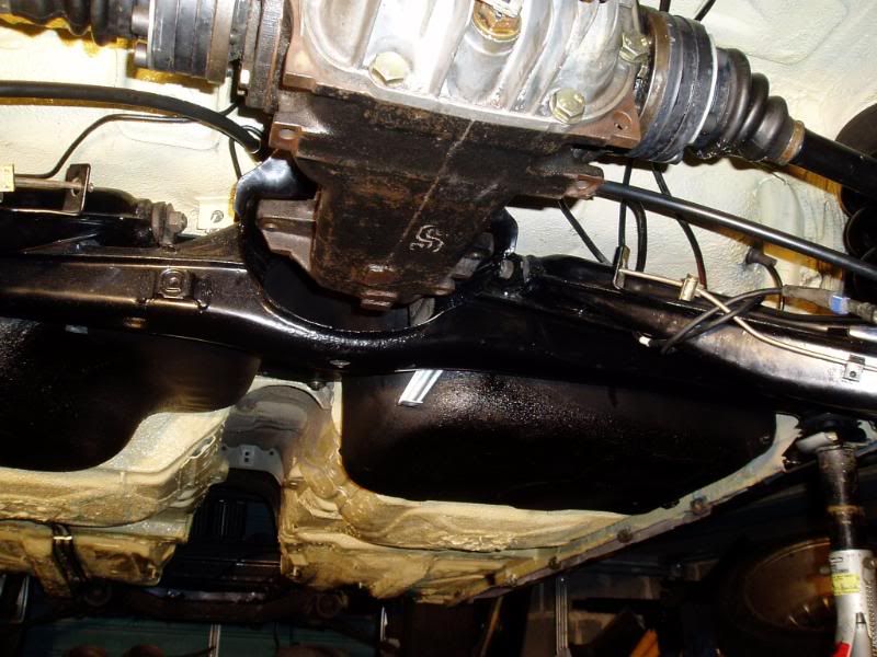

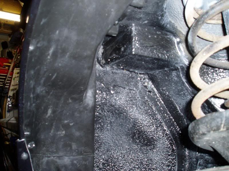

One thing which annoys me on bmw's, well the new ones is how quickly they rust! So heres my attempt with some hightemp paint. I hope it works. I did 2 coats
All nice and dry ready to go on, and adjust setup me handbrake

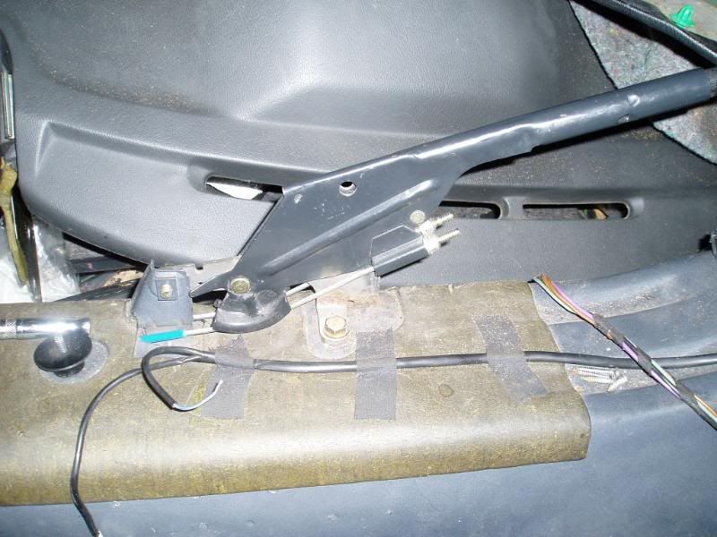

Nice and fookin tight handbrake, 3 to 4 clicks and the wheel can't move is how we like it! Too many E30's with an erectional handbrake levers!

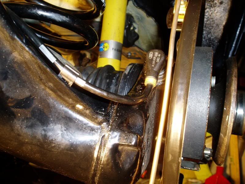

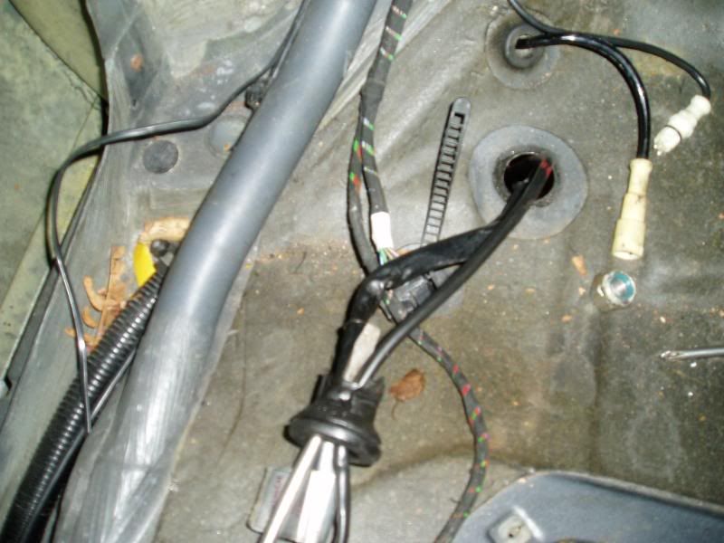

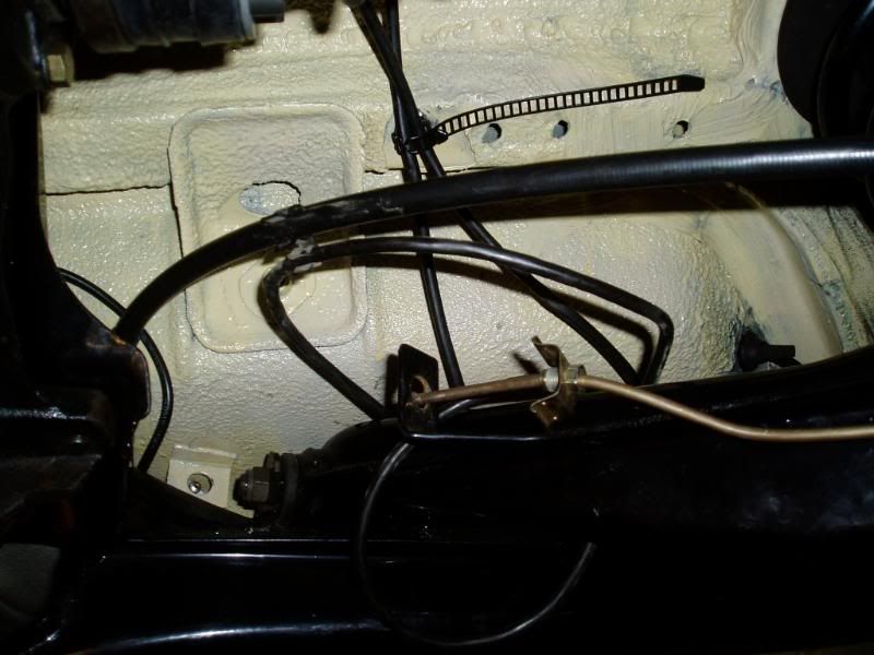

/\ Does this look right for how the wires around here go. To me it seems good but your memory only remembers how they run on a dirty car and it looks alot different under here!
Like a dick i forgot the diff oil temp guage for the vent guage, so heres me threading the wire through the bmw grommet to kept it factory looking
All in and looking ok, that black clip holding the speedo and temp wire up, f**king pound £1.20 each from BMW! :mad: Got have it though

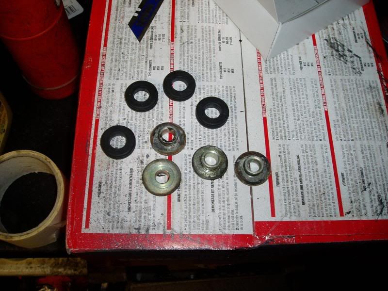

New rubber grommets for the fuel tank, the washers are re used, they are nearly £2 new each so i went tight for some reason, but i bought new bolts :snigger:

Looking good si, Where do you buy the underseal from, is it the same stuff as they left the factory with? should it be black?

Alex i've repainted the underside Vauhall Gazelle beige :clin: Its a bit too yellow for the factory look tbh its more like Peugeout antellope beige and whiter lol. I thought it would look better than bits of old, the grey the bodyshop did and the black bits i've added also tidying up some flaky parts.
I've got the part number for the BMW stuff, but you need a shultz gun and a compressor to use it Alex. Its f**king great stuff though. Its not the stuff the factory applied new but close, it only comes in black or grey but you can paint on it as you can see lol

:cool: i thought the underside was suppose to be black, is it suppose to be beigeish under the arches too, or is that suppose to be black :)

Alex underneath it was mostly beige, but the arches and other parts have over spray in black from the factory.

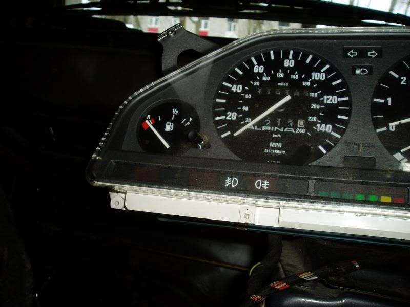

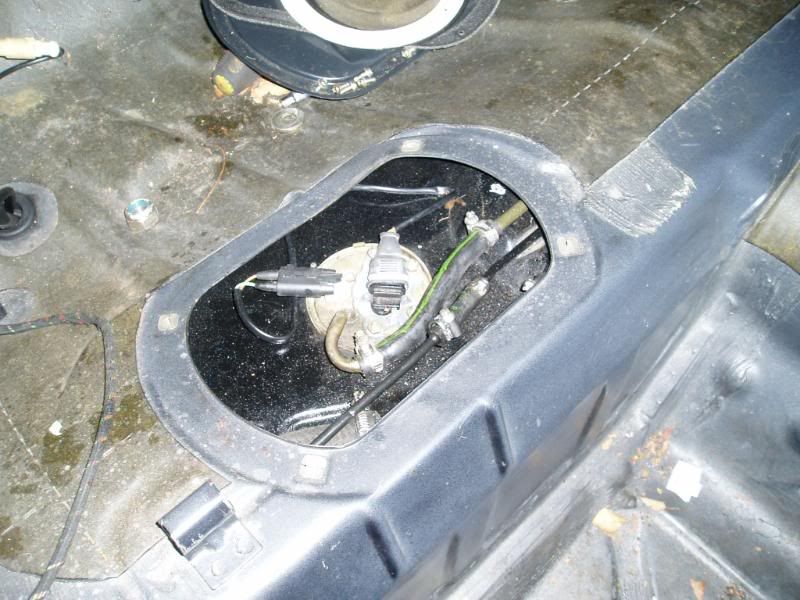

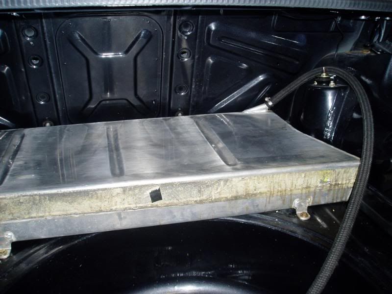

Tank plumbed in here both sides,
Comes up empty on the clocks now so must be working as the light is on also!!

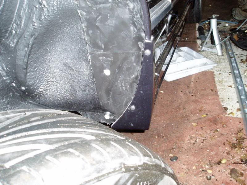

These were in the bloody way! So i thought today they can actually be fitted so on they went shiney new splash guards
Gave in here a good clean up

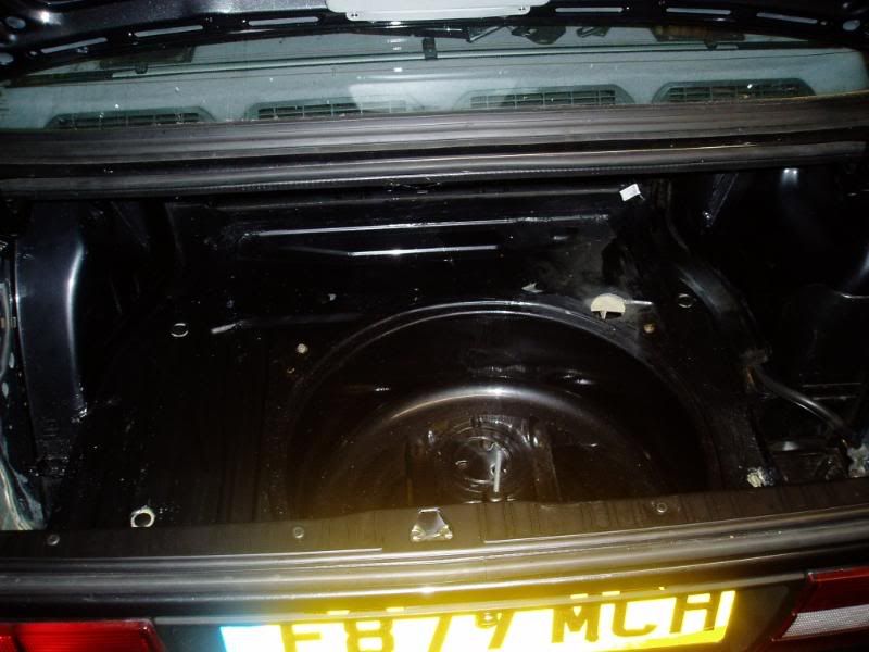

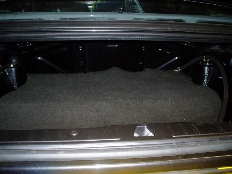

Alpina long range tank, extra 30 litres so i can spend over £100 filling it up now 8O That breather pipe hanging down there comes in through the inner arch at the top through a big rubber grommet. I measured it today 30mm it needs to be. I shall be in tears doing that!
Shitty bit of carpet to hide it,needs a serious clean first

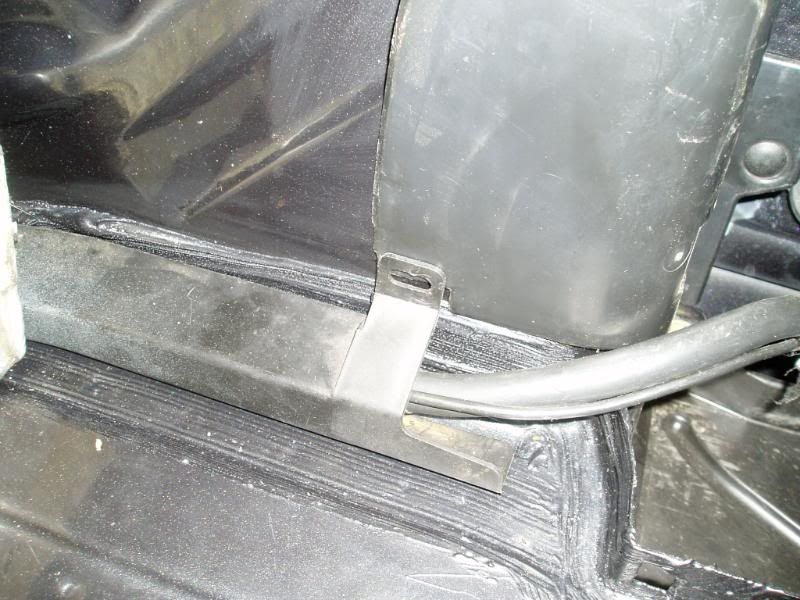

This has been bugging me for a while now, the repair panel from bmw didn't come with a threaded stud to fix these trims. I was going to Riv nut or drill it and nut and bolt it. But i'm thinking sod it now, as the pina tank holds it all nicely, plus they love to rust here and drilling or anything like that isn't going to help the matter.
What do we think not quite 100% but..........

Sun Jan 10, 2010 7:35 pm
The question Si, is what do YOU think. If your ok with it then fine but if you want it 100% and don't do it you may regret it.
Posts: 14069
Sun Jan 10, 2010 7:38 pm
Agreed, leave it loose so you can regularly check behind/waxoyl it. My Sport went badly there.
Sun Jan 10, 2010 7:43 pm
it was rusty there before so i'm going to leave it as its not now as it had a large section of inner inner arch welded in there! The pictures will be somewhere on here, pages 20-25 i think is bodywork

Agreed, Leave it. Hindsights great but a little m6 thread brazed in place before paint would have been a nice tough but hey ho. F*ck drilling it now. asking for aggro.
