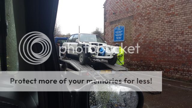

should be getting the car back today ......4 days turns into 2-weeks , typical bodyshops :roll:

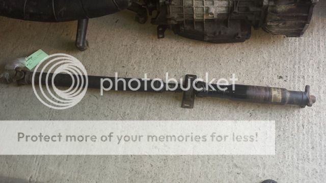

the propshaft is ready .

another day late but who cares it's done and back home , i will be spending the weekend mostly ....... down the garage ! :D

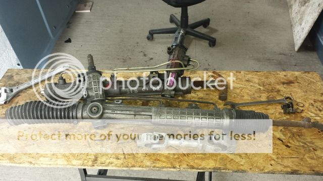

upgrades the e36 rack to e46 clubsport

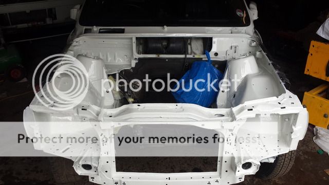

fitted a new bonnet release cable and got the engine bay looms back where they all go ,still got clutch ,brake lines and servo to fit then it's ready for the engine/box sometime next week :D

Looks clean, good work 8)
The pics aren't too clear on my phone but is that steering joint welded? :?
James
'91 325i Sport
'93 318i touring 16v
Post Sat May 02, 2015 8:55 pm
jmc330i wrote:Looks clean, good work 8)
yes it is , i've been running it since the m50 conversion package 4 yrs ago and the past 5 mots .

Pretty sure a welded steering linkage is an MOT fail :?

Cheers Jim, i'll change it should it become a problem .
