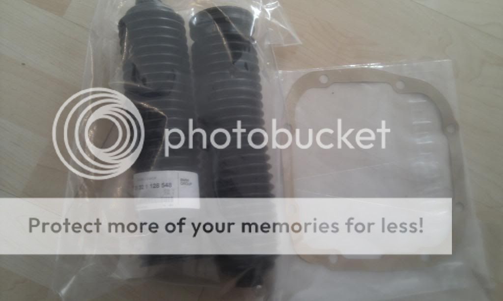

the postman has just been ...on a Sunday
with my order from BMW .
i thought these dust covers were meant to be blue

Not from BMW Mick, Bilstein provide blue

magpie wrote:the postman has just been ...on a Sundaywith my order from BMW .
Billy ones are plastic crap. Is it that time of year everyone are doing their shocks. 15 quid for them boots the rip offs

£15 each boot rich,but they came in a nice BMW bag

The tits gave me the wrong nuts for the billy tops gave me course nuts and not fine. Total different car now!! with the B8's and H&R set up, brakes are better with the standard brakes, off set bushes next then the Eibach ARB
