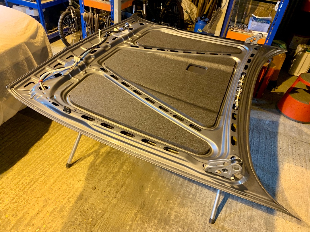

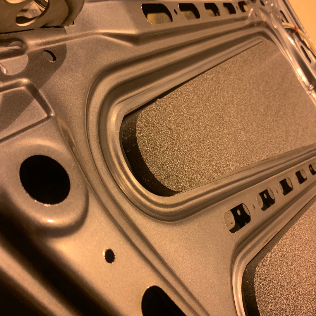

Another job ticked off! Bonnet insulation replaced!

Finished bonnet 👍

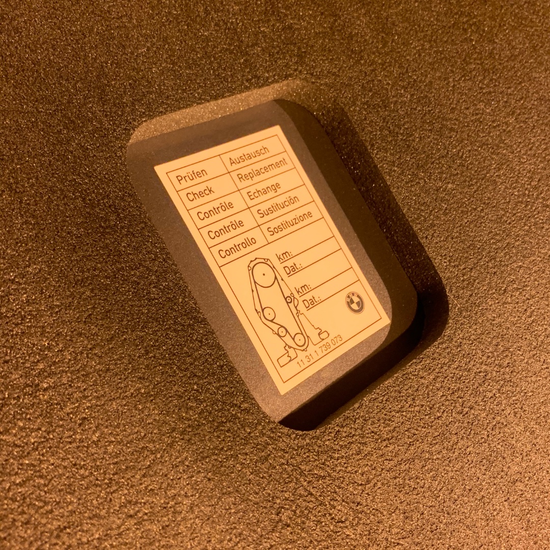

Bonnet looking great. I hadn’t realised I was missing a timing belt sticker in this location, I shall be ordering myself one!
Looking forward to seeing more engine bay, good luck and keep up the great work.
Thanks :) hard work is finally paying off!
Lots of ‘proper mechanics’ to do now :)

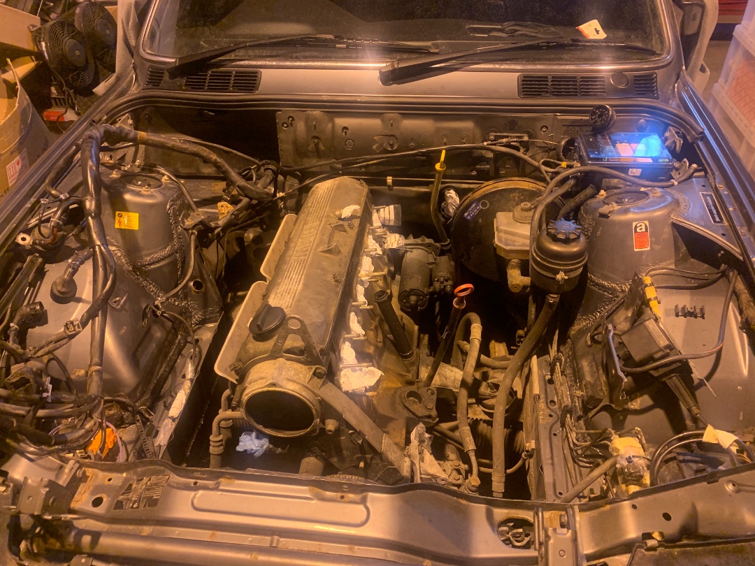

Productive day stripping down the engine bay (as much as I can while I still need to move the car about!) for a good clean.
Note this is the only time you will ever see me smile before cleaning!! 😂
Up on the ramp after my ‘staycation’ for a FULL service! Exciting!

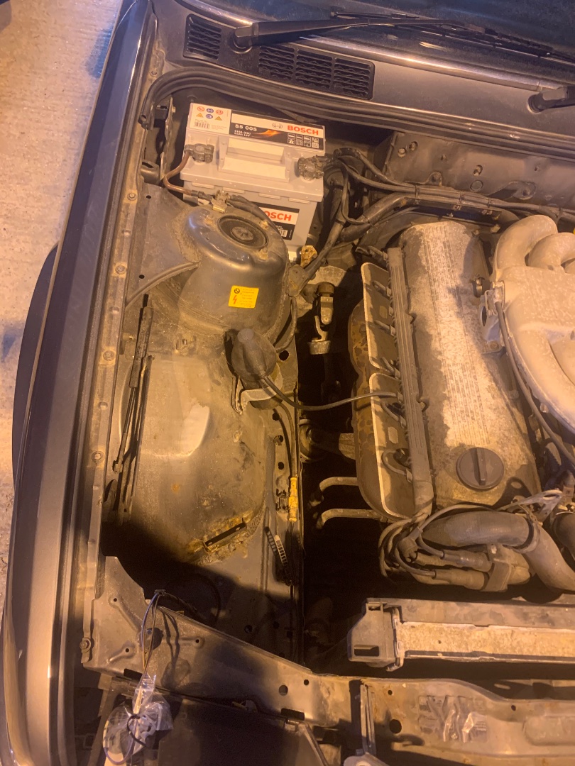

Thanks hun!! I’ll do my best with pics, lighting isn’t great in our shed tho.
These are ‘before’ ....

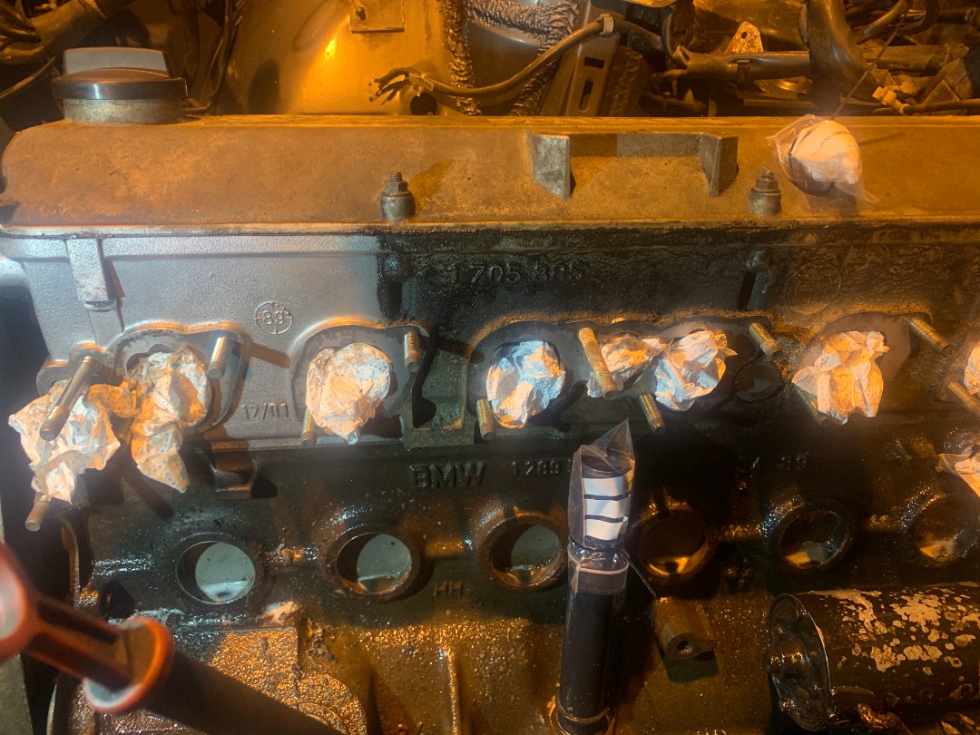

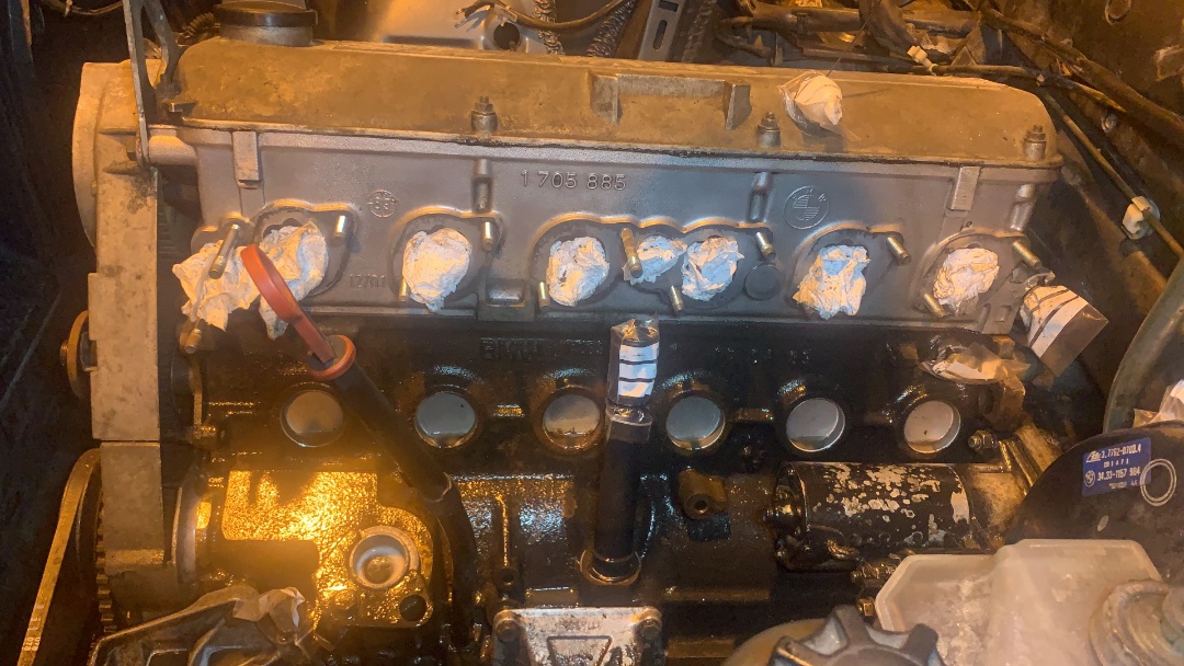

Post Sat Sep 05, 2020 10:23 pm

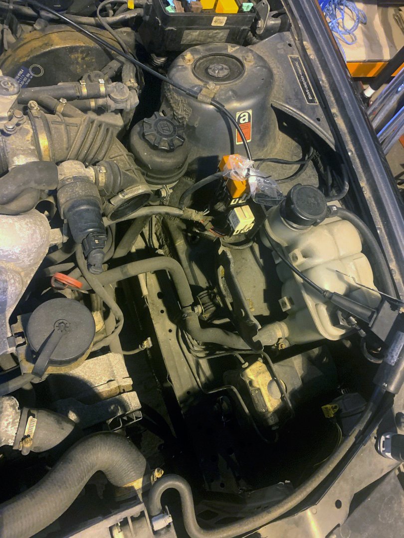

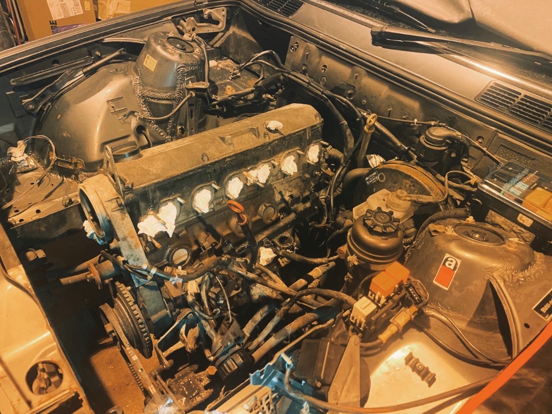

Good progress today, lots of parts removed heading towards a timing belt change.
Everything given a thorough check over, and all worn/broken/past their best parts will be replaced when we rebuild :)

Brianmoooore
Posts: 49360
Post Sat Sep 05, 2020 11:21 pm
Is that a 15A fuse I can see in position 11?
bexwoods
Posts: 249
Joined: Sun Nov 03, 2019 10:20 pm
Post Mon Sep 07, 2020 2:09 pm
Brianmoooore wrote: ↑
Absolutely no idea.... why?
Dolphin Grey 325i Cabriolet :mrgreen:
Check out my restoration thread!
viewtopic.php?f=112&t=279183&p=2964331#p2964331
Brianmoooore
Posts: 49360
Post Mon Sep 07, 2020 2:22 pm
Because a 15A fuse won't blow in the event of seized pump, whereas the correct 7.5A one will. 15A ones tend to get fitted when a pump starts to fail and occasionally blows the fuse. The uninformed person's response to a blowing fuse is often to fit a bigger one, which in this case 'fixes' the problem, but, of course, removes much of the protection against fire from the circuit. Pump eventually fails completely and gets replaced, but the 15A fuse rarely does.
Thanks for the advice!

Good progress stripping the engine bay down (to send some bits off for blasting/ultrasonic cleaning/getting ready to replace) today!
A few new jobs added to my existing list, but nothing major... 👍

A few pics from the last week....
The student and the teacher:
Wiring loom out of the way!
Look at the shiny!! (Almost ready for the final ‘bits’ to come off ready for blasting and paint!)
