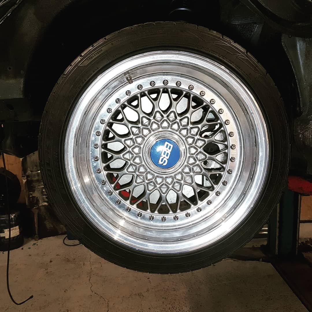

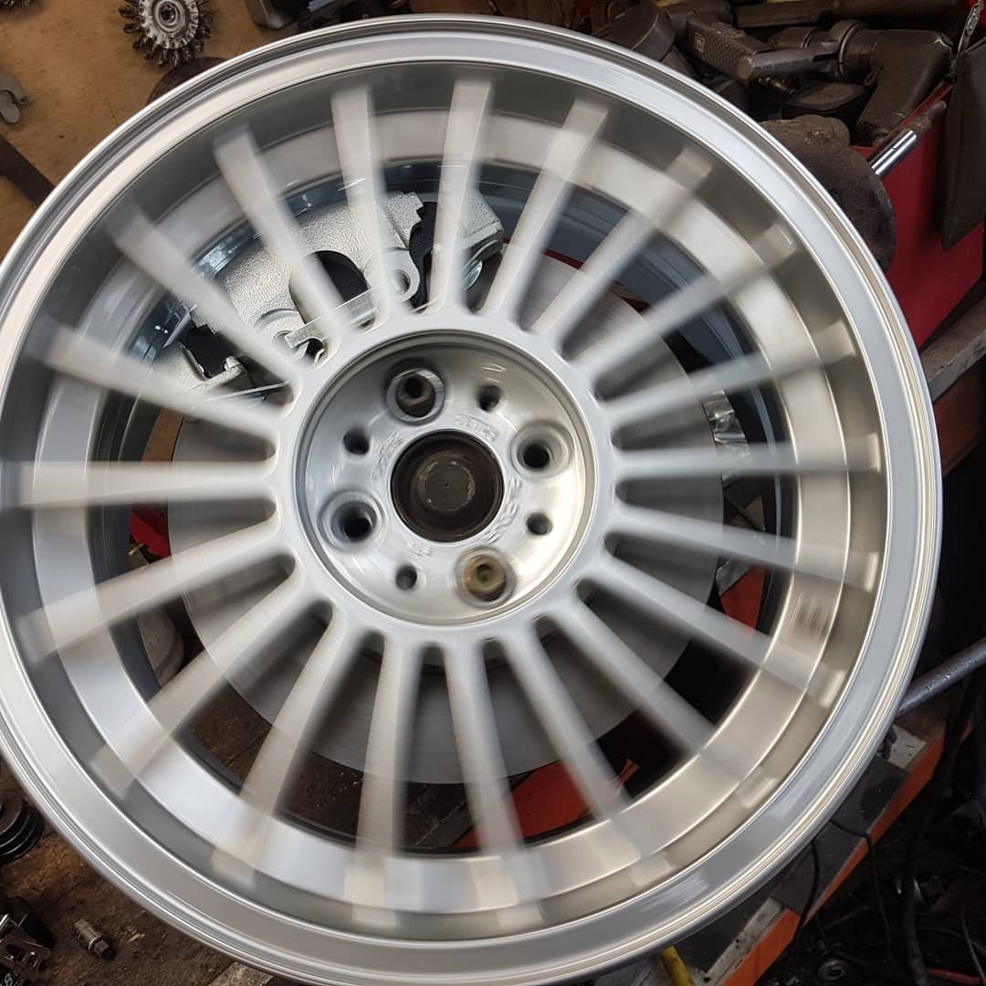

The kit I do is put together from new road car parts, so you dont get the rattles/squeals assosiated with some of the 4 pot race style kits, it also uses a much larger mass disc than many other E30 brake kits available therefore the performance is superior,
They fit under all OEM/factory 15" BBS wheels, there are 3 or 4 versions with slightly different dimensions, so you may want a 5mm spacer for a little extra clearance which I can also supply with the kits.
Some pics below and a link here - https://fb.watch/9p0G29UTuo/
