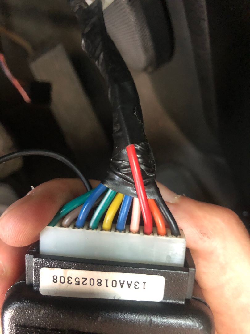

My right click module has just arrived but I’ve come across a little hurdle. It seems some P/O has installed a remote locking unit/alarm already but I don’t think they’ve used wires behind glove box from what I can see. What’s the best way of working out what each of these exisiting wires does? Then I could just replace the dud box with the right click one. Little bit new to the electric circuit stuff

Post Fri Jun 26, 2020 10:47 pm
Always good fun unpicking other peoples bodge ups! At least it looks tidily done from the little bit I can see, even if not connected to the points BMW intended.
You'll have to unwrap the black tape and split the bunch of wires until you come back to where they individually connect to the OE wiring, and then show us some more pics.

Post Sat Jun 27, 2020 11:25 am
Yea it doesn’t look like an awful job to be fair. Is there anyway of determining what each wire does without unwrapping it? I’ve got a multi meter ....

Brianmoooore
Posts: 49360
Post Sat Jun 27, 2020 2:17 pm
It would be possible without unwrapping, but you still won't know if they're connected correctly. Also, it's bad practice (and potentially extremely confusing) to add extension wiring onto existing extension wiring.
Yes I know it’s bad... but I did it. Worked out which was the unlock and lock along with the 3 grounds and indicators. All wired up and working a treat!
Does anyone have a solution for the key blades not being correct? Can we get correct blades?
