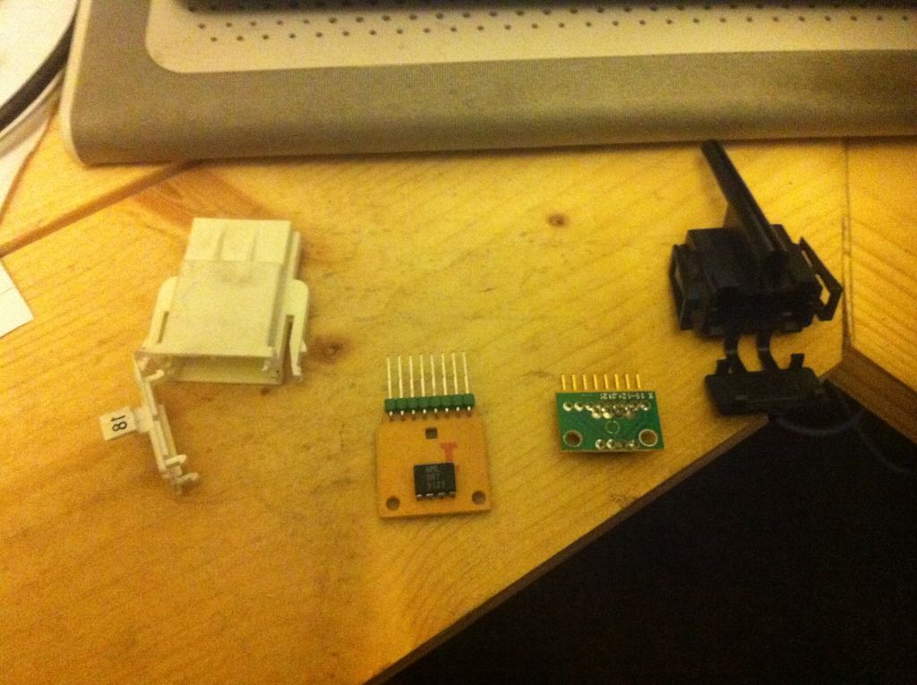

use coding plug BMW part number 1377664. its from the e28 m5 that has a 6 cylinder signal and the 8k tach. you'll need to pull the chip out of the plastic housing and make it fit into an e30 coding plug housing, so not plug and play

good advice dooce, i was sure id have to get the dakota digital box for my clocks to work with my s50. will the chip fit into any e30 coding plug or just the m3 one? or are all the e30 coding plugs the same?

all the e30 coding plugs I have here are the physically the same, just have a different chip inside and a different part number on it. the e28 chip is a tiny bit narrower and quite a bit smaller overall and wont just slide into the e30 housing. the housing will need to be modified somehow, I havent done mine yet but the best bet is just to get ahold of one and put eyes on it, I'm sure you'll find a way make it work that you're happy with. I will post up what I do when I get around to doing it.
e30 coding plug on the left, e28 on the right Image
