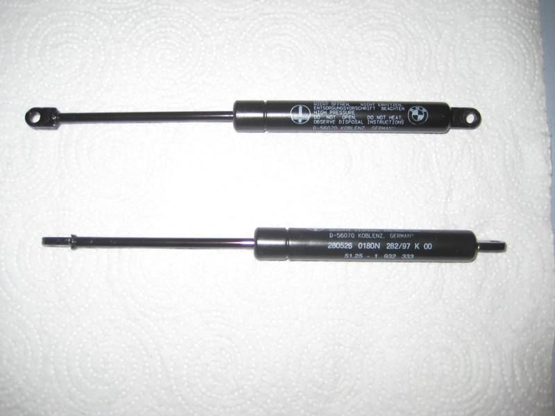

Yes these are genuine, but were made in 2006, note the date on the BMW packaging 03/07.
Yes these are the original manufacturer, without the BMW logo on, as Gavla & jamo123 have said, but these shown in the ad were manufactured in 2011.
I'm a bit weary about buying aged ones, as these small ones don't seem to hold their charge for a long time & they are so expensive.
Picture of my replacements (now discharged) I installed in 99, manufactured in 1997. Note the Stabilus Logo on the left.
However have sent mine to SGS Engineering to see if a re-gas is possible, it will be a very useful thing for us to know.
If not I'll be going for the Stabilus ones.
Will report back
Cheeers
