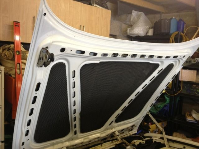

From my sport thread.
bss325i wrote:Another job i have tackled recently is the under bonnet foam which is a common E30 problem and can be very unsightly under the bonnet when its old and crumbly!
A top tip for this job!
I have heard of other people tackeling this and it being very messy and time consuming. Well i have found something that speeds things up and reduces the mess!
Toytas own brand brake cleaner! It is solvent based and after removing the bonet, pulling of the bigger chunks of foam you are lift with the glue still on the bonnet with a thin layer of foam.
The Toyota brake cleaner disolves the glue and foam and turns it into a mush that can be scraped of, near enough wiped off with plastic filler spreader and a rag.
Once the mush is removed a wipe down with the brake cleaner and the surface is ready to stick the new foams on. The brake cleaner does not damage the paint in any way either.
Much better! :D

Wed Jan 23, 2013 4:17 pm
Barry, what's with the two washer nozzle valves in your pics? Isn't there only supposed to be one?
BenHar
Posts: 3068
Location: Reigate, Surrey
Wed Jan 23, 2013 4:20 pm
Grrrmachine wrote:Barry, what's with the two washer nozzle valves in your pics? Isn't there only supposed to be one?
Dual wash wipe system. One for normal one for intensive.
Ben
Wed Jan 23, 2013 4:21 pm
Cars with head lamp wash wipe also have intensive wash so two pipes and there for two one way valve run to the bonnet washer jets. One from the main tank and one from the smaller intensive wash tank.
BMW also sell screen wash which is clear/blue in colour and intensive wash which is green and should be used neat.

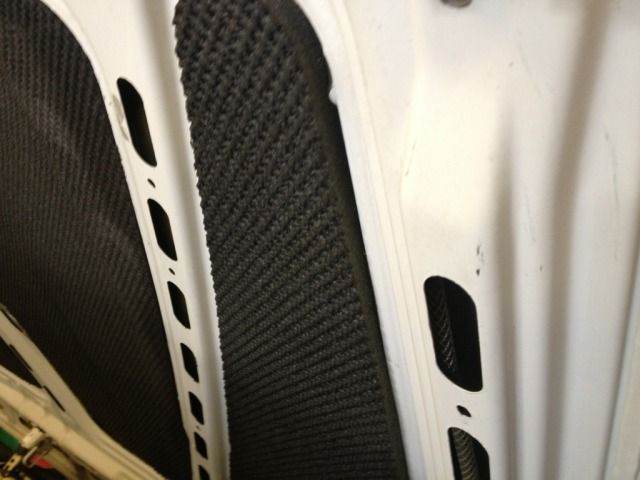

polsta
Posts: 10322
Sun Feb 03, 2013 3:33 pm
looks like/same as the latter 318is stuff
heres my old is, this wasnt the original foam
age
Formerly twist316
Posts: 448
Joined: Sun Dec 28, 2008 11:00 pm
Location: cork ireland (kosice slovakia)
Sun Feb 03, 2013 4:53 pm
too lazy to read 2 pages about foam, but anyone take notice that the cut out for the throttle body isnt in either of the above pictures?
