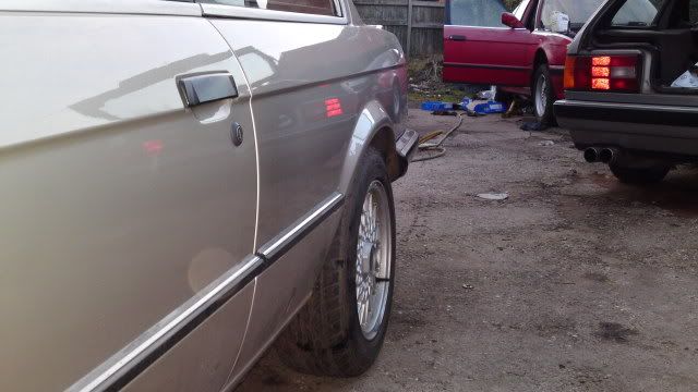

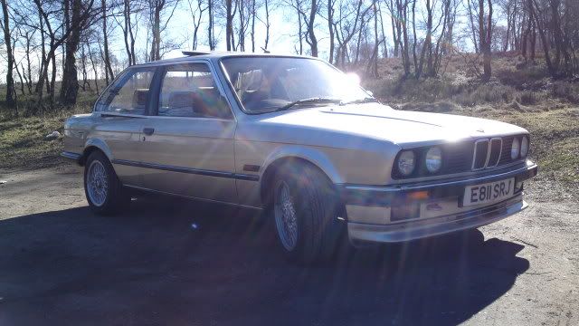

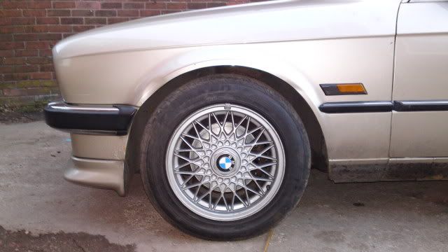

Mine has the Eibach pro kit and standard ( shagged ) shocks :
Just right IMO
