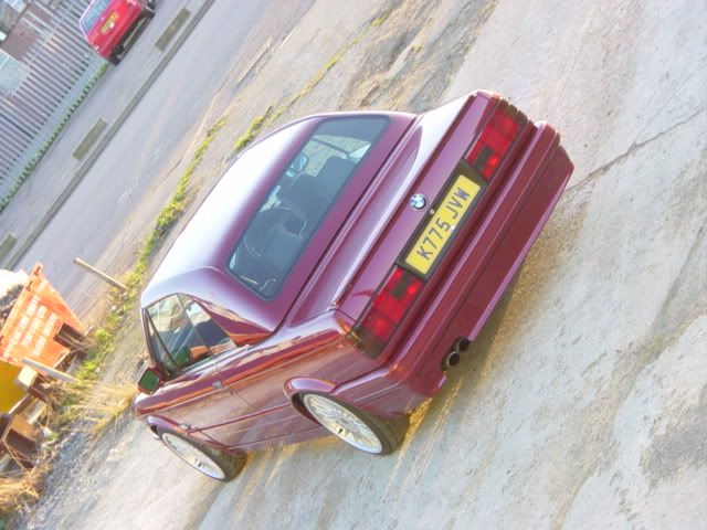

Karan wrote: i'll have u all in the super tourer......
now with black lightweight bonnet and hartge suspension.....
Do you have a black bonnet? I have seen carbon fibre bonnets and always wondered what mine might look like with a black bonnet.
Do you have any pictures
Post Sat Aug 20, 2005 12:30 am
what have u done on the rear of that car!!! tis a bit low!

Post Sat Aug 20, 2005 8:06 am
Karan wrote:
i want a touring now... 8O

tourers lookin stealthed up!! 8)

Simon13 wrote:what have u done on the rear of that car!!! tis a bit low!
no rear springs or shocks.... picking em up at gaydon...
