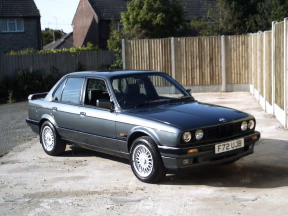

hi, i bin on the site 4 2months now and just thort id fill u guys in wid my situation.
i three months ago sold my reno 5 gt replica and decided i wanted cheap fast and practical weekend car as i now hav a company motor aswell. i rented a garage and go my self me babe of ebay.
as u can see she needs sum work. i bought her on the understandin shes got an lsd and an alpina b2 ecu (which as im just startin wid my 325s meant a little but not 2 much). apparantly chipped n re mapped 2. i was provided wid the standard chip aswell. also car is sornd and mot less so she aint bin on the road yet.
however i aint to sure now the more i learn about these cars. the traction off the line is good but 1 wheel does tend 2 break traction breifly. this shuddnt happen wid my lsd shud it?
also, ecu is different lukkin 2 my m8s and clips hav bin opened so odds r it bin chipped. engines idle is 850/900rpm which is a tad higher than my m8s and has a strange rev limit on it 2 but r there any other signs out there to spot these things and try 2 work out if they hav actually bin done or have i.
dont get me wrong but i aint dissapointed in her 4 what i paid i feel shes a bargain an just what i wanted but wanna no exactly whats bin done before i get her on the road.
guys can u help?

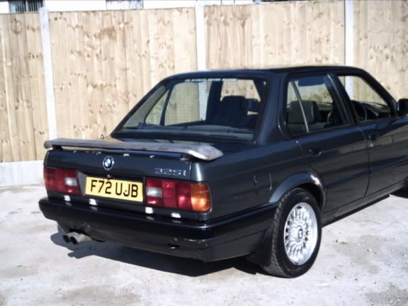

zender spoiler just arrived. not to sure wether to fit it or not. what u guys think?
what yas think

Post Tue Jun 07, 2005 9:32 pm
Thats very similar to mine, but I have the std lip spoiler underneath and it has two struts that fix the middle part down, yours seems to float on the two end pieces...cool....never seen one of those before and mine def a Zender, says it on the underside.
May look a whole lot better when you paint it, might not, each to his own, mine had the spoiler on when I bought her and tbh I like it, it's not a m0tech one so it's diff.
Good luck with the motor too :D

Post Wed Jun 08, 2005 12:56 pm
cud u post or pm a pikky o ur spoiler 2 me cos mud like to see it wid lip aswell. cheers m8.

dikky5 wrote:cud u post or pm a pikky o ur spoiler 2 me cos mud like to see it wid lip aswell. cheers m8.
They're ya go :D
