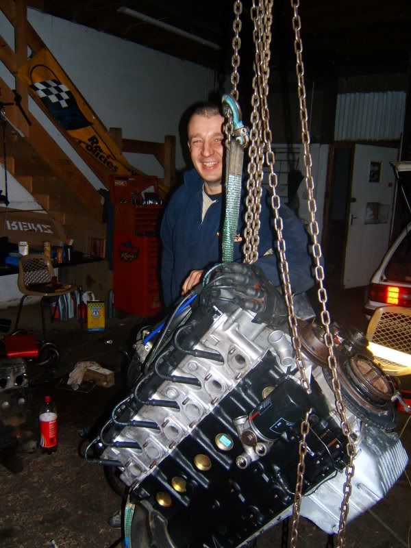

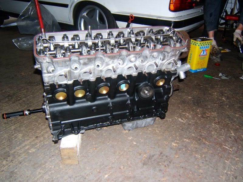

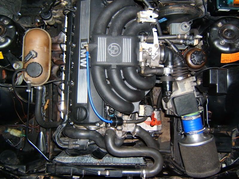

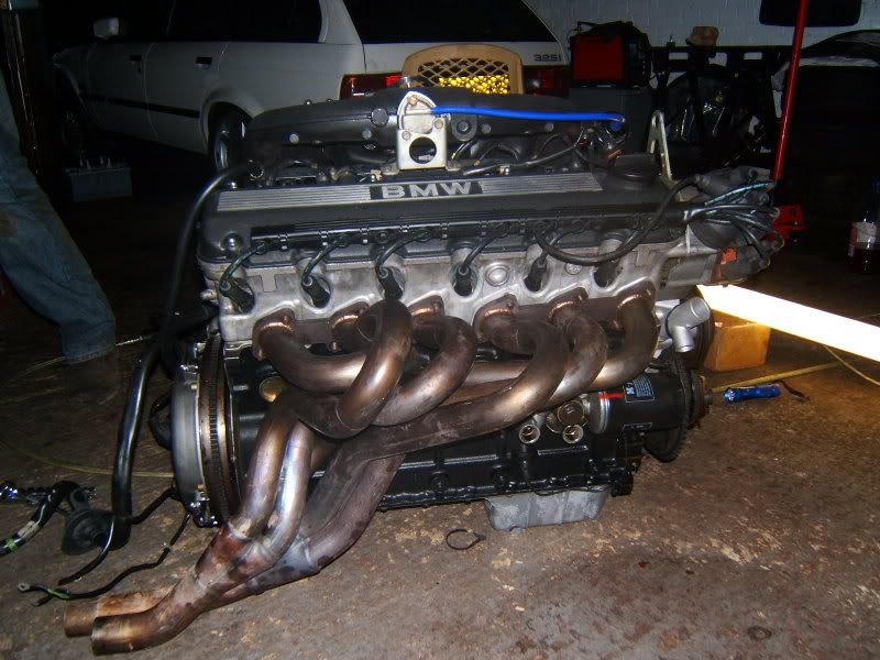

Some pix......
almost ready to drop.
someone looks excited.
This conversion was done by me, As A-Tech, to offset some labour charges, and save some time I agreed with Oz that he could use my workshop and tools to remove the old engine, this is where Theo and Simon came on the scene.
Bottom end was built and ready to go when they arrived, Oz had the joy of lapping his new valves into the refurbed head, Simon and Theo had the task of pulling the old mill out, all carried out no worries.
Myself and Oz then rebuilt the head, with Simon setting the valve clearances later on, fine job done by all again.
Head was refitted and torqued down, then Simon began swopping the inlet over and all associated gubbins, this freed me up to assemble the vernier, fit the pump and cambelt, clutch etc.
As always many hands made light work,
Its not the norm for me, but I wanted Oz to have his car back on the road ASAP, plus I needed to take some time out on Sunday, and as already stated, I think everyone took some new knowledge away with them.
now all I gotta do is build the other 2.7 stroker back up and pop that into a certain white touring, oh and add the turbo :twisted:
Big thanks to Toby for Coffee, moral support, and generally getting stuck in trying to get that sodding air out :lol:
:thumb:

Wed Jan 10, 2007 7:26 pm
Whos the racing dynamics hero in the background!
Well played Oz glad its come together for you mate

Fowlers car sounds like it might be quite a weapon.
Oz, you gotta love a proper cleaned up engine. With that manifold, and black rocker cover etc it really looks the business. :cool:
