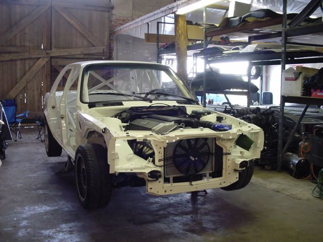

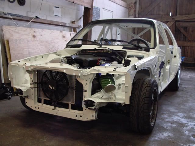

Here are some really bad pics..
From the front, I still have my horn there as there is that much room!
Airbox mount mounte to rad and fan
Lip cut in shroud
Fan from the top (pulled rad out a bit) Just tie it on with a zip tie at the top!

The Pic's, even though you say are bad, are very helpful indeed, gives me a better understanding of how this all works. So currently you don't have a thermostat switch which will turn on the fan a the required time, but you actually have a switch sitting inside the car...Hmmm. Very interesting.

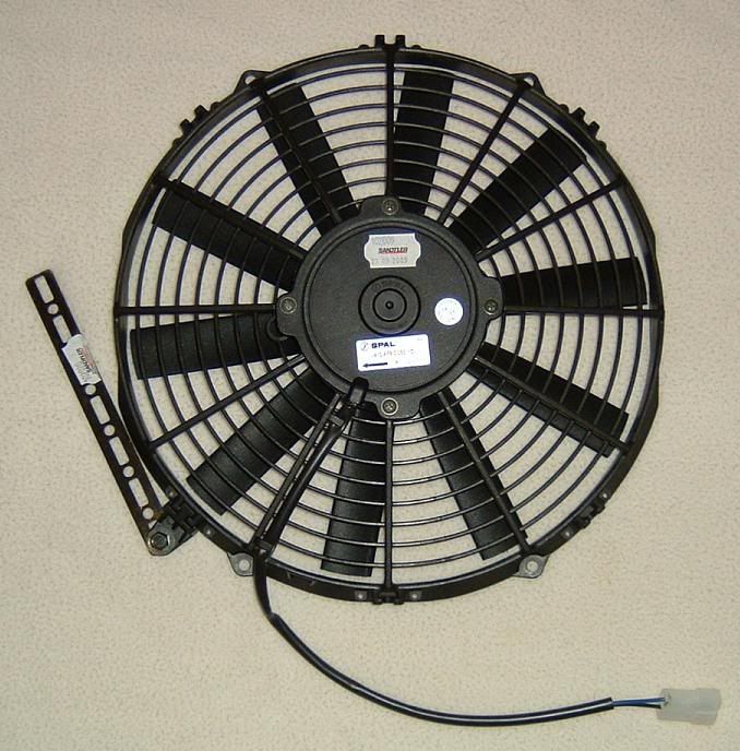

Don't know if you still need info on this but I've got some pictures for you which may help also.
I've got a spal fan which comes with mounting brackets.
Oncar :

[quote="Tom944"]Don't know if you still need info on this but I've got some pictures for you which may help also.
Dude the pics are sorted, many thanks go out to all the guys who have inputted on this thread.
