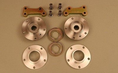

Same concept spacer under the disc but "€1000" OMG, if i can get the same thing made up without the caliper bracket would anyone be intrested, the reason I wouldn't want to make the caliper brackets is cause many people would want to run different calipers the cost would be way less than €1000

300mm.de
They use custom hubs made to order, not E28 with a sleeve, don't think there are cheap easy routes, many people have tried.

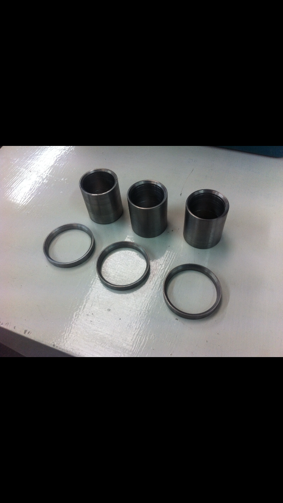

Brakes for my e30 330d, well I've given the parts to my mate who works for Mclaren in the department were all proto type parts are made he will be producing the sleeves for me and get the e30 abs ring onto the hub then will look at the spacer but after looking at the fit of that 300mm jaguar disc won't need to space too far. Yes 300mm.de haven't used the sleeve technique but a custom hub that has a bearing with the correct size ID, what I'm trying to do is make a solution that won't cost you in the thousands and will use off the shelf parts were possible.

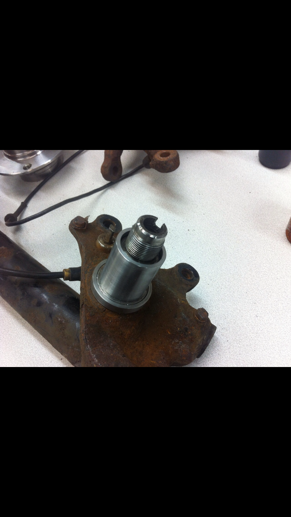

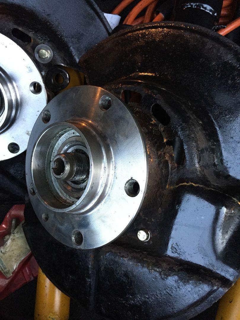

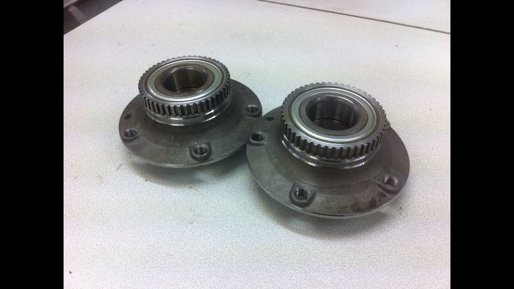

For anyone that is wondering how this is getting on see below
The last pic is the 4stud abs ring on the 5stud hub

Legs are at the powdercoaters so once there back press the the sleeves and ring for the base on then press the hub on. I just need to decide what disc and caliper setup I want to use so I can work out what spacer I need.

Just had the hubs pressed on yesterday and ordered the correct offset disc and 5x120
