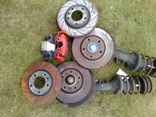

If any body wishes to go 5 stud PROPERLY, I have a pair of complete E30 M3 rear trailing arms with brakes etc and a slightly bent o/s front strut (ideal for coil overs0 I also have M3 front brakes and the M3 specific lower strut mounts .

This is what you need to do it properly!

senna wrote:Image
+ my rears, job jobbed ! :)
