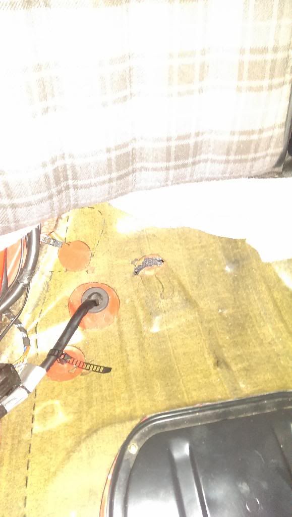

Made somes skates from a length of box and 6 casters I "found" at work then stripped the whole rear subframe out today and dropped the car back down on the new skates so I can still move it around on the garage floor reasonably easily although it is still bloody heavy to push on 4" solid wheels.
Also found two holes near where the rear tank mounts are, no real break in the underseal inside or out but after a poke with a biggish screw driver they were there alright... still nows the time.

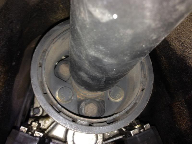

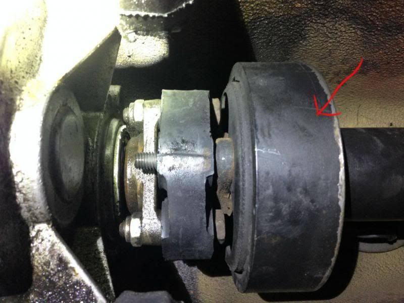

Attempting fuel tank removal - so far removed exhaust and prop shaft bolts either side, struggling to remove the prop and not sure what the big cylinder is (arrow) as it doesnt seem to feature on many google images. Removed centre brace and pulled down prop, but cant pull bolts through guibo.
Some problem bolts among many
Aniti roll bar bushes replaced and rear pads being replace once the new ones are here.

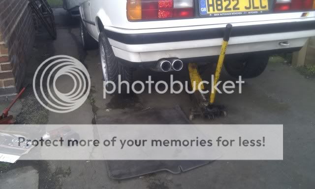

I spent today making a temporary carport (a big ass tarpaulin over the drive) to try and avoid the rain while working on the touring, and by this afternoon I was left with this...
And yes, after getting soaked getting the tarpaulin up, that is the sun making the shadow on the wall :roll:

Big job in a small space... I like your style. A true soldier :D

the thing on the end of the prop is for balancing/vibration damper ,some e30's have it some don't .
you need to undo the bolts that fix the prop to the gearbox ie the other three bolts lol ...two combination spanners 17mm is what you need...you will probably need to double up another combination spanner for extra leverage as these are normally, very tight ,unless you have forearms like mine :mad:

Thanks for the reply. Used the same technique with the 2 spanners in the end. Also posted this in the technical section as I was struggling to get the prop off and one of the guys informed that I needed to remove the other 3 bolts.

Can't let a lack of space stop you! Rain on the other hand.... :o:
That's all the space I've got in front of the touring - there is another parked behind it (missing a front hub/bearing so can't be moved) and the two are bumper to bumper!

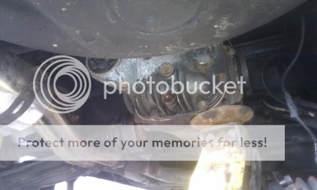

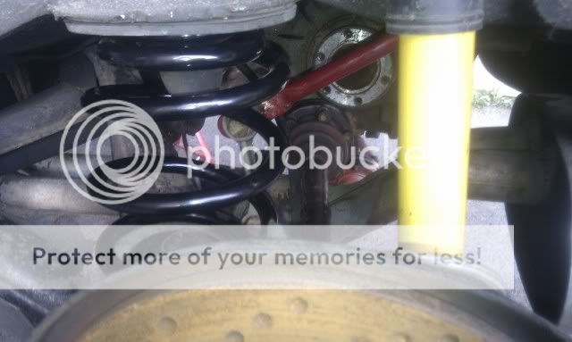

i had a couple of hours playing with the garden ornament today and fitted the new torsen diff,i also fitted the freshly powder coated eibach springz :D
i had a right fook on with the last diff bolt [on the top of beam] :x
looking canny good like 8)
