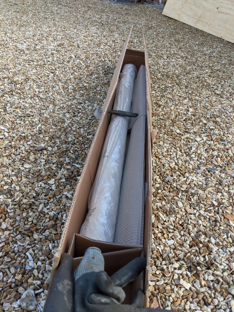

For any one interested, this is what part number 51951924961 looks like.
The roll is quite heavy and seems like there is plenty for my more door :D.

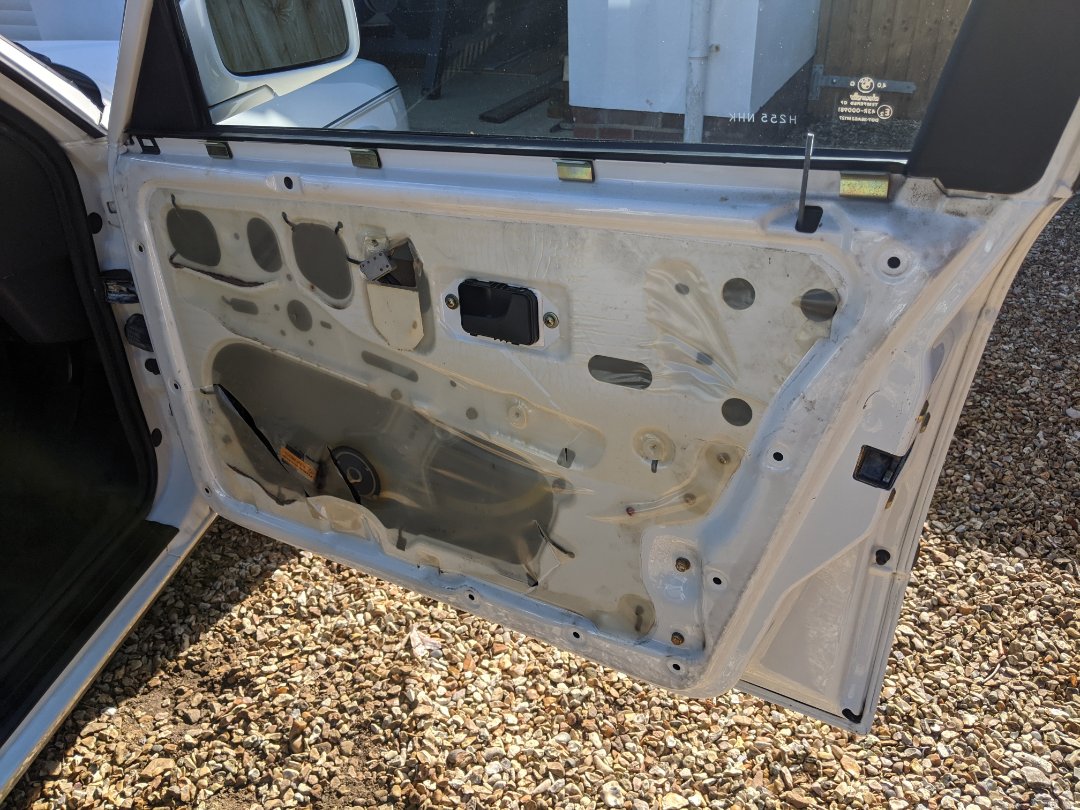

30 year old membrane on a garaged only E30. Condition is much better than expected and the membrane gave quite a fight when I tried to remove it.

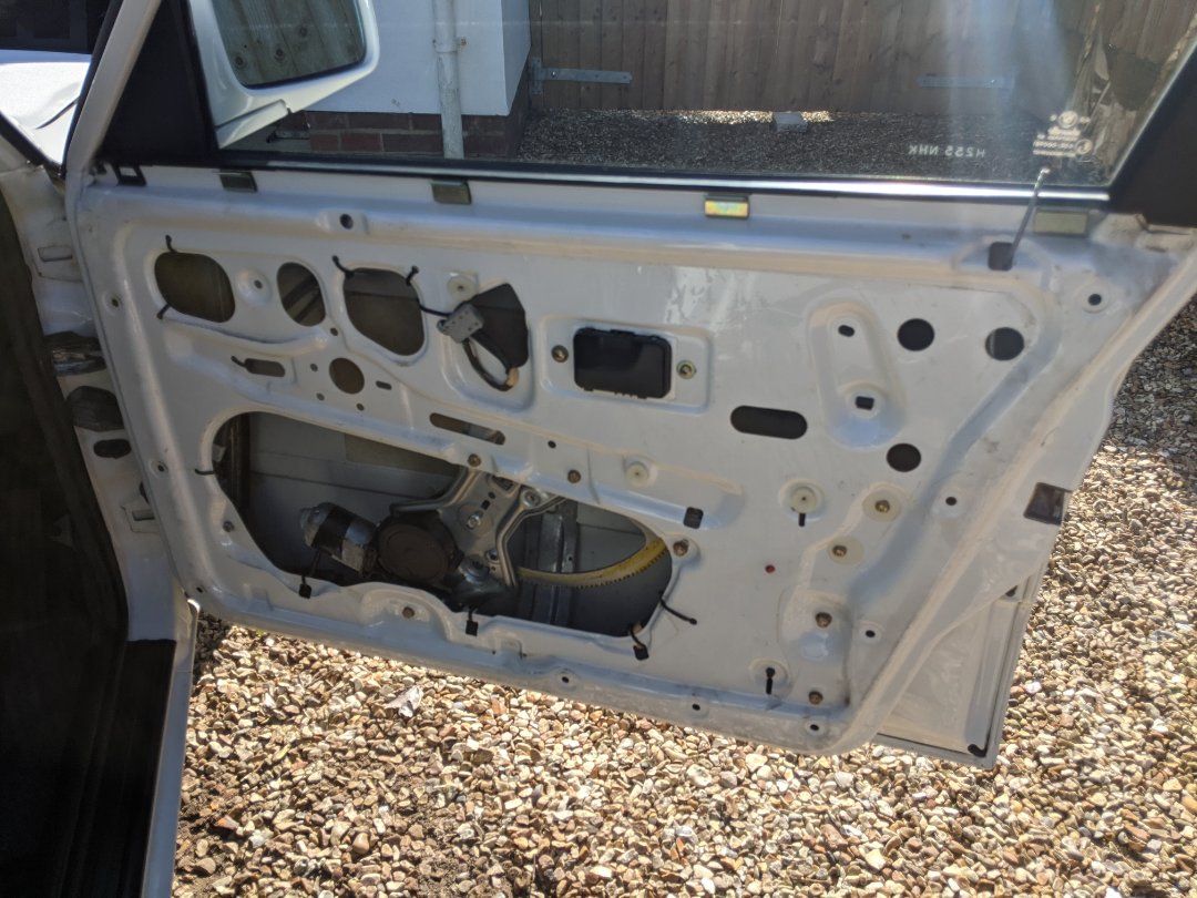

With membrane removed. The window mechanism is quite impressively over-engineered.

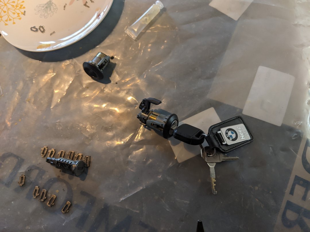

I did however get around to using my lock rebuild kit I purchased 6 months ago... Very impressed with the updated design. Lock actual works now and have ordered a new one for the other side too.
What's been updated?
Thanks
Ben
Thanks
Ben
Most notably to my memory is the use of a roller bearing instead of a ball bearing.
Also, the casting that holds the barrel had changed so it better interlocks. This helps the prevent the casting from cracking causing the issue I had where the key will turn much further than it should be limited to in either direction.
