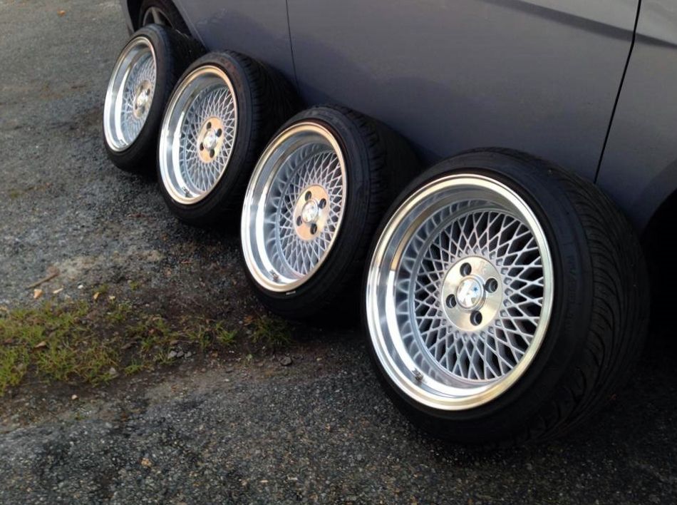

Interesting read this, I thought 8" would catch on the front coz I had. 7.5 x 17 that rubbed on my last e30
Makes this "one day item" a possibility.....
http://www.3sdm.co.uk/collection/wheel-005.php
