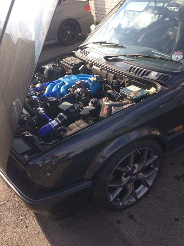

finally figured that the suspension is e36... and the alloys were bbs rx 204
so, I changed the alloys for some new bbs sr wheels. pics on the car (I know they are not to everyones taste - but neither is turboing a cab - lol).

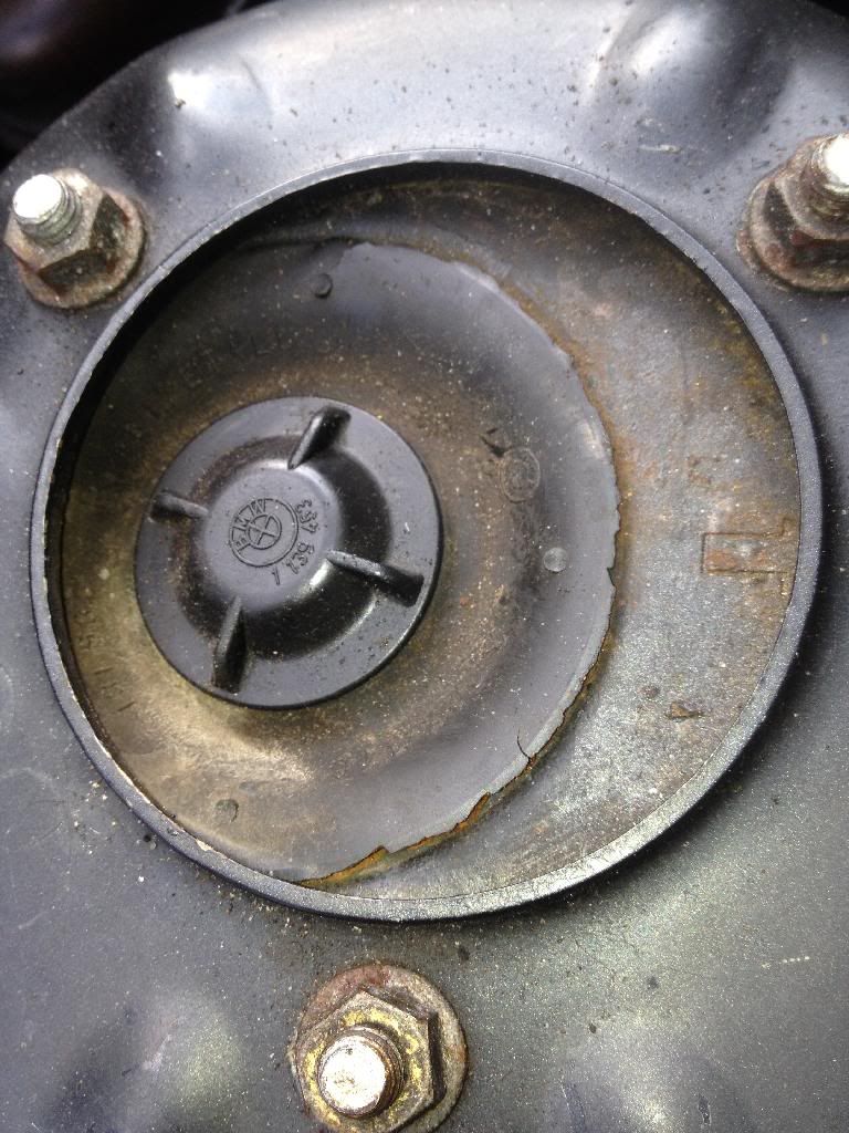

but I now have another problem, the drivers side front suspension top mounts are worn - completely..
the part number looks like 2247 346 - which I have looked up a little and of course is from an e36 - so are these the right ones to buy - http://www.ebay.co.uk/itm/Front-Top-Str ... 565d7f034c
