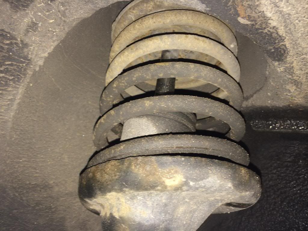

Before I start - I have searched and searched for various information and come up a bit blank. I have also attempted to measure my struts but since my jack died (and waiting for a mate who is free) Ive struggled to get around the wheel to get a good idea of what the set up is.
Basically I have a D reg Mala green 320i (see new members post a few days ago). I want to keep it stock standard bar the set of lenso bsx 15" i bought and the ride height of course, the arch gap makes me sad. :cry:
However, im confused. ...
Ive tried measuring the struts themselves but it appears i need to measure the diameter IN the strut cup (where the spring sits?) - well there is a piece of foam or something that is around the strut at the moment and I cannot move it for love nor money. See Pics below.
So obviously, the answer is to get the wheel off and have a proper look but before I do so, im hoping someone might be able to give me a better idea of

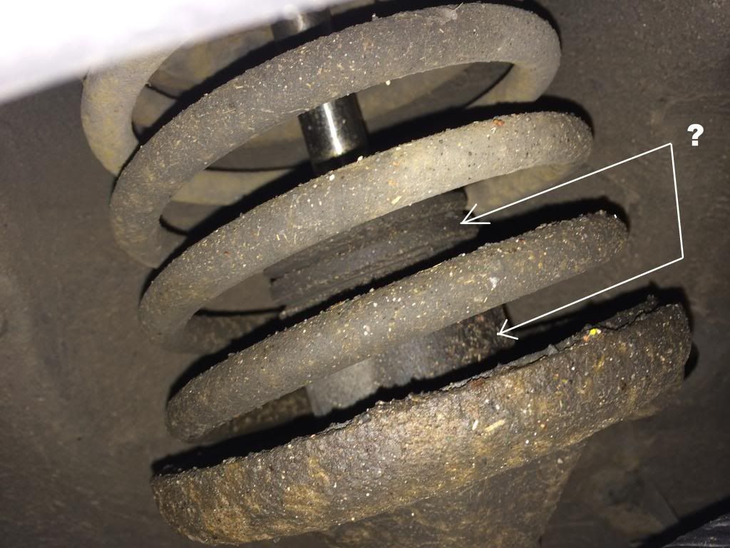

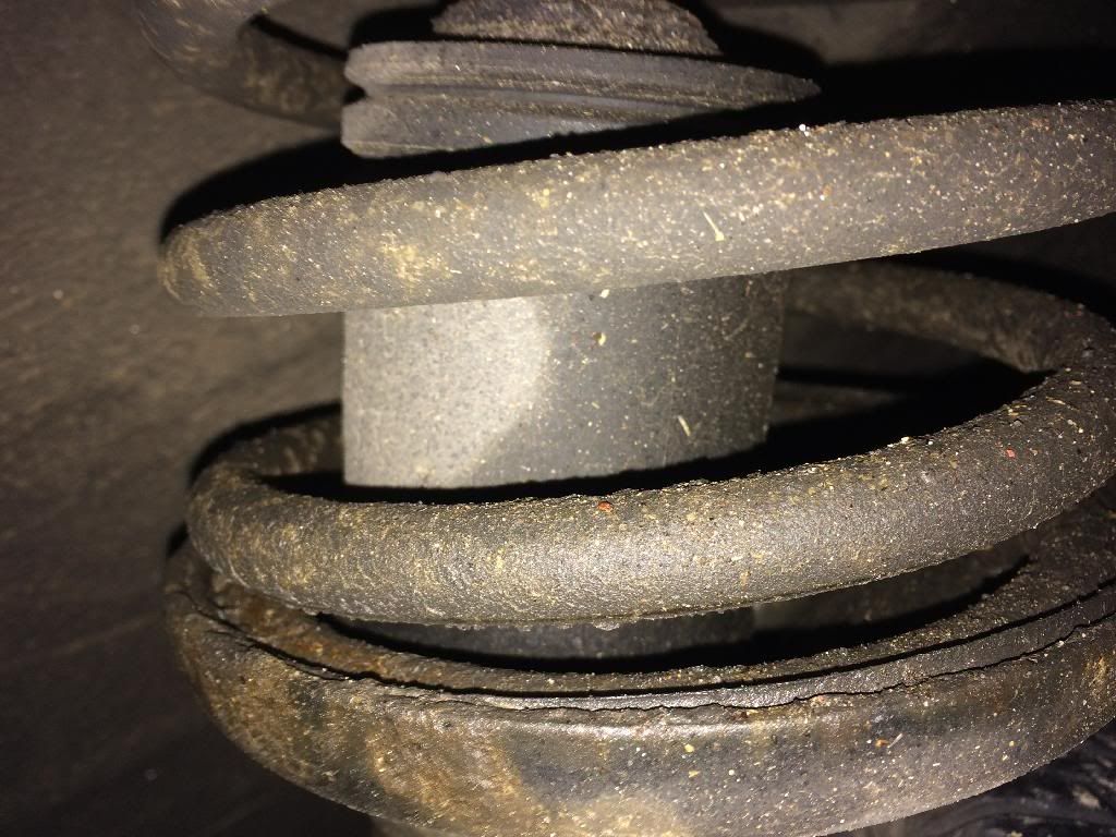

a) what that foam cover thing is?
b) how to remove it
c) whether i should remove it(!) and
d) what diameter my struts might be!

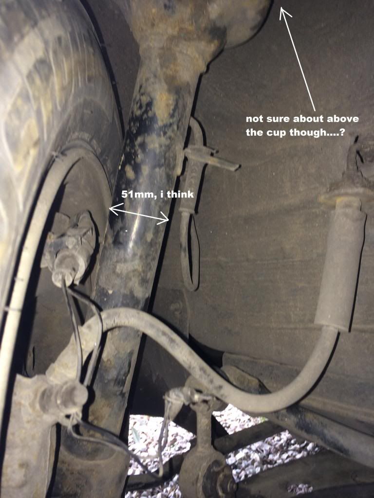

The main strut attached to the hub appears to be 51mm diameter...see below....
but presumably on some models the strut above the cup fits inside this main strut that meets the hub?
My friend has used e36 compact adjustable suspension and his original shocks, but presumably i need to be definite about the diameter.
Any help greatly appreciated
A bit confused! :x

foam things a bump stop, if your suspension ever bottoms out... why do you wanna know the size of your shocks? if there oem, then you can easily get a standard replacement from ecp or somewhere,
arch gaps are bigger / higher i think on pre cars, and even with a rear 40mm drop you will still get a bit of a gap,

bmw9818 wrote:foam things a bump stop, if your suspension ever bottoms out... why do you wanna know the size of your shocks? if there oem, then you can easily get a standard replacement from ecp or somewhere,
Hi thanks for the much more constructive reply. I didnt know they were bump stops. I'm not a mechanic and have only limited mechanical knowledge. Suspension is not something I've dealt with before and this is my first e30.
The gap doesnt matter im not slamming it, i just want to reduce t and improve the ride.

Just to be clear, I have done this. (hence the 51mm on the picture). What I thought i had explained is that i am not sure if that is the right place to measure. Its not rocket science I appreciate but this is.....(for the third time) my first e30 and my first playing with suspension.

:D Your struts are 51mm, there is 2 sizes, 45mm an 51mm. 4 cyl cars and 6cyl/tourings had different ones. Lots of info on the wiki too (written by grrmachine winkeye )

A D plate 320i could've been on 45mm or 51mm struts. Put the last 7 digits of the VIN into Realoem or BMWfans to be sure what your car left the factor with... although anything could've been changed over the last 25+ years.
If you've measured it at 51mm as in your 2nd pic, it may will be a 51mm strut, a 45mm is easily seen even using a ruler and eye - that said, it will be much easier without the wheel on.

A 320i saloon will only have 51mm struts if it has rear discs and ABS.
No ABS, No 51mm struts.
It's that simple.

JF008 wrote::D Your struts are 51mm, there is 2 sizes, 45mm an 51mm. 4 cyl cars and 6cyl/tourings had different ones. Lots of info on the wiki too (written by grrmachine winkeye )
Not true, 320i 4 dr/2dr had 45mm struts...
From what I gather:
All tourings and factory Cabriolet had 51mm struts, rear discs (touring larger calipers) and F&R ARB's
All 325i cars the same as above
All 323i Cars the same as above
All 318is Cars the same as above
Everything else, 316i, 318i, 320i (except the tourings and Cabs) had shitty 45mm struts and drum rear brakes.
I have had one random exception to the rule, a 320i 1990 4 door with factory rear discs and 45mm struts.
Other than that, unless someone has been messing about with it I believe this is correct?
Well at the very least, this justifies my confusion. I have drum brakes at the rear 100% so that suggests i have 45mm struts at the front. Bugger!

The 51mm or 45mm is the diameter of the strut insert that fits down inside the suspension leg where you have tried to measure, hence the confusion measuring the outside dia of the suspension leg. I suspect it will be 45mm on your car, as per the info above. If you put the last 7 of your chassis number into: http://www.realoem.com/bmw/select.do and look under front axle you will see this front shock insert and the parts list should confirm the diameter of insert.
As per my reply on the new members section I would recommend upgrading to 51mm legs anyway if you are fitting an E34 engine in the future, to cope with the extra weight and power. Hope this helps.

78gizmo wrote:The 51mm or 45mm is the diameter of the strut insert that fits down inside the suspension leg where you have tried to measure, hence the confusion measuring the outside dia of the suspension leg. I suspect it will be 45mm on your car, as per the info above. If you put the last 7 of your chassis number into: http://www.realoem.com/bmw/select.do and look under front axle you will see this front shock insert and the parts list should confirm the diameter of insert.
Extremely helpful thank you for your reply! :)
Brianmoooore
Posts: 49358
Tue Feb 11, 2014 7:47 pm
Would be, if not for the fact that it's totally incorrect!
45mm and 51mm are the OUTSIDE diameters of the strut tubes, all the way from the spring perch to the hub.
