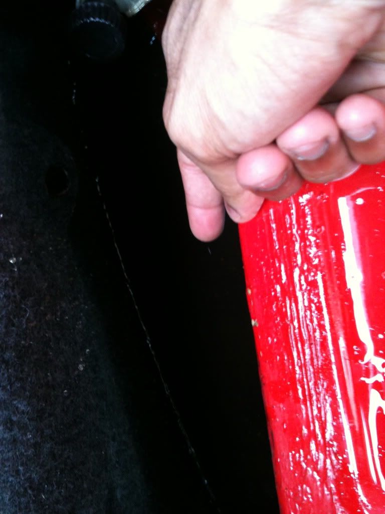

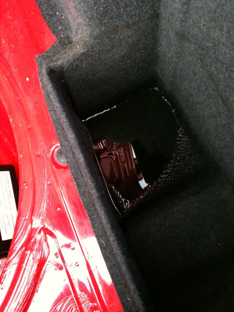

hey guys...wondering if someone can help me out. a week ago i realised my boot was completely drenched in water... i thought it was my waterbottles that might have leaked or something... since i cleaned it up the boot has been empty, only the carpets and my subwoofer in there. yet i opened the boot today and found the boot full of water again...
anyone know how the water could be getting in??? the sills are in perfect condition. could it be the little air flaps behind the carpet opening due to my sub???? i have no idea... neeed urgent help...

thanks for the help guys.... found the problem... its the new lights i fitted..the gasket is leaving huge gaps alowing water to just seep through..!!!! going to try and fix it tomorrow with my dads DIY approach with aerodite... see if that solves it... if not then holes it is....
thanks again fellas!!!!
