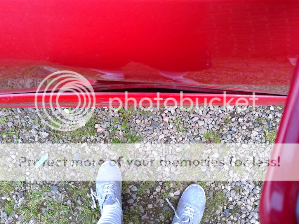

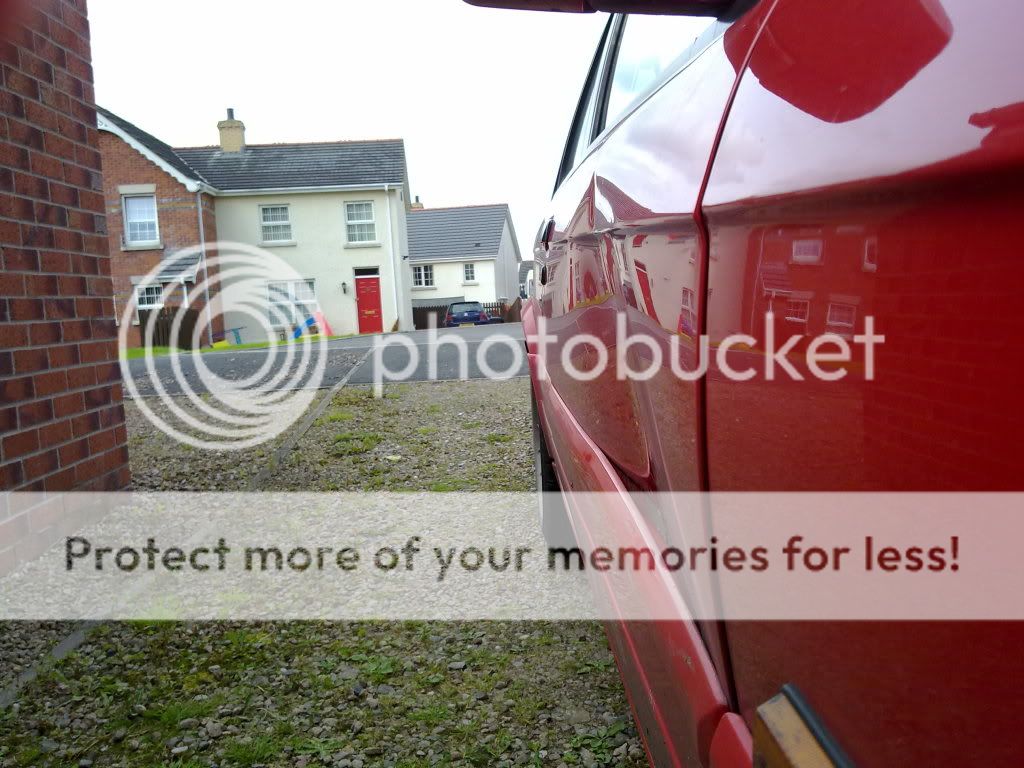

Got a nice dent on my drivers side door today, i would rather repair the door i have then replace it,
anyone know if its a big job, cost? anybody had anything similiar? its about an inch pushed in at the worst point..
heres a pic
cheers andy

A solution is to use PDR (Paintless Dent Removal, you can google it if you don`t know about it) if you find a PDR specialist around you, but if you find a cheap and decent door, change it.

That is fixable and will usually be a nicer finish than a replacement door (sod that).

It's a shame there's a crease because the dent may have just popped out but it looks like it will need a touch of filler to finish it and a bit of painting.

As toby has mentioned, the crease on the door line will never come out good enough. Happened to my mates old TT and even audi couldnt do anything with the crease.

The chances of getting a colour match are the square root of f*ck all. Your car will have been painted at some point, and so will the door you buy - it's pretty much guaranteed.
A very good dent man will make a decent job of that. Once the main big dent is popped out (let them do it!) they can sort the crease above the waistline.
If you do replace the door, expect to have to paint the whole side of the car or at least blend it into the front and rear wings and laquer it (not recommended as the red will fade under the laquer).
