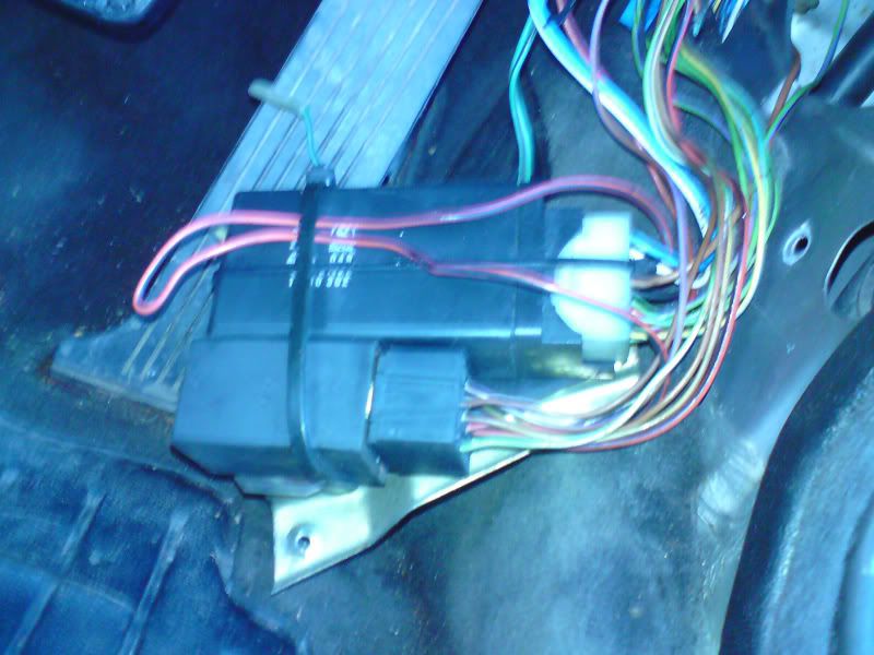

I've been stripping my Tech 1 Sport today and found a relay next to the central locking relay i've never seen before;
Doesn't look 100% factory fitted with the nice cable ties holding everything together but it has a BMW part number. Any ideas what this is for?

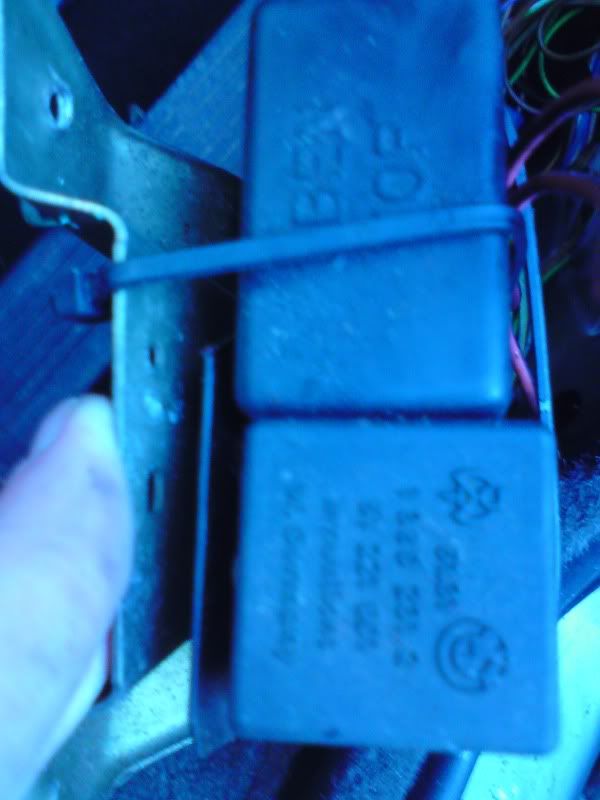

My photography skills have made that pretty much unreadable and i can't be arsed to go outside now. Been out there all day.

ah the small one is for the int light delay mainly fitted to se models @ a guess as i have just removed one from a 325ise and it will go in my car now :D
all e30's have the plug but not the relay it's self.

Interior light delay relay, unkindly cable tied.

Yep,that's a BMW interior light relay,possibly retro fitted at some time,although I was inside a fusebox the other day and found cable ties there as well!
My interior light delay units were supplied by a zoner in the states,George,I think....still working after several moves!

The 'relay' should be mounted on that plate, beside the locking ECU, but not by cable ties.
The locking ECU should be fitted by screws, and the bracket fixed to the shell, as it contains an impact sensor, which ensures the doors unlock in the event of a crash.
To retrofit one you need to rearrange a nearby plug into a different socket, and make a small modification to connect both inputs of the module together. This is because an OE set up will also have a trigger switch built into the drivers exterior door handle, and few retrofits bother with this.
