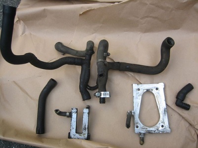

A lot of the pipes used here are leftovers from an E36 M42 installation, cut to fit, which means no part numbers are provided. Be creative.

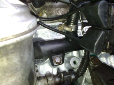

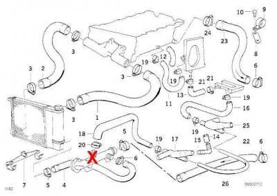

5. Remove lower inlet manifold. I left the fuel lines attached and moved it just enough to reach the plastic pipe on the block (marked X in this diagram).
6. Remove the hose that feeds hot water up to the throttle heater (part 18 in the diagram above) from the plastic pipe on the side of the engine .

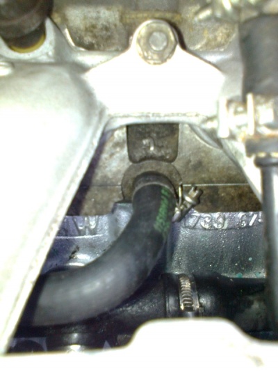

7. Replace this pipe with the one from the same position on an E36. Cut off the last 90° bend from the top. Part number is 11511739245 (needs checking). This hose has an 16mm opening at the end that connects to the plastic pipe and 10mm where it connects to the block.
8. With the 90° bend cut off the 10mm end you can now fix this hose with Jubilee clips from the plastic pipe to the metal stub between cylinders 2 and 3.

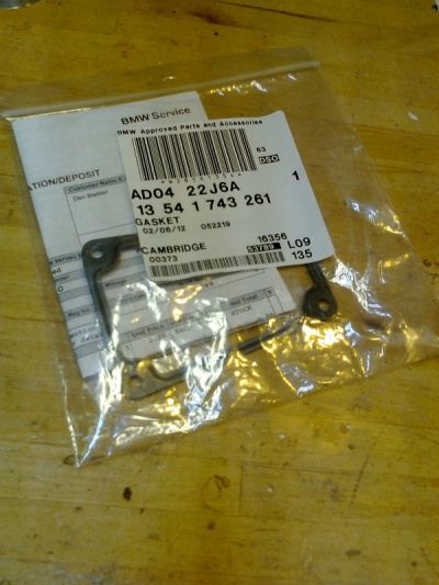

10. Refit upper manifold and put the TB in place but not fixed. This makes connecting the rest of the hoses easier. I installed a new gasket.

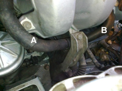

11. Route a hose from the front of the engine to the brass stub on the underside of the TB. I used the original E30 hose at the front of the engine (A in the photo), one straight connector and a piece of E36 hose from my scrap box (B in the photo).

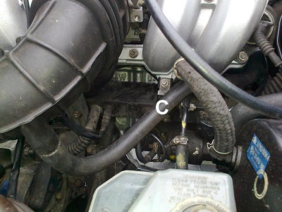

12. The ICV needs a hose routed from the back of the engine to the rubber boot attached to the TB. I used one length of E36 hose cut down (C in the photo) and a straight connector into the boot . I don't have a part number for this piece.
