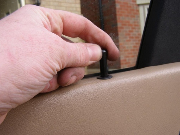

Remove the lock indicator by unscrewing

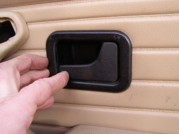

Remove the door handle surround by sliding to the right

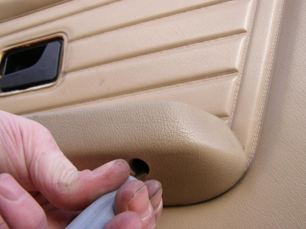

Remove the two screws in the arm rest

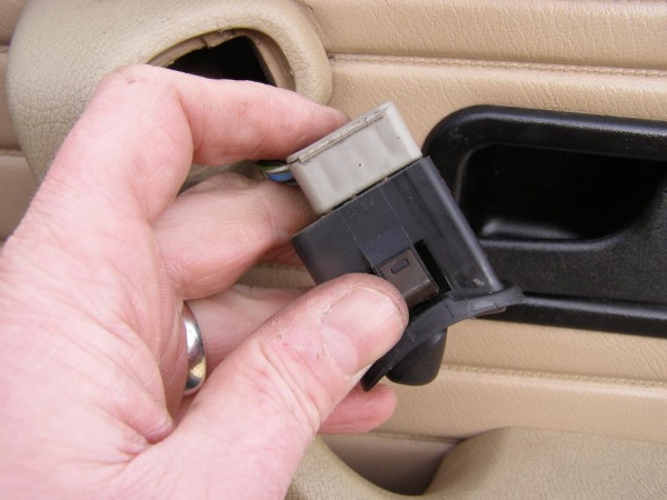

Remove the electric mirror switch

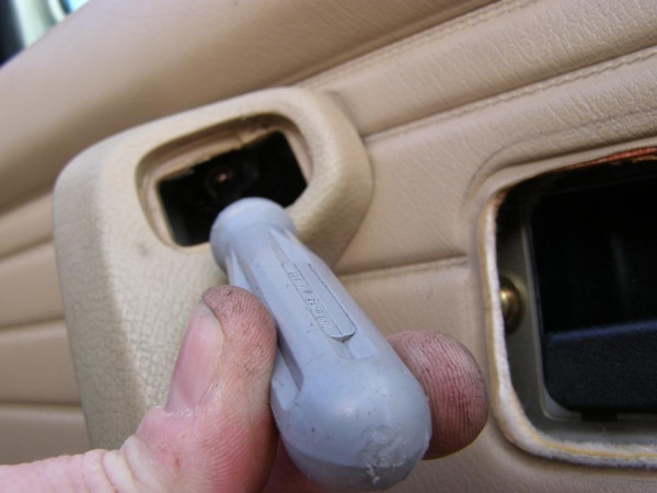

Remove the final screw in the recess behind the mirror switch
