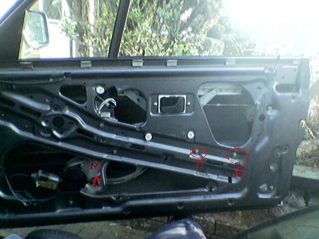

Once you've done that, familiarise yourself with the adjustment points on an E30.
Then follow this handy guide for adjusting the runners and mechanism.
