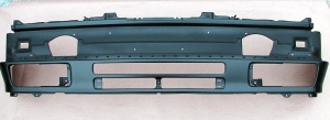

Front Valance
The Front Valance makes up the front end of the E30's Bodywork. It is a detachable, bolt-on panel which sits behind the bumpers and carries the front foglights, if fitted. It also includes holes and channels to provide air to the radiator and the optional oil cooler. For vehicles fitted with air-conditioning, a special valance was fitted with a larger central hole.
Two types of front valance were fitted, depending on the age of the car. Cars of 1987 and before, known as pre-facelift, were fitted with the earlier style valance which has square cut-outs for the foglights. Vehicles after September 1987, known as facelift, have the later valance which carries different foglights as well as ducting to cool the front brakes.
It is possible to swap between these two valances, since the dimensions are the same, but this will also necessitate a change in bumpers. Each type of valance also determines what sort of body kit can be fitted to the car.
