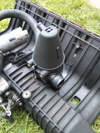

Fitting of Oil Separator Valve
Drill a hole into the intake manifold corresponding to the size in in the original. Fit the original rubber seal and press the oil separator valve in.

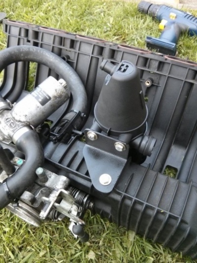

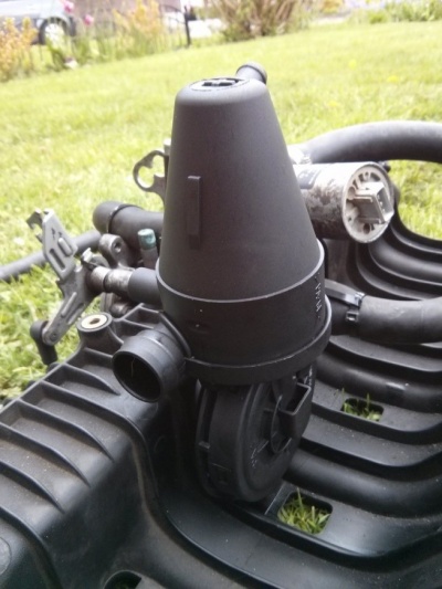

Refer to pics below showing the valve fitted to the M50 manifold:
If you have drilled the hole correctly, the valve should be a tight fit and not need a bracket to secure it from falling out. But you can make a bracket for piece of mind..

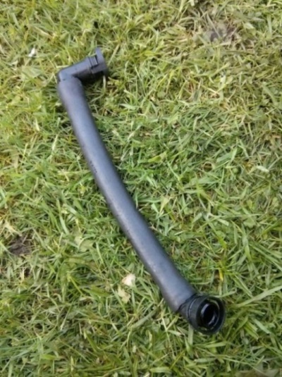

The pipework will be the same as in the original: the bottom hole in the separator to the drain in the dipstick tube and the upper to the rocker cover. You can make up a custom pipe to suit using the connectors from the OEM pipe and some oil resistant piping, like so..
