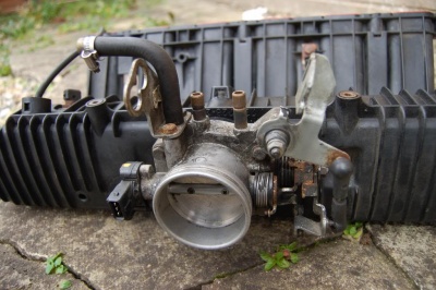

Here we have the M50 inlet manifold with M50 throttle body. What you are looking at is the underside of the manifold, showing the hole in the centre that the ICV pipe connects to. The plug sensor is for the air inlet temp sensor and the thin rubber pipe is what connects to the fuel pressure regulator.
This pic is a close up of the throttle body. Note the inlet and outlet at the bottom (it's upside down in this pic); these are the inlet and outlet for coolant for the throttle body heating which are not needed and can just be left open like in this pic. Note also the bit of bent rubber hose. This is on a connector which needs to be blanked off, so there's a bolt in the end and a jubilee around it to seal.

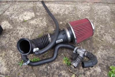

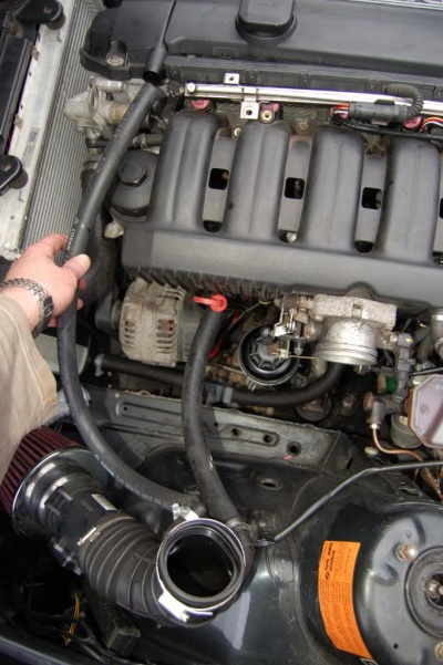

This is showing the MAF sensor and inlet elbow, which is from an E34 525i. It has two inlets on the bottom of it. One of them connects to the crank case breather (the long hose) the other one connects to the Idle Control Valve (pictured)
On a 328i there is a cylindrical shaped oil separator valve that plugs into the inlet bellows and is on the end of the hose that comes from the crank case breather. You can dump that and just replace it with a length of heater hose like I have done above. This is recommended if the car is mainly used on the track. However, if the car is mainly used on the road, fitting of this oil separator valve is recommended. This process will be shown further down in the article.

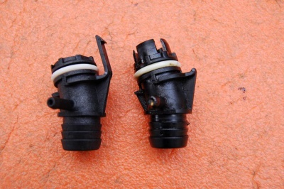

This is the connector which fits at the end of the swan neck shaped pipe that comes from the idle to control valve and goes into the port in the centre of the inlet manifold shown in the first pic. Mine had a snapped off retaining tab, so I got a new one as I thought this may be moving about a little and giving me an air leak/ occasional hunt at idle. I've fitted it and even still they are a pretty crap fit. The little nipple on the side needs blanking off.

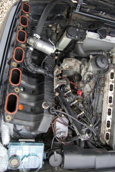

This pic shows the inlet manifold getting ready to be fitted. The ICV and plumbing is connected.

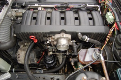

Fitting it just involves dropping it on the studs. My gaskets on the inlet manifold were replaced when I fitted out the touring, worth replacing yours and checking ALL vacuum pipes to avoid crap running and future dramas.

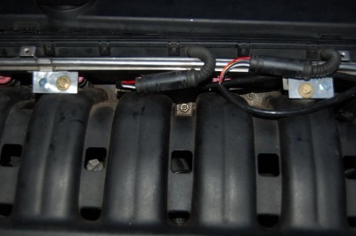

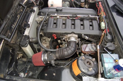

Manifold now in place. Fuel rail and injectors pushed in, note the brass fittings on the top of the manifold next to the mounting tabs on the fuel rail. They don't line up. The throttle cable (E34 525i) has been fitted, throttle position sensor connected up. Also remember to connect up the 2 pin air temp sensor underneath (shown in first pic). Servo vacuum pipe connected up (clio servo)
This shot has been taken to show the pipes that connect to the underside of the inlet bellows. The long pipe on the left is connected to the crank case breather outlet on the cam cover at the top of the pic. The other pipe is what comes from the Idle Control Valve.

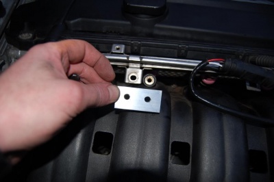

You can use the M50 fuel rail that fits into your inlet manifold, but you still have to use the M52 pink injectors. If you want to keep your M52 fuel rail, you'll need to make up some tabs to secure it, since the M52 fuel rail doesn't line up to the mounting tabs on the M50 inlet. So the solution is to knock up some brackets. I just used some aluminium plate and drilled two holes.
This holds the fuel rail in place. And they look like this. You can obviously do a smarter job if you're that way inclined, but this lot is covered by the plastic cover that fits over the top.

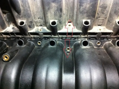

This is the method used by DanThe: Drill a hole into the intake manifold corresponding to the size in in the original. Fit the original rubber seal and press the oil separator valve in. If you have drilled the hole correctly, the valve should be a tight fit and not need a bracket to secure it from falling out. The pipework will be the same as in the original: the bottom hole in the separator to the drain in the dipstick tube and the upper to the intake rubber bellows. Refer to pics below showing the valve fitted to the M50 manifold: img..
