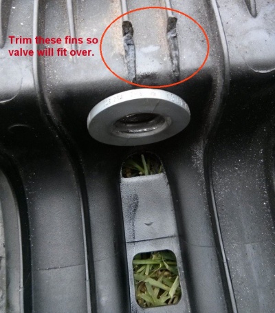

Fitting of Oil Separator Valve
This is the method used by DanThe: Drill a hole into the intake manifold corresponding to the size in in the original. Fit the original rubber seal and press the oil separator valve in. If you have drilled the hole correctly, the valve should be a tight fit and not need a bracket to secure it from falling out. The pipework will be the same as in the original: the bottom hole in the separator to the drain in the dipstick tube and the upper to the intake rubber bellows. Refer to pics below showing the valve fitted to the M50 manifold:
