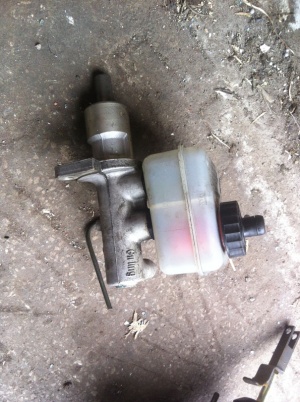

If you've recently upgraded your brakes by fitting some E34 calipers, then you'll need a bigger master cylinder to push all that extra fluid around.
Here's how to install the Master Cylinder and servo from the mighty E32 7-series.
Parts
  • E32 735i Servo, Master Cylinder and Reservoir

With the E34 calipers on the front, and potentially bigger brakes on the rear as well, the standard E30 master cylinder isn't big enough to move enough fluid. To get around this, most people use the E32 750i MC but I also wanted more assistance to match. The 750i MC is also becoming increasingly expensive due to its rareity, so I'm opting to use a more mundane E32 735i MC and servo instead. This master cylinder is still 25mm, so should improve the feeling to near stock level
However, a few mods will be needed to make this fit.
The E32 I got mine from had a spacer on the back of the servo. There are two options here:
  1. Use the spacer. This requires the least mods but the brake fluid reservior will be right underneath the inlet boot on the M20 engine, and might not fit.
  2. Ditch the spacer, but make a few mods instead. This involves:
Grinding down and shortening the push rod to put the clevis at its original level Open up 2 holes in the bulkhead Bend the brake lines slightly
I choose number 2 for an original look to the engine bay
