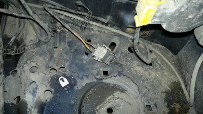

But you will need to find the fittings, which are usually tucked out of place when not used. For the actual lamps, you're looking for two grey plugs hidden somewhere inside the engine bay under the headlamps, often tucked into one of the holes inside the chassis rails. Have a nose around, find the plugs and free them up so that they dangle down behind the valance.
To confirm, the wires to the plugs are brown and yellow/brown for the left side, and brown and yellow/purple for the right side, so find plugs with these coloured wires!

Once they're out, lie on the ground with your head behind the valance, and you should see four square holes in the metalwork around the foglight hole. These are the mounting tabs, and you need to push your plastic screw plugs into the holes, with the ends pointing forwards.
Now offer the foglights up from behind, and get the lenses lined up in the holes. When they're in place, you'll see that the mounting holes on the light frame line up with the mounting tabs, and you can then screw your self-tapping screws into the plastic plugs. It'll look like a less rusty version of this:

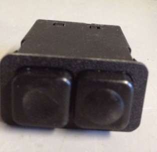

Near your headlight switch should be a large rectangular button which switches on the rear fog lights. You need to replace this with a two-button switch so that you can operate the front foglights too:
This should be a simple matter of either prising it out with a fine blade or screwdriver, or pushing it out from behind if you have removed your kick panel from under the steering column. Pull the old switch off its plug, pop the new switch in, and push the lot back into place.
