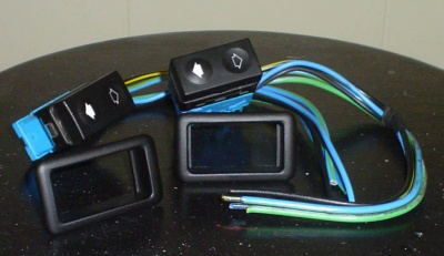

  • 2 WHITE or BLUE base E36 window switches
  • 2 flat E36 window switch bezels

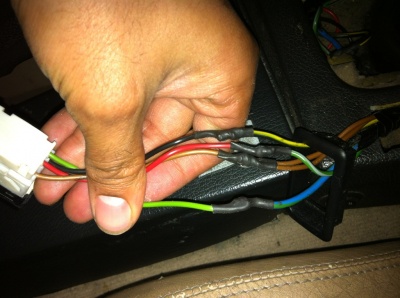

We've come across an issue where the wiring colours differ for white base switches, which makes it very difficult to wire them up to the existing loom. If your switch wires have different colours to the other pictures in this article, then check out these pics which use E36 Convertible plugs:
Front:
Rear:
Notice that these switches only have four wires, while the E30 loom has five. The switches contain a single earth (brown) which needs to be joined to both existing earths per switch.

These are the switches I will be using, along with the new flat bezels I ordered:

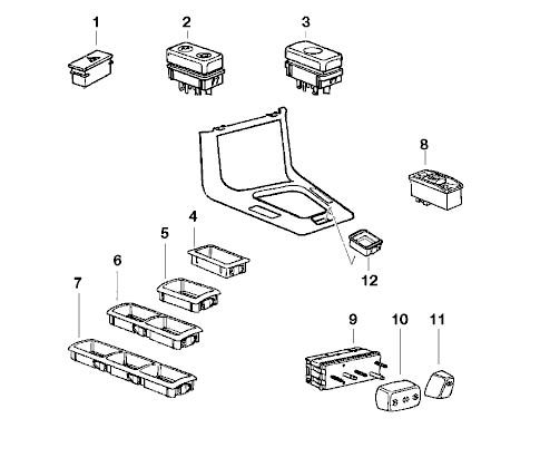

You are going to want to use the flat bezels meant for use in the E36 for the rear seats and the sunroof switch. The reason for this is because the shift console of the E36 is slightly rounded, as are the bezels for the front window switches. These will not sit flat on the E30 shift console, so if you're OCD about this kind of thing like me, order 2 of the flat bezels.
Shown here are the differences of the switch bezels. #5 in the image is the bezel for the E36 shift console, #4 is the flat bezel that you will want.
The part number is 61-31-1-387-996. They will run about $2.25 each from the dealer, but KenCopperwheat from the R3Vlimited forum said that he got them from BMA for about $1.80 each.

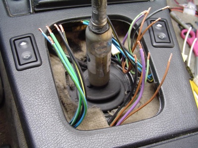

Start by removing your shift boot and setting it aside. This will give you lots of room to work with the wiring. If you want, remove the entire shift console and give yourself plenty of room, that way you won't have to worry about messing up your console. We left it in.

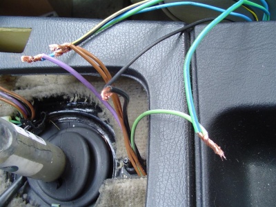

Pop the E30 window switches out and disconnect them from their harnesses. Snip the wires just below the stock E30 harnesses and throw the harnesses away. Strip the covering off of each of the wires at the end about 1/4 to 1/2 of an inch, and do the same with the wires of the E36 switches. The E30 switches will still be perfectly useable, save them in case someone wants to buy them.

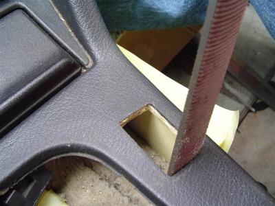

As you've no doubt noticed, the E36 switch bezels are larger than the E30 ones and don't fit in the holes. There's not really anything more to this step then cutting / filing the holes large enough to get the bezels to fit.
I would recommend using files over a Dremel since the amount of material that needs to be removed is not an overly large amount and a Dremel may be too much, but it's up to you.
From this point on, it's just a back and forth process of filing material off of the console and test fitting the bezels. Be careful at this step because you want to make sure that you don't enlarge the holes too much; you want the switches to fit nice and snug, so they don't come out.

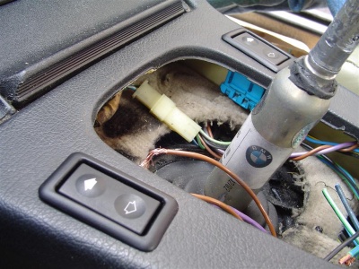

Once you've gotten the opening large enough, snap the switches into the bezels and insert the switches into the holes, feeding the wiring through first, then snapping the whole assembly into place.

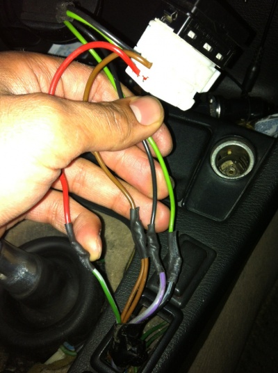

After you've determined which wires are for what in the car and on the E36 switches, test them in the car. Twist the exposed ends of the E36 switch wires and the stock E30 wires together (be sure that none of them are touching other wires), and turn on your key. Test to make sure that the windows go up and down and that everything functions normally. If all has gone right and your windows operate, now it's time to solder them.

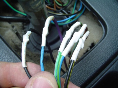

Get your heat shrink tubing and cut 10 pieces about 1-2 inches long. Slide one piece on each of the stock E30 wires and leave them for when you are done soldering.
Before soldering the wires together, you'll want to tin the end of each wire, which is essentially just getting a small amount of solder on the end of each wire. After you've tinned all the wires, get your third hand tool or friend and begin matching up which wires go together. It's good at this point to have your notes ready and with you, so you know which wires go together. Use only enough solder to effectively bond the wiring together. You don't want to use too much since you still have to slide the heat shrink tubing over the exposed ends.

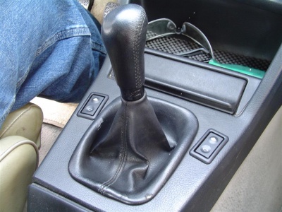

Once you've completed one switch, turn the key on again and double check that the windows still go up and down. Solder the other switch wires together and do the same for the other side. Now, get your lighter and slide the pieces of heat shrink tubing over the soldered connections of the switch wiring. GENTLY heat the tubing so that it shrinks down nice and tight. The wiring is done.
Go through your car, and pick up all the little bits of wiring, and vacuum all the dust from modifying your console. Reinstall your shift boot, straighten everything up, and you're done.
