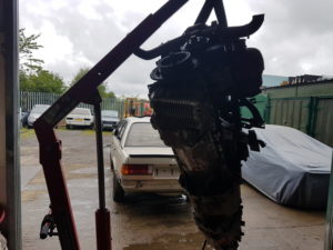

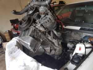

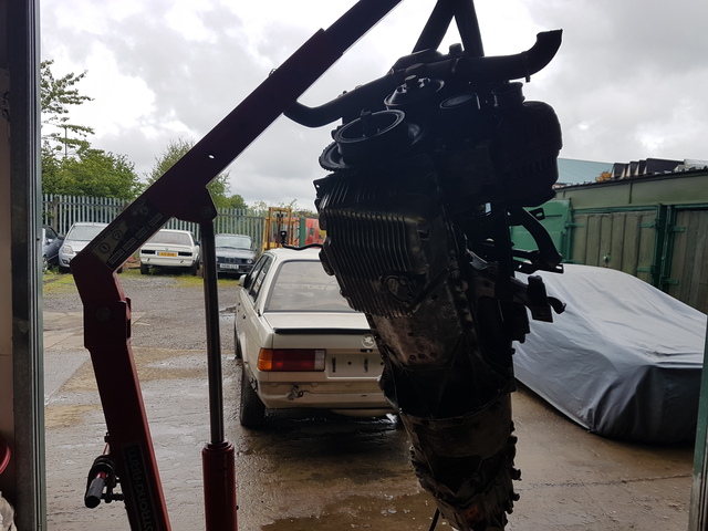

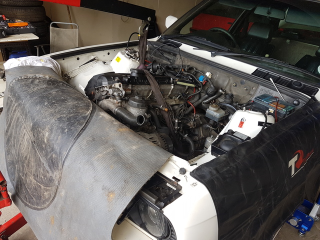

After 2 years Mick removed the m42 and decided to install an m50b25 conversion that came up on the zone sales page, Mick said “I added to this package a lightened m20 flywheel, bbtb, venom chip, and very rare pair of alpina m50 none vanos cams”.
Mick ran the m50 for 2 yrs then converted to m52b28 for a bit with m50 inlet, bbtb and Danthe mapped ecu then had an m5b30 stroker bottom end built up into a spare m52 block, Mick installed that running 244bhp with e36 m3 6-speed box and e30 m3 3.25 diff with 40% lock up mods (bought from BadDave an old mod on here), a full stainless exhaust including manifold made in x2 50mm straight through pipes through out inc manifolds onto modified scorpion le-mans back box .
