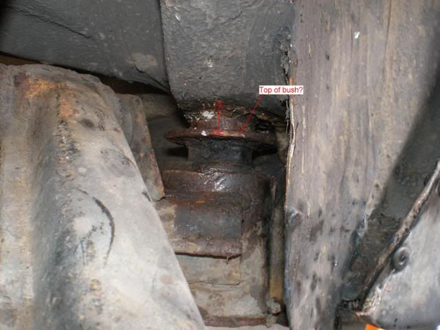

Ok between the rain showers I've removed the bolt from the centre of the bushes and I'm trying to release these from the car. I'm a bit confused about what is part of the chassis and what is part of the bush!
In the picture below am I right in thinking the space between the rear beam and the round collar is the bush splitting? (Not what I want?) Do I want to lever the space above this to release the rear beam?
I'm a bit confused as I don't really see whats holding the rear beam to the car still!! Is it just rust? Please can someone explain a bit more?! (Sorry for all the thick questions - I've never seen a rear beam off the car so can't pitcure what I'm trying to pry apart!)

Yes mate, 20 years of rust holding that baby in there!! :(
If you look in Smithys pic at the bushes, you should get an idea of what is coming off.
That flat round bit is a big washer, and not actually part of the bush itself.
If you have taken the big nut off, and the long bolt out, if you look down through the bolt hole from the top, the bottom 3rd of the bolt hole is part of the bush and 'should' come away!!
To get mine off I had to put the wheel back on and kick the tyre back and forth (and down)
Out of the 2 beams I have taken off, 2 out of 4 of the bushes have snapped in the car :x
