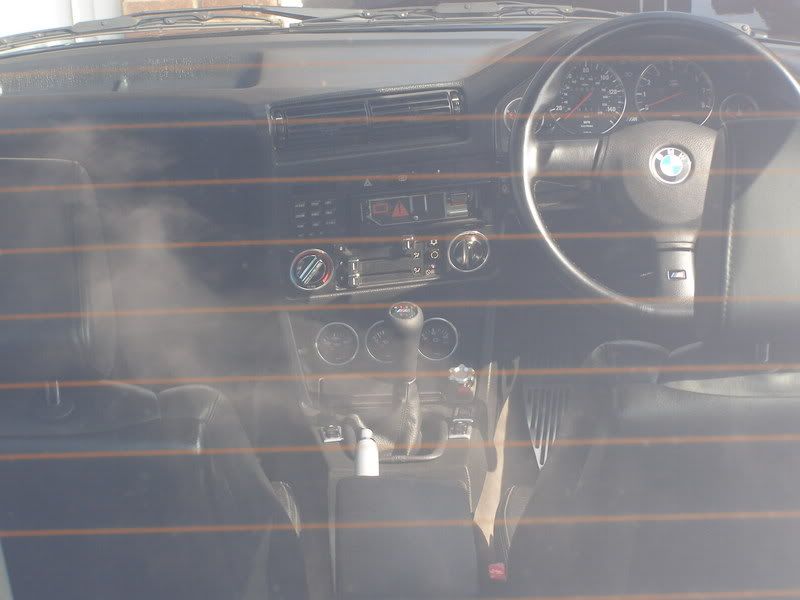

Anyone fitted these? Was just wondering how they wired them up and what oil pressure sender they used and how\where they mounted it?
Here`s a pic
Here`s a pic

I have a set of these i was gonna fit too. Was going to put them in place of the front ashtray, voltmeter is obviosly easy to wire in, i believe you can get an oil temp sender unit which also acts as a sump plug?

As said the volts were easy. I believe for the oil pressure you need to make a tpiece of some sorts. I planned to use a mini pressure switch and to get a thread adapter made up and do it that way but have never got around to it also. The oil temperature can go in place of the sump plug; i think the m3 switch is the same thread as the m20 sump plug thread but dont quote me on that. in the m42 there is a provision in the back of the head for an oil temp. gauge sensor.

I already have the oil temp sender in teh sump plug for my M3 instrument cluster and as you say the volts are easy.
It's the oil pressure I was wondering about.
Dan: If you don't need the pressure unit then it would be a big help to me. I'll PM you my address dude.
I wonder where I could get a t-piece made up? Would the t-piece fit into the sump plug? I don't want to overcrowd this area. I know there's a bolt in the block up near the oil filter somewhere but I think there have been problems trying to directly fit the senders here because of the location.

I also remember reading about someone fitting a pressure switch near the filter housing somewhere but im not all to familier with m20s as im still in four pot poverty person. Pm me your address and when i go home il send it to ya mate.E30Adam wrote:

There is an alum key bolt in the back of the head near the bolthead which can be removed; and an m3 oil temp. sender threads straight in but you need to use three washers to space out the sensor so you do not block the oilway.darren318is wrote:what temp sender can bve used in the m42 in the hole in the back???

The place must of the turbo boys run theirs as far as i know, and i also ran mine was off a T-piece made up off the oil pressure switch. You remove the oil pressure switch, make up a T piece that will go onto the block, with the correct size fitting for you gauge tapped into it and also one to retain your oil pressure switch. The oil pressure switch size is m12 x 1.5mm thread. A real pain in the arse basically, not a size really used in the UK tbh.
So basically you will need both a 12x1.5 mm tap and die, or someone that can make such an item up for you.
This is the location dan is talking about.

im not sure about the thread being foreign dude; its the same thread used on the small case diffs ( and probably medium case ones too) at the back to hold them into the subframe; m12 x 1.5 x 25. I grant you though i dont think iv ever seen a die that size. A machine shop should be able to knock it up though. What pressure switch did you use fela?
If i had the mini one here adam i would tell you the thread of that (well, try), but i dont

Now then mate.I told you how to do this ages ago,cant believe you still haven't fitted them
You can tap into the wiring for the temp sender as i have for the m3 cluster.
for the pressure sender i used the Audi one.A t peice needs fitting where the original oil pressure switch goes.The audi unit has the oil light switch on it aswell as the pressure sender, so you can do away with the original bmw pressure light switch.If you leave the oil temp sender in the sump then you can block the end of the t peice with a sump plug.But if you fit the temp sender at the t peice then you need an extension fitting which i made from brass.
Pictures below explain more.
For those wondering ,why fit the t piece if using the temp sender in the sump ? Its because where the original oil pressure switch goes its in a recess and the audi sender wont fit,and its a different thread.
You can buy the t peice's for deemon tweeks for less than a tenner.

Well I bought all the parts indoors and made a start on it. I don't have the correct size hole saw so I'm going to take my centre console into work and cut the holes on Monday. How did you fix the guages in once you'd put them through the holes. I might just use some silicone to hole them in then if they need to be removed it can be peeled away unless you have any better ideas?

have you seen the VDO gauge holders that covers up the small gap just above the front ashtray surround?
think thats the proper way to do it well rare though;
The way i was going to do it was to remove the two centre air vents, make a temtaplate to fit the gauges in there and then bolt them in that way but never got around to it.
Pic of the VDO gauge thing:

i actually used the audi facia pannel as i dont like the boggle eyed type look when the gauges are fitted by themselves.So basically ,i just cut a rectangular hole and fastend the panel back using the audi fixings.
Silicone would probably be ok,infact if you make the holes really tight you may not need anything on them.Cant beat a nice tight hole

Good thinking, I think the tight option should work ok.buster wrote:i actually used the audi facia pannel as i dont like the boggle eyed type look when the gauges are fitted by themselves.So basically ,i just cut a rectangular hole and fastend the panel back using the audi fixings.
I've put a couple of pics up in the photo gallery of the car with RC's on!!

Just to get this right in my thick skull,the tee piece needed to fit an oil pressure gauge is a stock item from Demon Tweaks?I presume that the oil pressure light switch is just an on/off switch?

Apparently so, I can't find it on there. Has anyone got a part number or a link so that I can order it?daimlerman wrote:Just to get this right in my thick skull,the tee piece needed to fit an oil pressure gauge is a stock item from Demon Tweaks?I presume that the oil pressure light switch is just an on/off switch?

so to clarify - for some reason i fond it confusing;
i need a t-piece which is basicly m12 x 1.5mm thread to screw into the block, and again it must be bored out to accept m12 x 1.5mm thread as thats what the bmw unit is, now what m and mm should i bore out of the side of the t-piece for the audio pressure sensor? does anyone know its size?
Sorry to drag this thread back up, but it just proves the power of the search function!!! I was looking for the right fitting for my VDO gauges (thanks Buster^).
The right 'Mocal' fitting is available from Demon Tweeks Part number MOCTP6. What a right old ballavhe it was finding it! Demon Tweeks' website isn't the most informative
