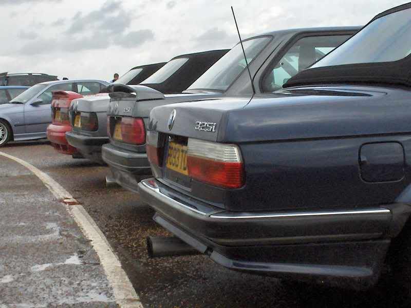

I have yet to see a cab with the later rear lights, even stevetiggers cab, J plate, has the early rear lights.
d6dph
- Posts: 12435
- Location: Tiptree. Essex
Lee (essexboy) has late rear lights and i think Malc has too?
d6dph
- Posts: 12435
Yup, Malcs has late lights (third from camera)
Rosc0PColtrane
- Posts: 9757
Seen both sets of lights on j plate, late lights on K plate.
