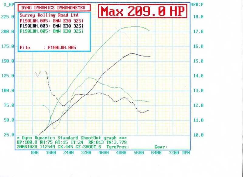

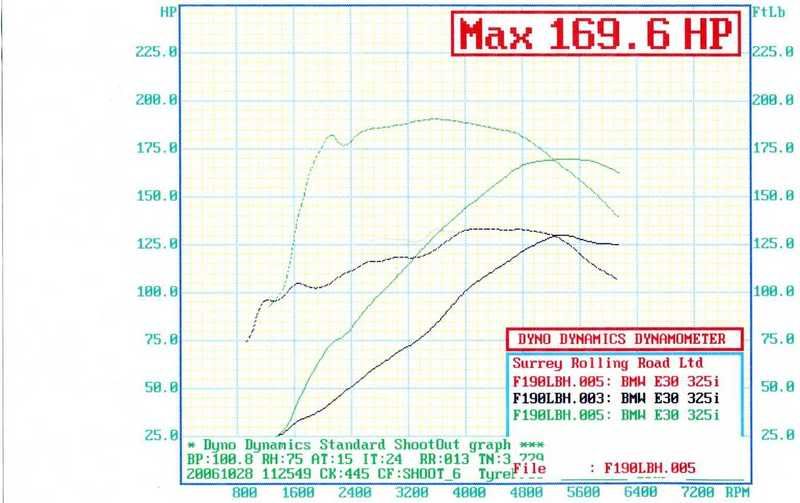

This is meant to be a 75 hp one shot wet system, but falls quite shy of 75bhp although torque is not bad winkeye, the system is activated only on full throttle by a mirco switch on the throttle body only if the arming switch is armed. It took less than 2 hours to install.

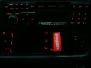

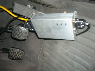

Arming Button

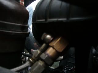

Fuel & Nitrous Solenoids

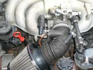

Fogger, located under rubber intake elbow
Dyno with MegaSquirt std motor exhaust & Manifold 169k mls
Dyno with NOS
Dyno AFRs with & without NOS

the torque is good see graphs above, comes in in a real kick in the arse, won't be at ants but guilford on the 8th, see you there :D

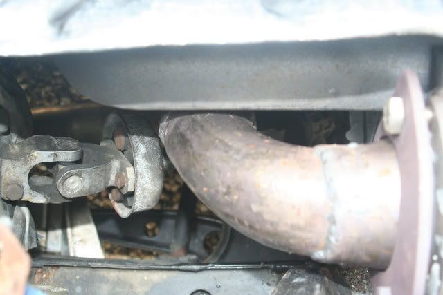

I found the down pipe the hardest thing to do, lots tacking welding back & forth to my local pipe bender, it is 2.5" stainless joints were be tiged but gave up & all joints were migged in the end. A Y-peice was formed to mate to the standard exhaust system, this car is sooo quite :cry:

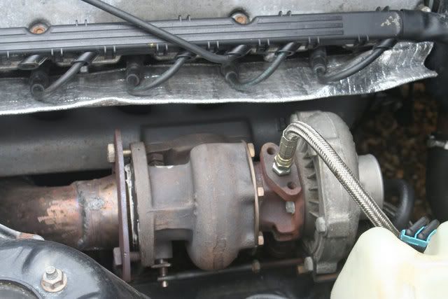

Ants old turbo t3/4 hybrid mated to the BBR log,

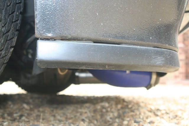

Intercooler sits a bit low, hit a bump 10feet from my house on it's first boosted run and clonked the bottom of it ripped a piece of metal off it :cry: , any way it doesn't leak and it's a bit lighter winkeye

Looking good, I too have a stray charge pipe sticking out from the under the front valence!
IS lip spoiler should cover it up fine :D

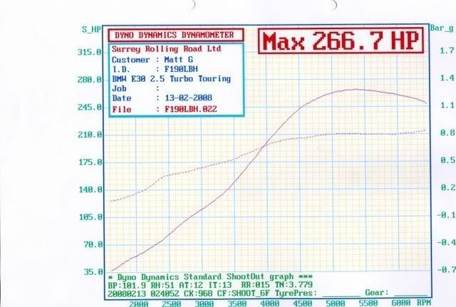

Fri Feb 15, 2008 12:13 am
Hi guys,
It's been a while since I've had anything worth mentioning (if ever) about Exxon but here's where she's at.

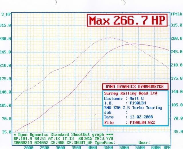

Anyway Exxon spent the last couple of days with Ant at the A-Tech workshop & Surrey Rolling Road,
Ant fitted a set of 42lb injectors & added a wasted spark setup to the Megasquirt ECU.
Then we took it for a 3 or 4 short blasts for a bit of logging, mapping & BOOOST adjusting.
I was quite amazed how much power the car now has pulling smooth & very hard, but the clutch was not happy giving up the ghost at any WOT at 3.5k upwards, any way drove it home safe & sound, exploring the point were the clutch slips.
The next day I gave the car a quick clean & made my way to meeting point with the usual suspects & onto Surrey Rolling Road for a bit of fine tuning by Ant,
& here we go:-
First Run
Last Run
Boost
AFR
