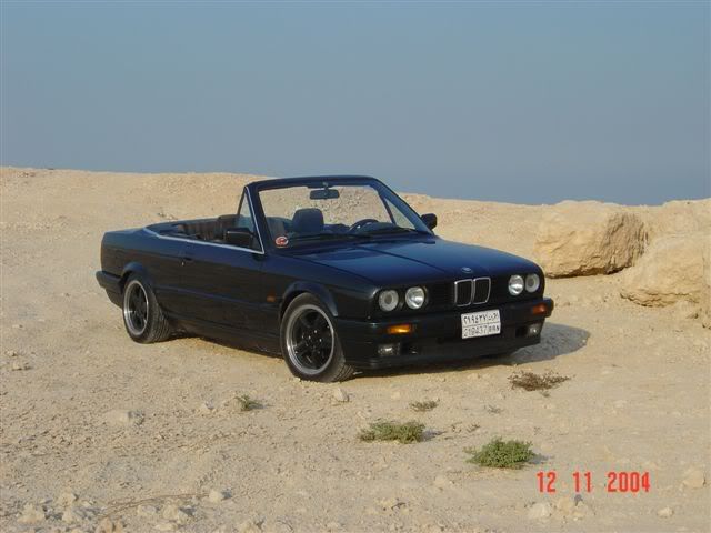

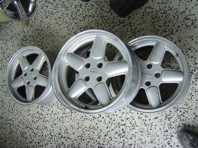

I got a similar set that were quite tired so i took them down to a electrolite plateing shop where they could really do anything from silver coat, powder coat, or paint them to simply polishing them. Heres what i went for.

Mmm. those silver ones look nice. Were these powder coated? The black ones look really good on the black cab too.
I'd like mine to look like the silver ones. My rims don't have a polished lip so i'd get them done all silver, less maintenance. I'm dying to get them on and replace the stock 14"s.

The silver shnitzers are the before picture, a tip though make sure if you spray them to make the guy take the centre caps out otherwise when you come to fit the tyres and take the centre caps out it chips the paint. The aluminium rim does take a lot of work to keep looking good, i use a fine polishing paste and a drill with a softish polishing wheel! takes around 5 mins a wheel, although bootymans would take consiuderably longer, PHAT! :cool: . Dont be temped to lacqure them after polishing thinking it is a short cut, it isnt the lacqure chips and it will tarnish underneath (i know)

I must say this is one of the nicest wheels I've seen!!! Black with polished rim... hmmmmm!! 8)

must confess they do look the mutz nuts but alas not my idea but a mates who had to convince me but once finished they look real good! also if anyone remembers a guy called Adam something who had a white US cab in PBMW about a year ago, he had the M5 rims in a similar colour and that made my mind up!!
