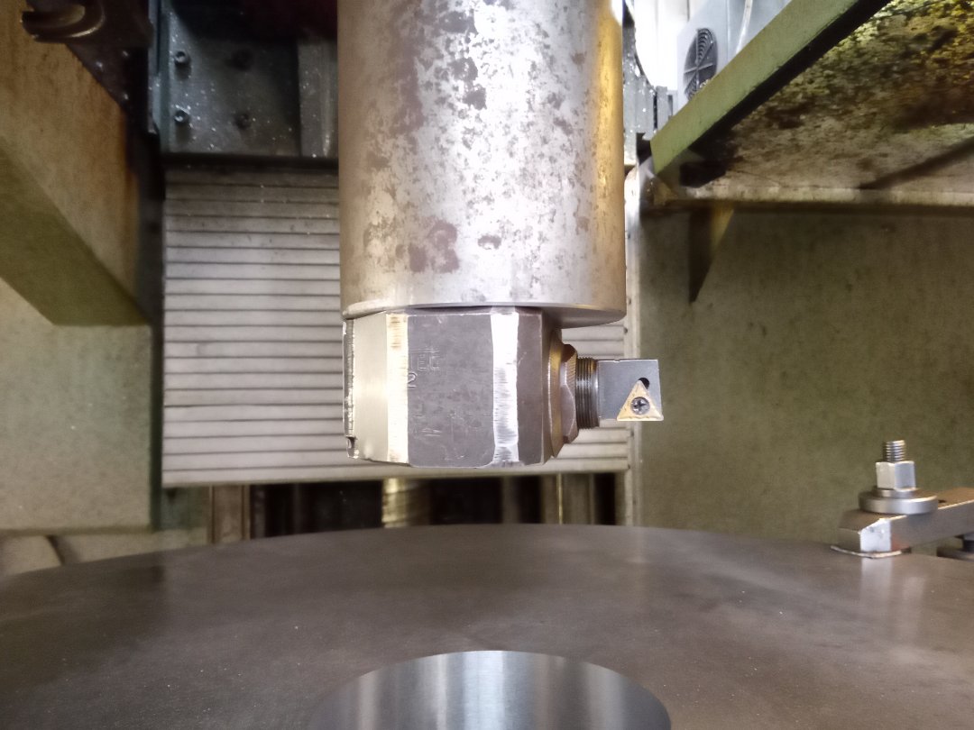

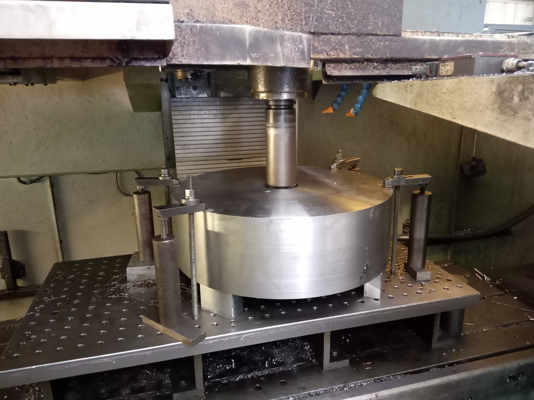

A big lump of @750kg`s EN8 Steel, It`s a blank for a gear @750mm x 250mm and I have the job of boring the centre hole to within 0.06mm 8O
Yeah, no sweat !!
I made this boring bar to be as big and sturdy as possible with a "micro bore bar" for the adjustment.
I took it to within 2mm today and will finish it next week.
The bar has to be in place all weekend and the machine not turned off so to keep the same conditions as today.
Am I being fussy ?, hell yes but that is what gets the job done properly.
My "Lad" set it up , not 100% but strong set up. He had never done stuff like this before and was crapping himself as I had him do all of it.
He did well, I would not have let him do otherwise.

Another gear this time but Cast Iron this time.
1000mm x 200mm six spoke nice casting as well.
Here we are milling out the bore which is cast and rough and hard as hell in places too.
Then I went on to use another boring bar but some arse hole in the past "bodged" it so I lost a few hours trying to find an alternative, hope it works in the morning.
Just under 500kg so not as heavy and we could use the crane too.
