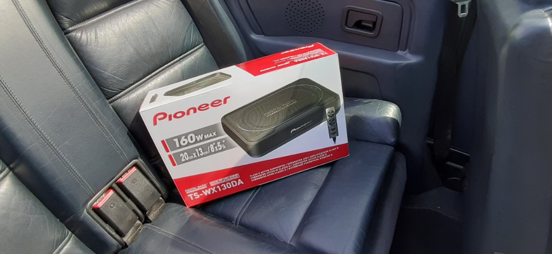

All right geezers,
This is the amp
Paul :-)

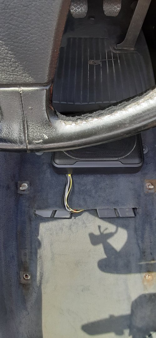

This shows a bit of the install, you dont need to fix it to the floor...it's heavy and sits on the carpet under the drivers seat...
Shows cables running under carpet....2 phono leads which tap into the rear speakers...they are unaffected by this and work as normal.
Earth cable goes to the rear handbrake bolt and the fused power line to the fag lighter.
Leave enough cable length to allow the unit to sit forward in the footwell so you can throw the seat back in then slide unit under the seat
I put the remote in the glove box and fed the cable through the tunnel and under the carprt.
Paul :-)
