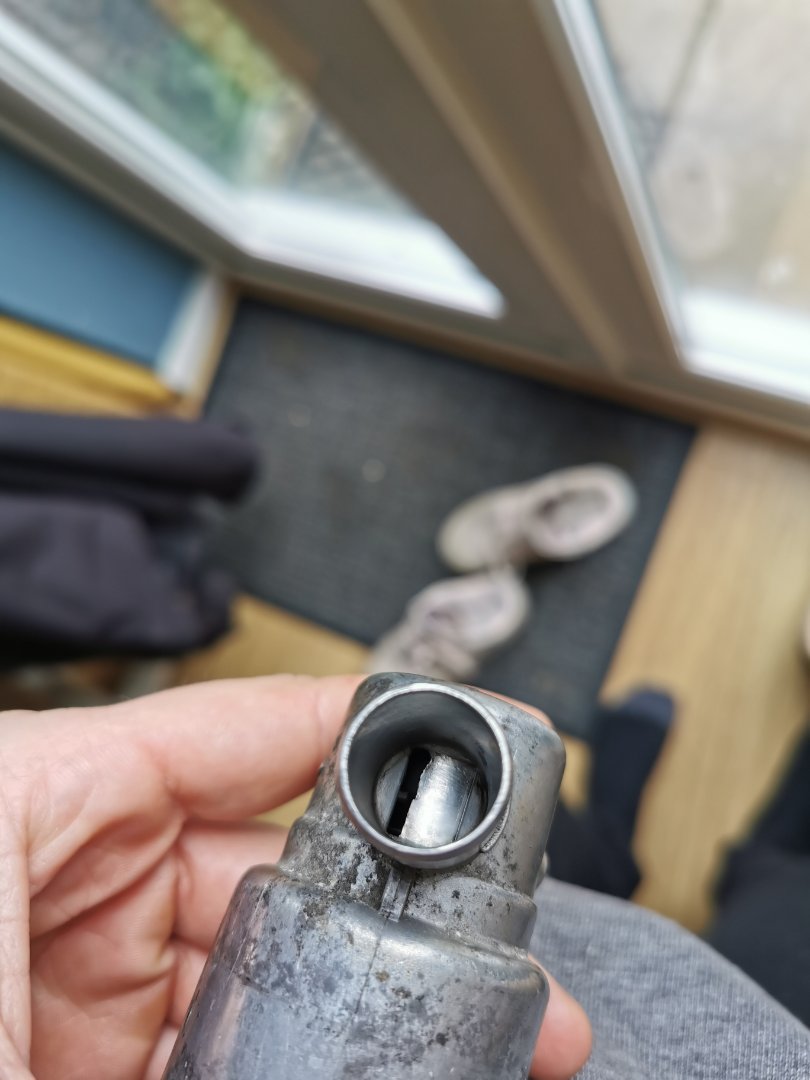

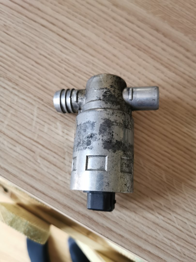

Can anyone tell me how the idle control valve should work, when should it be open and closed inside and how much should the window inside open as mine currently will only open a small amount, it's either fully closed or a quarter open which doesn't seem enough, will try to attach some photos of the ICV.

My M40 had idle issues also. I fixed all the vacuum leaks and still couldn't get it stable. I was trying to avoid replacing the Idle Control Valve because of the high cost. But, when I found a new one on amazon for $30, i just bought it.
Idle problems solved!

When I've problems with idle control valves in the past, I've just rinsed them out with brake and clutch cleaner and that's always done the trick for me!
They tend to get clogged up with carbon deposits etc and you'll be amazed at how much crap comes out of there with a good clean. Just get yourself a can and give it a try! Worth a shot for a few quid on a can of spray and it might just loosen up all the crud out of there and get your i.c.v working again!
Good luck and please let us know how you get on

Gonna give it a clean out today and see if that changes anything then try it on the car again, everything seems to be free inside and moving but there doesn't seem alot of movement on the slide window inside, can you remember if your window inside opened up more than my one in the picture? Cheers for the help.
