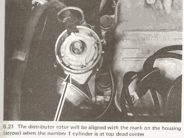

Hi mate, thanks for the pic, I seem to be 180 out 8O
(not down to me )
Did you say before that there is a "mark" on the body of the dissy where no1 should be
We could be getting somewhere now, if the "mark" is no 1 then we will go anti-clockwise (checked with one of my lads today ) in 1342 !!
That pic was Awesome mate !!!!

martauto wrote: ↑
Fri Jul 24, 2020 7:17 pm
Hi mate, thanks for the pic, I seem to be 180 out 8O (not down to me )
That pic may be from an E21 so treat it with a bit of caution
martauto wrote: ↑
The mark is at the end of the big arrow on the pic, just a notch in the edge of the dizzy
Get there in the end :thumb:
