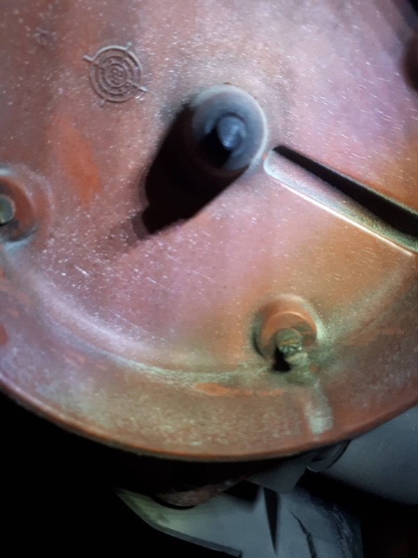

Post Tue Jul 07, 2020 8:30 am
Blurry photo but I think the problem, or at least one of the problems, is obvious?
