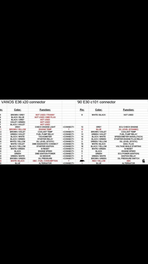

A PM I sent someone many years ago!
50 1/ blue/white (dynamic oil level) E30 2/green/yellow
M50 2/ blue/yellw (static oil level) E30 10/blue
M50 /3 red/white (ABS) E30 20/ red/yellow
M50 4/ black/blue (aircon) E30 not used
M50 5/ black/grey (aircon) E30 not used
M50 6/ purple/grey (aircon) E30 not used
M50 7/ black/purple (drive away) E30 not used
M50 8/ grey (engine check light) E30 12/ grey
M50 9/ NC
M50 10/ NC
M50 11/ brown/yellow (water temp) E30 not used
M50 12/ brown/purple (water temp) E30 4/ brown/purple
M50 13/ green/purple(fuel pump) E30 13/ green/purple
M50 14/ black/white (speed) E30 14/ black/white
M50 15/ black/green ( unloader relays) E30 15/ black/green
M50 16/ white/yellow (Rx data) E30 not used
M50 17/ white purple (Tx data) E30 not used
M50 18/ black/yellow (starter) E30 18/ black/yellow
M50 19/ white/green (service reset) E30 11/ white/green
M50 20/ black (engine speed) E30 9/ black
M50 21/ green (ignition) E30 7 green
M50 22/ green/white E30 6/ green/white
M50 23/ brown/grey (oil pressure) E30 5/ brown/green
M50 24/ white/black (fuel rate) E30 8/ white/black
M50 25/ blue (ignition warning) E30 1/ blue
Hope all this helps (and is not too late)!

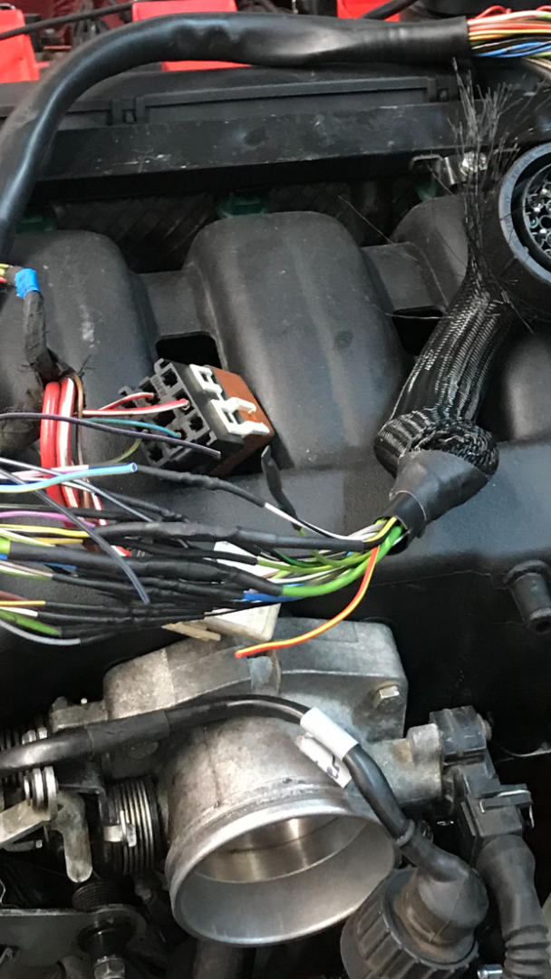

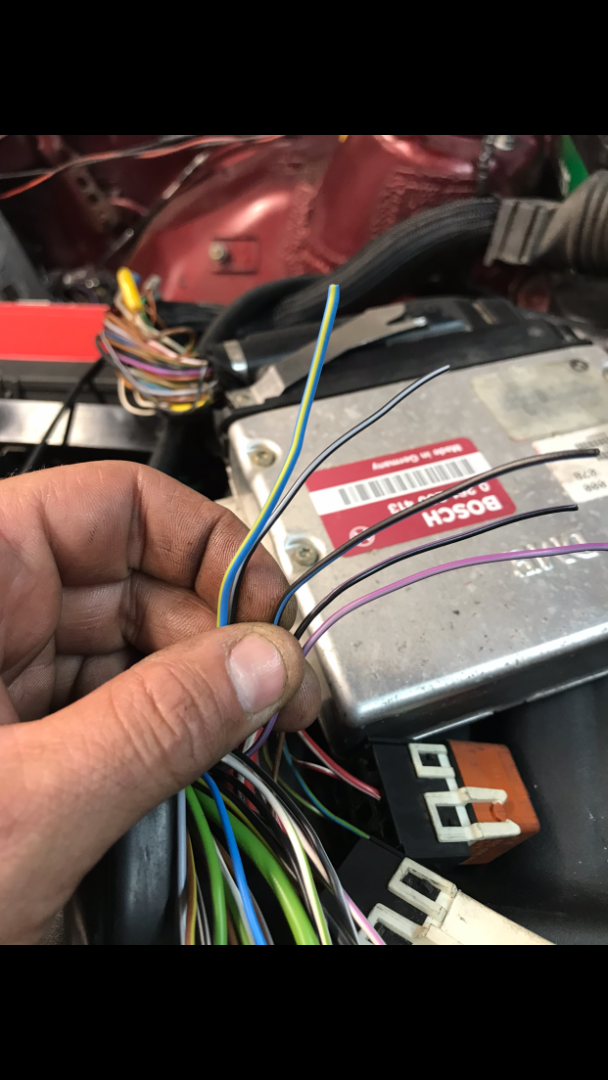

It appears that I have already wired these in but god knows where the other ends are as I’ve wired everything as per the below table and was only left with two wires from c101 side. One was a thin solid green that was in same terminal as the thick ecu green. And the other is red/yellow which I think is abs.
So I need to now trace these two wires from pins 2 & 10 and see where the other ends are hiding 😪🤦🏻‍♂️.
I knew I should of tested everything before I wrapped the loom 🙄🤦🏻‍♂️.
This is the table I followed and it was spot on as far as PIN numbers and colours for my engine 👌🏻
This is what I had left over from e30 side just the two mentioned
And these were what was left over from the m50 side which I’m not worried about as I think these are abs /ac wires.
So somewhere in my loom is the offending oil level sensor wires that I need
