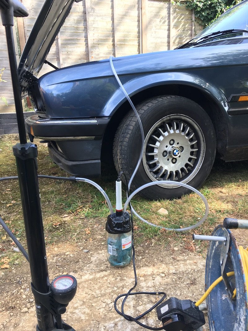

I thought I'd post a little video of the issue at hand in the hope that someone might be able to shed some light on it...
In the video you can see it's one of the moments where it has trouble starting straight away and when it actually starts you see the rev's rise up to about 3000, when the rev's then drop that is me changing gear out of 'park' and into 'drive' where it sits at about 1600 8O :mad:
This is from a cold start.When starting warm you don't get the surge to 3000 and it sits at about 1200 in Gear and slightly higher in Park. This indicates that the Air Slide Valve is doing what it's meant to do but the idle is still high.
I have this evening constructed a pretty crude but effective smoke machine and will be endeavouring on doing a smoke vacuum leak test tommorw... lets see what happens eh?!Wish me luck!

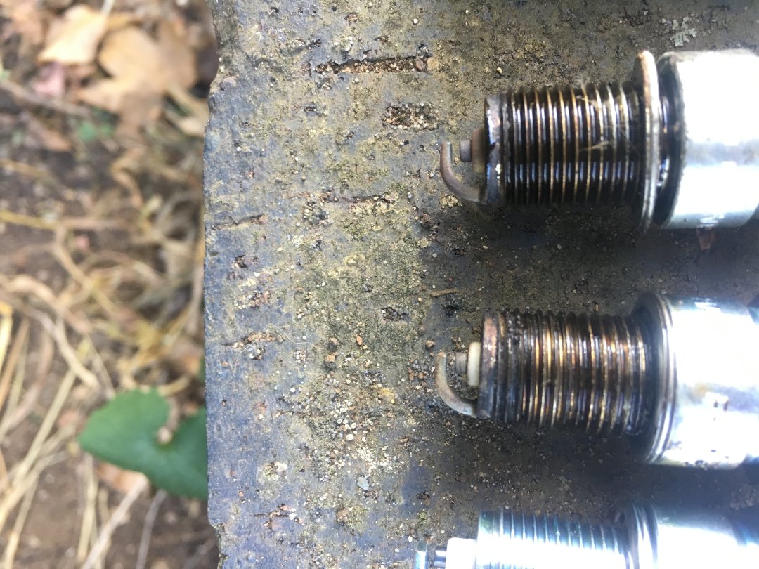

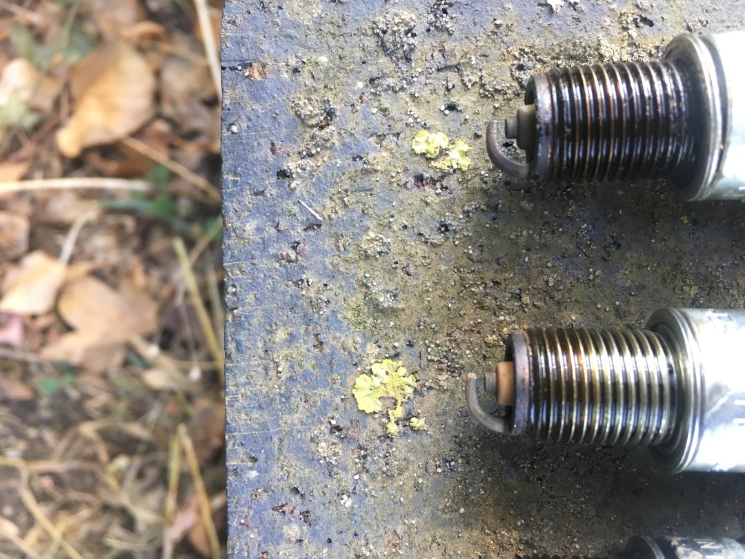

Also took the sparks plugs out to check for any tell-tale signs, but I can't really diagnose a lot from these and they look ok to me....but I'm certainly no expert:

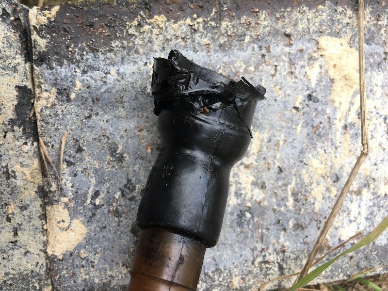

So I've spent the day getting my smoke on!.....I was expecting for it to be a case of 'find where it's not leaking' rather than 'find the leak' but as it turns out it seems that the whole vacuum system is kosher apart from a leak on the breather hose to the rocker cover:
Check the video:
The offending little piece of pipe.The underside which you couldc't see was completly wrecked and the previous owner had just tried to tape it up... :roll: :
Here's the crude smoke machine I banged together utilising a cheapo Screwfix Soldering Iron and and the biggest jar of olives I could find.A lot of olives were harmed in the making of this device.
The "smoker" connected to intake via a rubber glove:
