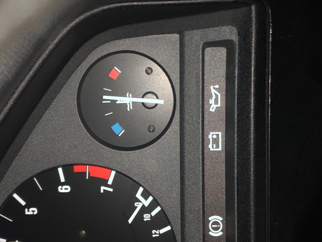

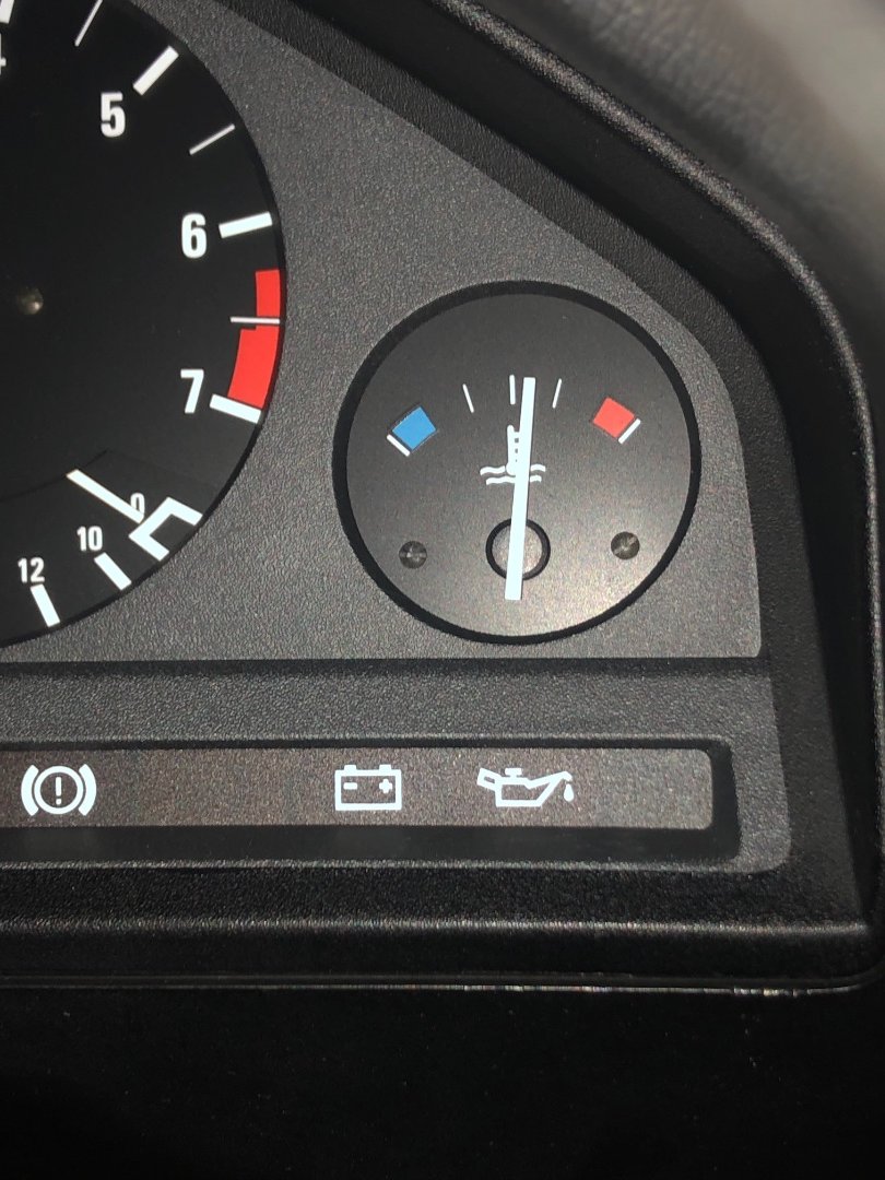

Guys I need your help again!
A few months ago, I noticed that the heater on my E30 (318i M40B18 engine) was not producing hot air constantly. So, I decided to clean the cooling system on a specialized workshop. Given the opportunity, the thermostat, the water pump and the fan clutch were replaced with new ones (a 88 C thermostat was chosen) and the coolant fluid was replaced with BMW (50% mix with distilled water).
So far so good, and the heater is working normally now, but I'm having a strange behavior on the temp gauge. At low speeds, and regardless the outside temp, it sits below the center line and at high speeds it sits just above the center line (see photo). Needless to say that before the aforementioned changes the needle was stuck in the center line no matter what.
Is this behavior normal or do I need to take some action?
Any feedback will be much appreciated. Thanks in advance

- Brianmoooore
- Posts: 49359
Don't forget that there's only a few degrees between the quarter white line and the three quarter white line, but the needle shouldn't move around like that, except when the engine is idling/traffic, when it gets up to just about where shown in the pic., before the viscous coupling locks up.
The thermostat keeps the engine temp. up to a certain point, so if it drops below that, it's the 'stat that's faulty. If it never drops below that point, but sometimes rises above it, then it's the radiator or water pump at fault. New doesn't necessarily mean good.
Make sure the system is bled properly before you do anything. Air in the system can make the gauge wobble a bit.
Finally, the crappy chinese-made Magneti Marelli thermostat was replaced with an OEM Wahler and the temperature needle is dead center again.
Thanks a lot @Brianmoooore
